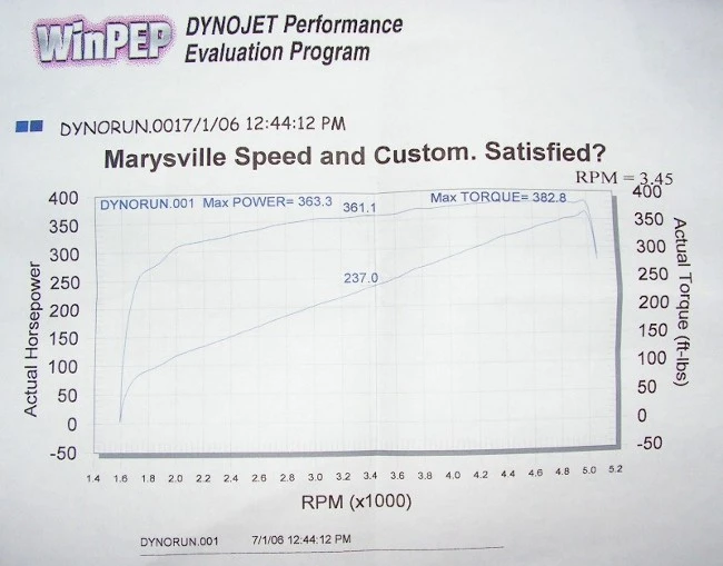

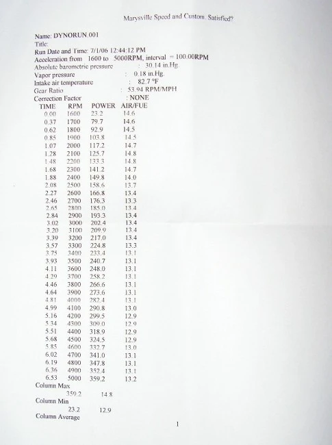

Well Here are the dyno results -Car is running lean on the JDM tune. Shop couldnt adjust the tune because for some reason JDM made it so we cant edit the tune as needed..so we decided not to run it harder than 5000 since we couldnt adjust a/f.
Hopefully JDM will enable the tune to be adjusted.
Here they are... I wasnt impressed.

WOW!! i would call JDM ASAP on monday!!! to spend that kind of money, and then to have less power than what is advertised for JUST the saleen blower, with no other mods is totally unacceptable.

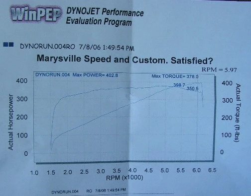

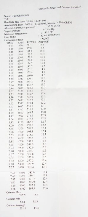

New numbers
402RWHP
378RWTQ
Still running lean down low rpms and as I climb to 6100, and Still short of the intended goal for this set up. Calling Jim at JDM in the morning..

AJC-05GT said:
Tune needs help
New numbers
402RWHP
378RWTQ
