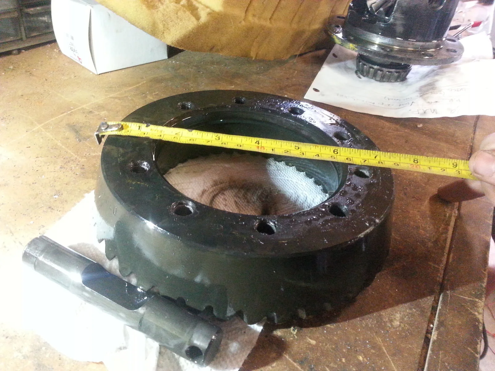

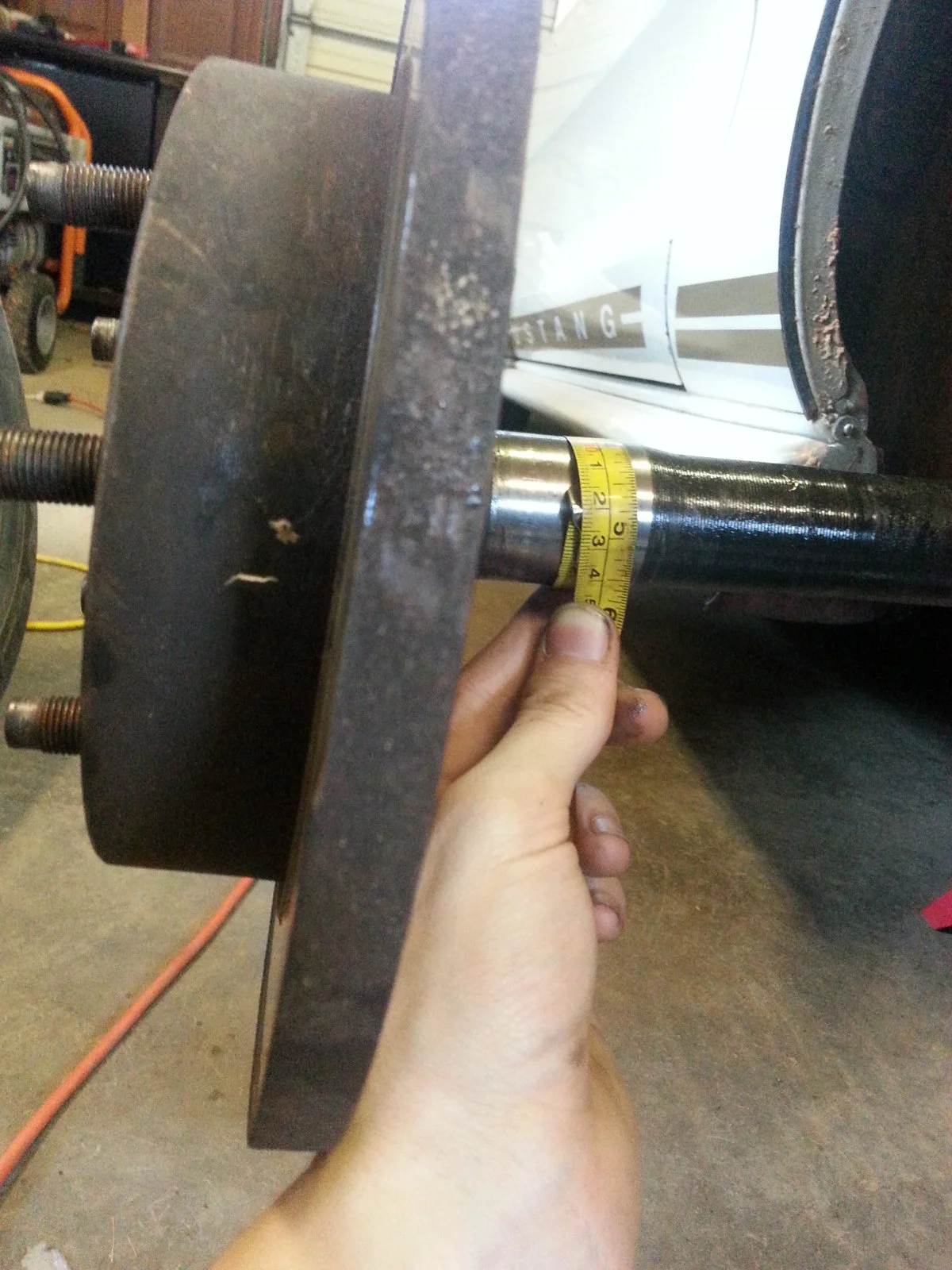

How thick are the 7.5inch axles? (No BS, i measure 5inches)
i'm pretty sure when people say 7.5" axle or 8.8" axle, they are actually referring to the ring gear diameter. The big cog that encircles the differential. Or am I about to learn something new? :nice:

When they say " 7.5 .. 8..8 ... 9inch" they do NOT mean the axle.
Seriously though? You think this ring gear will break that easy ? I don't know.
As discovered, the ring gear diameter is what is referred to when you hear 7.5", or 8.8. The larger the diameter, the less stress due to mechanical advantage with the larger diameter. You can still shear pinion/ring gear teeth.
Also, the axles on the 7.5" and 8.8 are the same. When people upgrade axles, they usually upgrade from 28 spline to 31 spline count axle shafts. the extra splines help distribute the load to reduce the change of the splines shearing off.
Axle materials also change for strength, but that area you are measuring won't change due to the bearings inside the axle that the shaft needs to slide into
