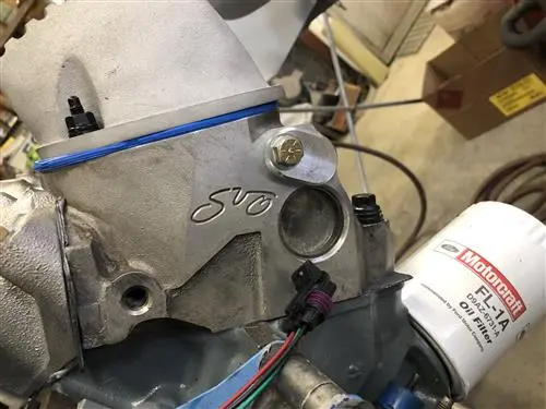

is there a kit that will block off the ports left open on the rear of the heads when i remove the smog crap?

As a note for future reference, not all heads are threaded for the 5/8" bolt or set screw. Mine (that were not threaded) were E7 heads off a 1993 Thunderbird 5.0. On these I used a plate to go over main hole and a 1/4" bolt to hold the plate on. THE threaded 1/4" hole is already existing.
A kit of(2) plates and(2) bolts can be bought for $15-19.00.
thanks for the info. i got some 5/8 by 1" bolts and after about 10 min of PB blaster and working the bolt in and out with an impact they are both all the way down to the head with teflon tape on them.

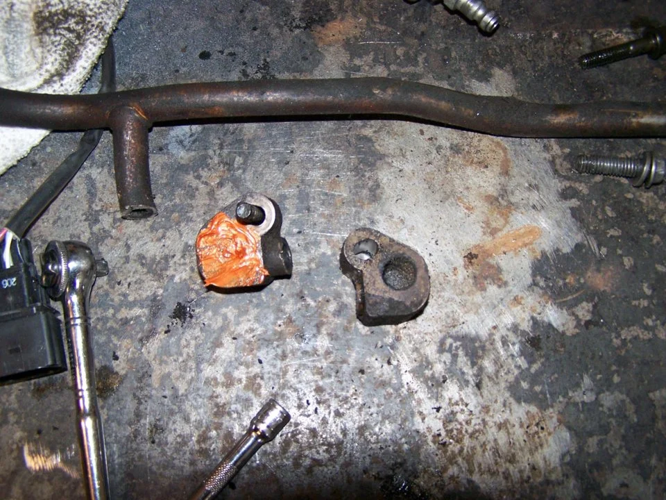

I've done this twice with success each time with the engine still in the car. LMR.com also sells a Pypes plug kit for the ports as well but you need to have the heads off or engine out of the car IMO to install them.i have heard of people cutting the small ports off the tubing and flipping them around and re-bolting them up (not sure how good of a seal this would make though) or you could use an old spark plug with the ceramic busted off
