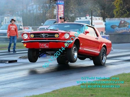

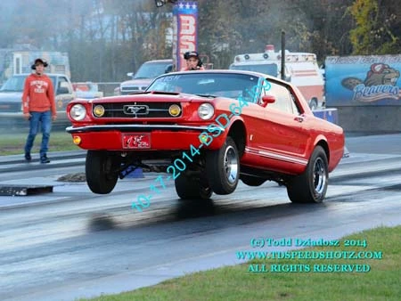

Here are a couple of photos from the end of last year:
I should add that I have found out how important front end travel is needed to transfer weight. The photos in the above post were using my old 65' Mustang front end which had more than 5" of suspension travel. Last winters engine clearance mod led me to install a 68' Mustang front suspension. The new suspension only offers 4" of front end travel due to some factory design issues which causes the ball joints to bind which prevents full travel. Due to this (given everything else remained the same) I have had some serious traction issues this year at my home track even on the new MT slicks.
After a long discussion with Opentracker, we believe that I can work around these issues by employing the Arning drop and then modifying the shock mount to allow for the added travel. Due to some additional bracing that I did when swapping the shock tower, this will require that I remove the motor to modify the area to let the drop happen. Also the 67-70 6 cylinder coil springs are both longer and stiffer than the shorter 65 6 banger springs which further complicates the front end movement.
