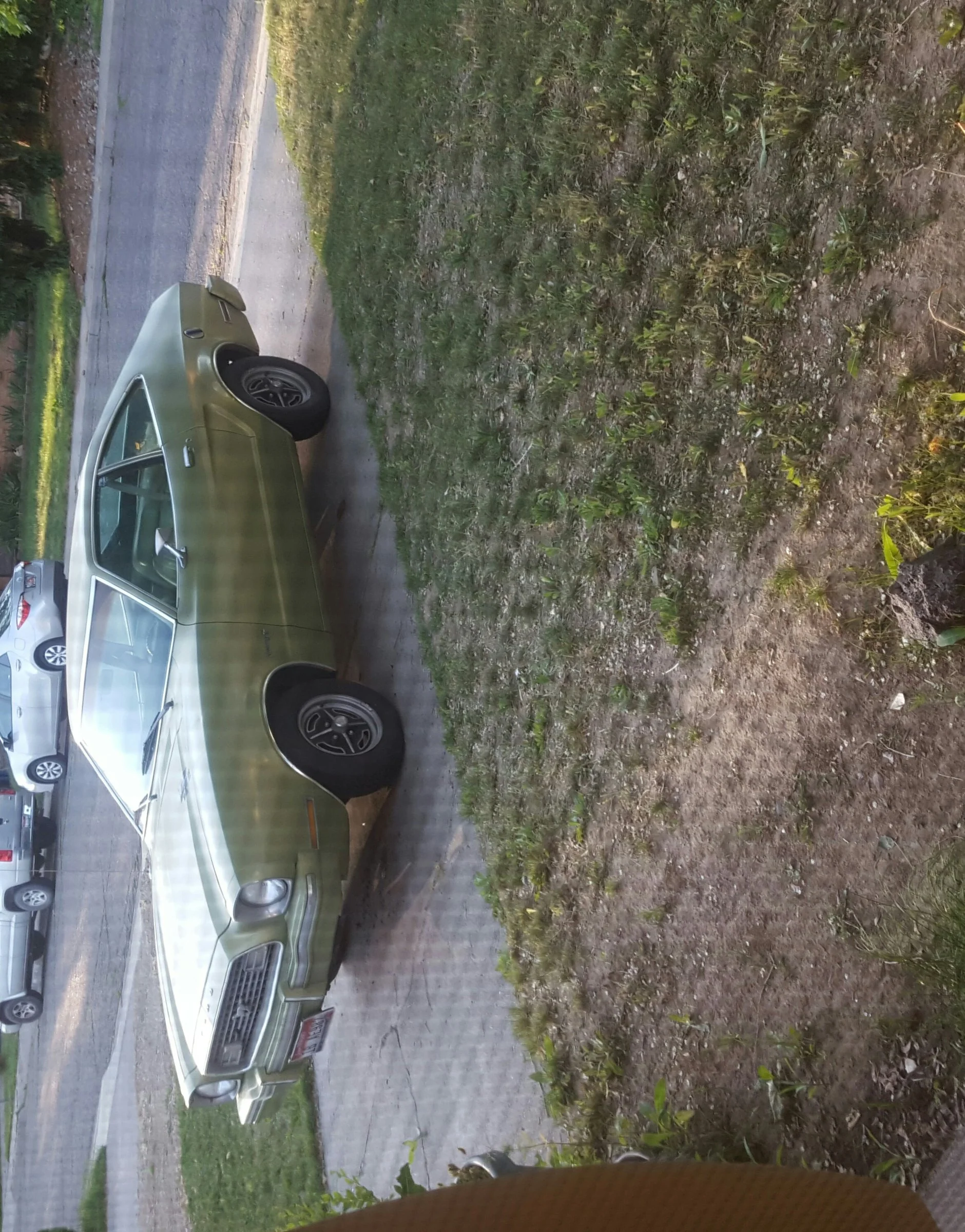

Hey so I recently picked up a gorgeous 2.8 l 1974 mustang 2 and absolutely love it! I have a laundry list of projects I've got lined up for this from bumper to bumper, but before I get started on those I want to get the most I can out of this engine so far I've gotten a new carburetor (2bbl) I believe and spark plugs in it. It starts up semi reliably now but doesn't have allot of get up and go any advice on how to get more power out of this or any advice in general would be greatly appreciated!
So far the only advice I've gotten is sell it and buy a nova and I'm not re ally feeling that

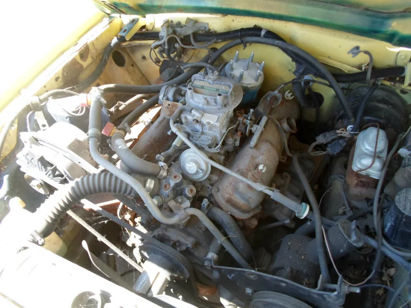

I love my II, but where do you start trying to make this pretty? Clean up the valve covers and paint 'em maybe. All the accessories look like a mess and there aren't really chrome dress-up parts I've seen. The heads are all kinds of ugly - a huge casting with the exhaust ports sticking out of them. And then all kinds of Nader-junk everywhere offending the eye. I think the best you can do is cover the whole thing with a huge chrome air-cleaner. :-)
