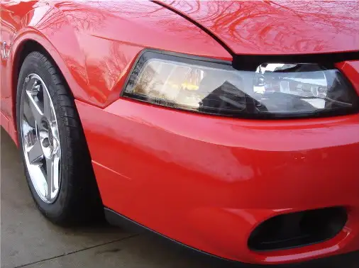

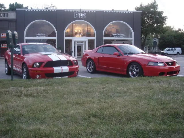

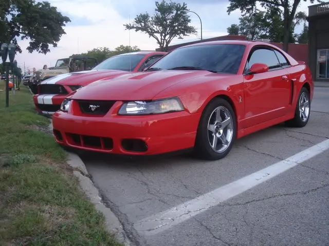

My 04 Cobra has cut stock springs. My shop is one of the best and they always cut 1/2 of a coil on Terminators. Fox bodies get 3/4 cut since they are lighter. My car rides very nice. I have no complaints.
