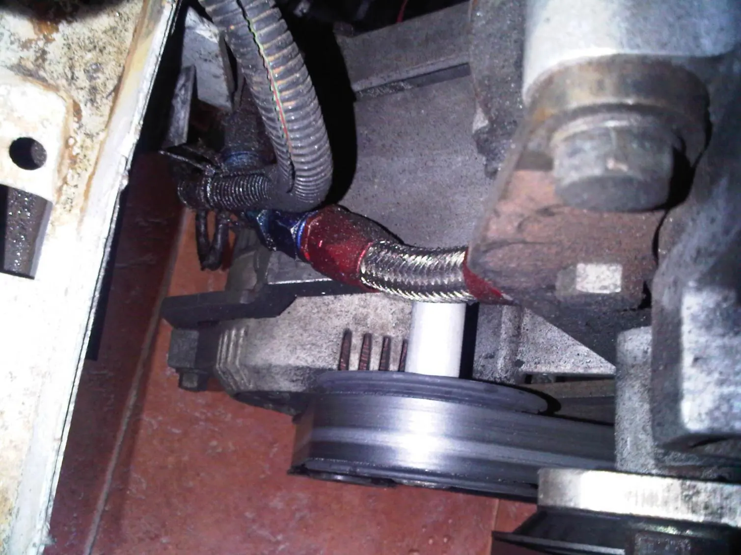

I know sounds very stupid but I bought a 91 LX 5.0 Supercharged that I am turning into a weekend drag car. I have never been very good with the electrical part. It does not seem to have any charging problems but I keep reading how good the 3G is and its a must have. How do I know if the previous owner already did this or if I have the stock 2G?
I am looking at the small case 3G, are they any good? Seems easier to install.
Thanks
Jay
2G has an external fan.
3G has an internal fan.
