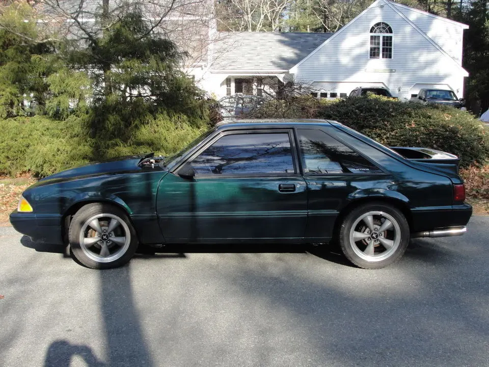

Coilovers with a bump steer kit, CC plates and stock GT springs with 1 coil cut in the rear is the buisness.
My exact setup is strange coil overs with 12'' 150 lb springs, upr billet CC plates, and comp engineering bumpsteer kit up front with stock GT springs with one coil cut from them and rolled and smoothed fender lips
It's not dangerous when set up right. I dont know how much lower than a stock car it is, but i would put money on it that its more than 1.5 inches. Ive been over 120mph on this setup with no stability issues.
your coupe looks sick !
sorry to bring back this thread. Im running sportlines springs, removed the bottom iso, and also have steeda x2 ball joints which lowered it another 1/4 inch mine sits kinda low.
