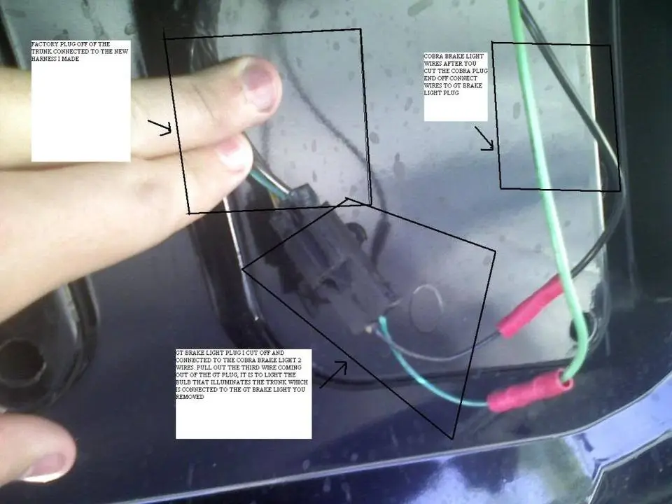

step 1: cut off the gt brake light plug end leaving room to reuse the plug end, toss brake light in trash
step 2: cut off the cobra brake light plug end and toss in trash.
step 3: using wire connectors match the black wires up with the wire coming from the cobra brake light to the gt plug end you cut off in step 1.
step 4: using wire connectors match the green wires up with the wire coming from the cobra brake light to the gt plug end you cut off in step 2.
step 5: cut off or cap remaining wire on gt plug end, it is used to power the bulb that lights up the trunk which is removed with the gt brake light
step 6: plug the two connectors together and test brake light
here is a picture of the finished product, i do not have a step by step as i did this about 6 months ago and there seem to be alot of questions on it so im posting this to try and help some people save some money.
enjoy your new FREE functioning spoiler and brake light
