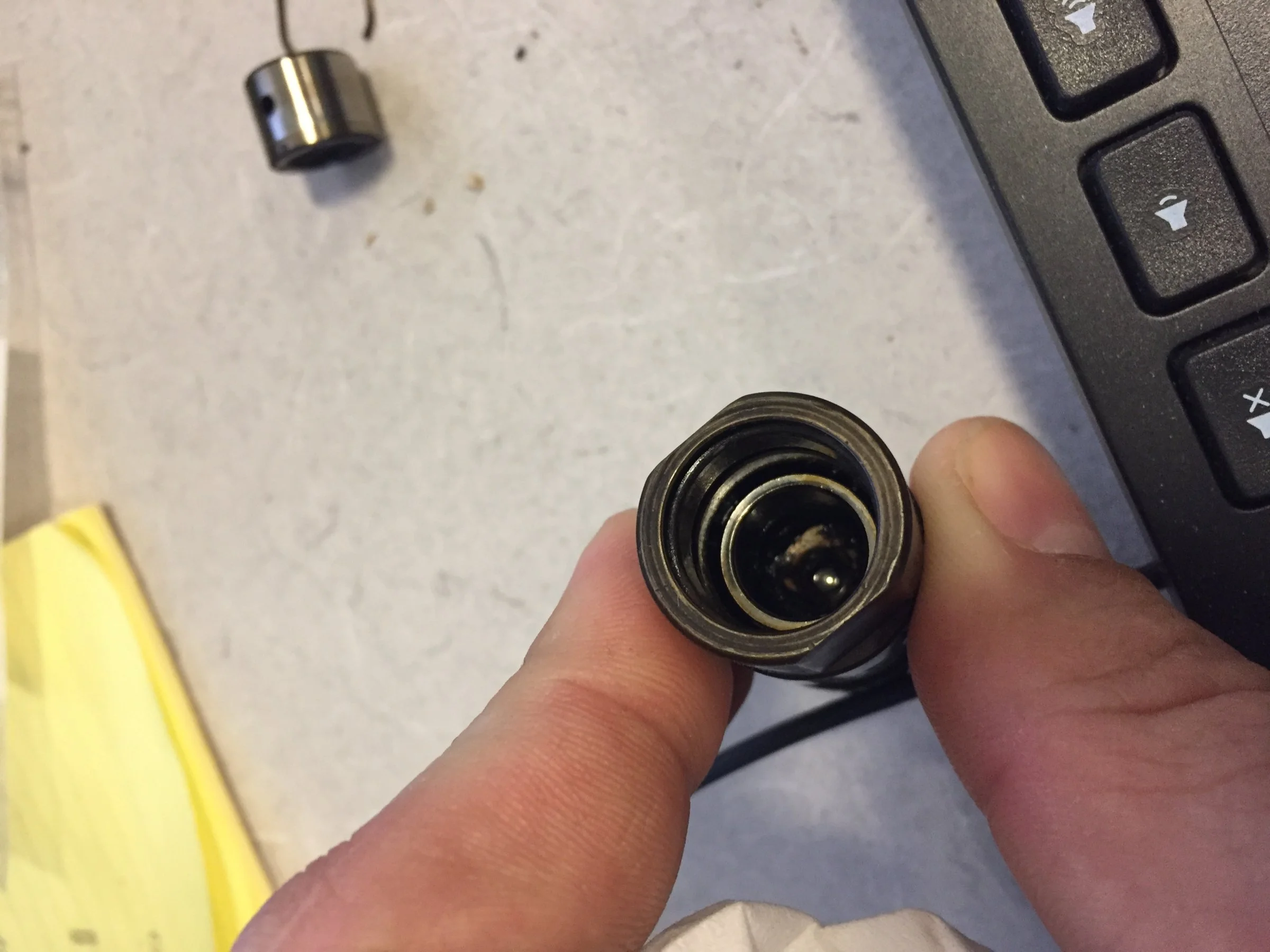

So...trying to convert a spare explorer lifter I have to a solid.
Clip out, rear section that contacts the pushrod out. I see the plunger inside. I can depress it slightly, but cannot remove it at all. Is there a trick to this? I've tried to take 2 apart so far and can't get the plunder out of either

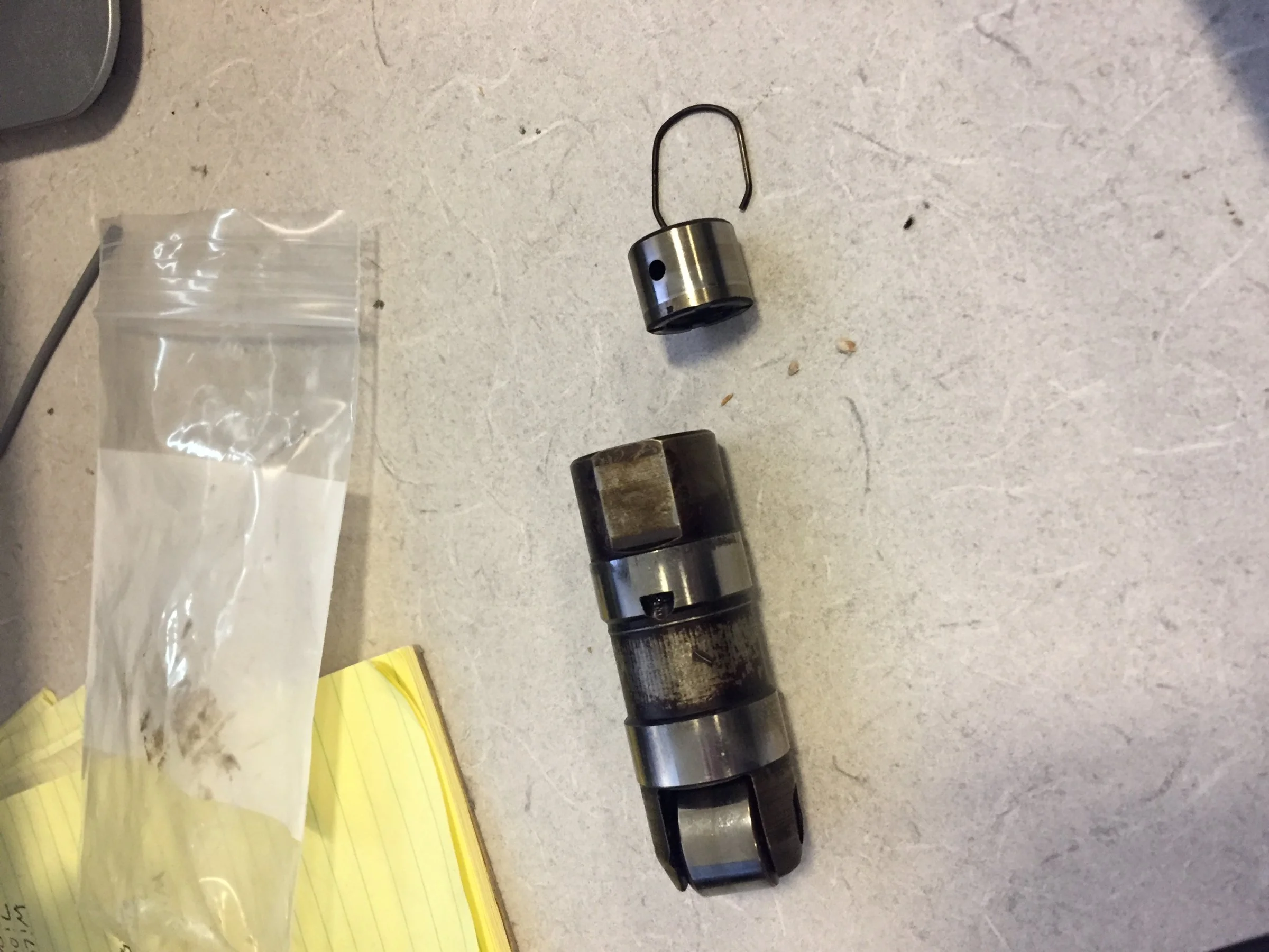

Got this out.
Can't get this plunger out, although I can depress it a tad. Seems locked in
I have some from a mustang, but assume they are the same. Those are in better shape so trying to make one from these ratty explorer lifters

They are a pain to get out sometimes, compressed air in the oil feed hole can work. Or turn it up side down, and bang it on a piece of wood.
