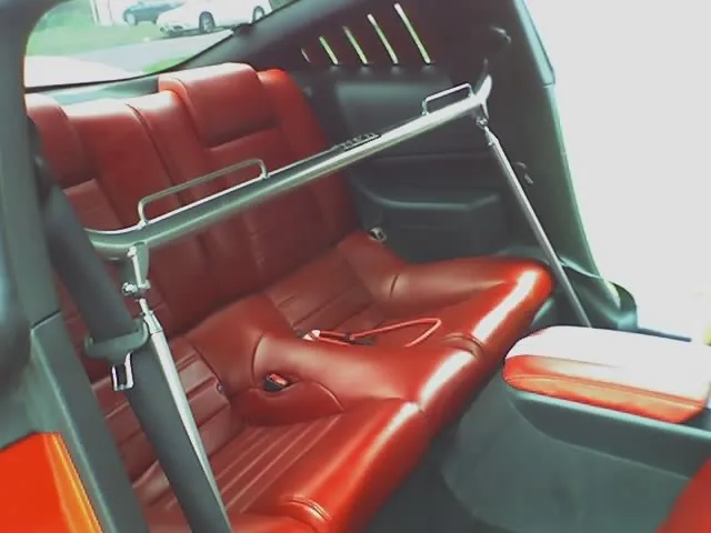

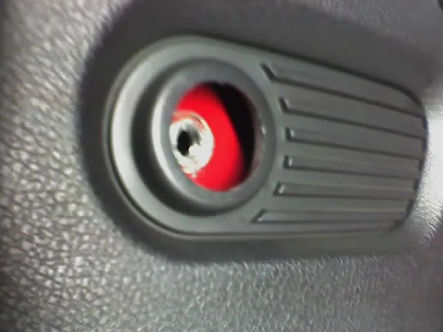

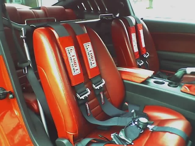

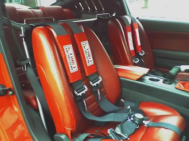

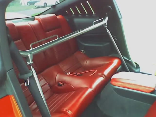

I've gotten a bunch of PM's about the harnesses. Yes, they work! It's hard to describe the difference between driving a car with normal belts and driving a car when you're "locked in" with racing belts. Think of it as being kind of like getting laid with condoms for years and then getting your first Au naturale. Hard to describe but no doubt better! The harnesses are not going to be a simple bolt in mod though. The Sparco bar makes the shoulder belts pretty easy but the hardware package is totally crap. I reused the stock hardware for awhile and later went to my local hardware store for some longer bolts to use. I suggested 6point harnesses instead of the 5 point ones that I used because there was no good place to drill thru the floor to mount an eye bolt. If you used a six point harness then the crotch straps could be mounted to the front seat mounting bolts with slightly longer bolts and a small spacer. It would be a lot easier than what I did. I ended up having a friend of mine fab up a 1" steel bar that mounts to the seat mounts for the crotch strap. It works great but that kind of fabrication is beyond me and, I suspect, lots of other people. Either way, mounting the harnesses is going to be a pain; but it's worth it. These are the only two pics I have of my harness bar. I'll get some more when I have a chance so anyone who's interested can see how I did it.
Note: In the second pic I've got the headrests off because they were in the way when I was wrapping the belts around the bar but I use the stock seats with the headrests in place. It's not perfect but it fits my fat ass. :shrug:

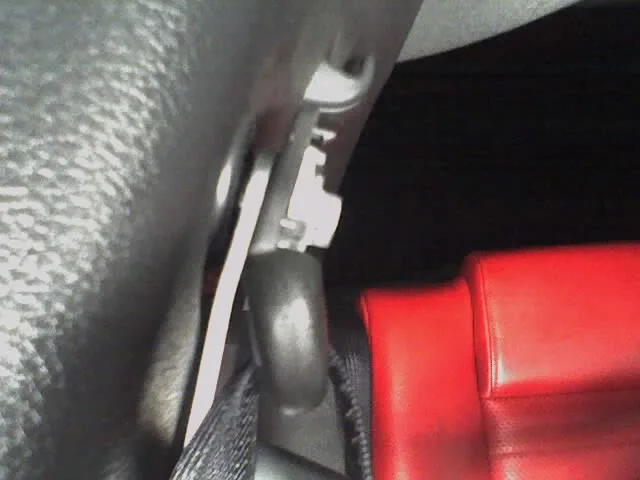

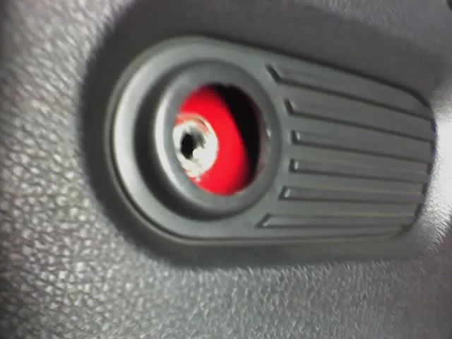

Wow! Thank you for posting the pics. That really helps me get an idea of how well the Sparco bar fits. If possible, could you give us a couple pics of the mounting locations? I'd like to see where everything bolts in. Thanks again.
Sorry for the crap pics but I was in a hurry, it was at night, and all I had was my camera phone. I'll get better pics next time I put the bar in for a track day but these should give you an idea anyway. Here's the crotch strap bar my friend fabbed up.

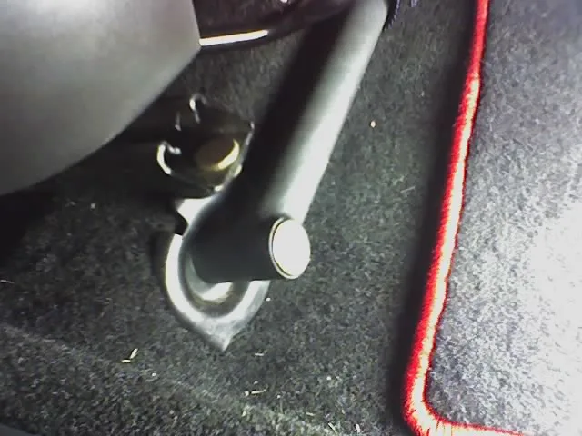

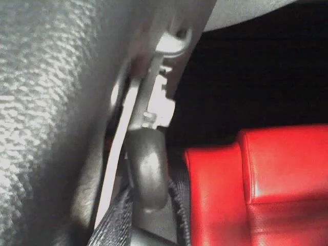

Here's the upper (shoulder) mount with the stock seat belt removed. You can see why spacers are needed.

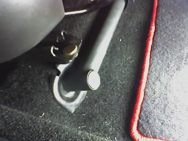

Here's an end view of the bar with the stock seat belt reinstalled. You can see why I wanted a longer than stock bolt.
I know the pics are F- but I hope this gives you an idea of how it all works.
