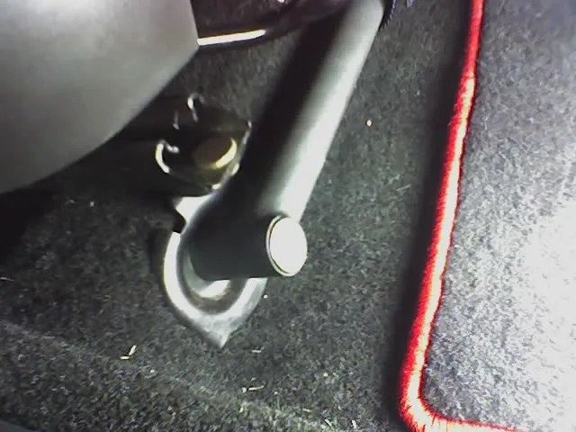

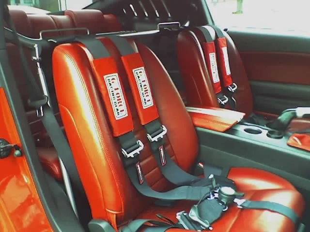

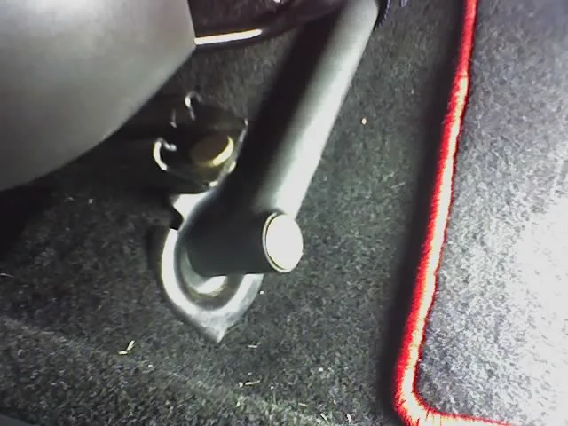

Sorry for the crap pics but I was in a hurry, it was at night, and all I had was my camera phone. I'll get better pics next time I put the bar in for a track day but these should give you an idea anyway. Here's the crotch strap bar my friend fabbed up.
Brilliant! looks good, good idea.
Edit:so that's in the front? I just realized that looking at the seat picture. :) makes sense with stock seats. Ideally that strap goes down through the middle of the seat, but that just isn't feasable with stock seats.

I most definitely agree with you. You said what I was thinking but couldn't articulate re: getting out of the way of a collapsing roof in a worst-case-scenario event.
Agreed: if it's faster times you want and a more stable 'driving position', the harnesses do help. There are different opinions on this, some of them very strong. My racecar [obviously] has all the NASA CMC spec gear, but my 94 GT has stock safety stuff for the time being. I think I'll go with a bolt-in roll bar, seats and harnesses eventually... I digress...

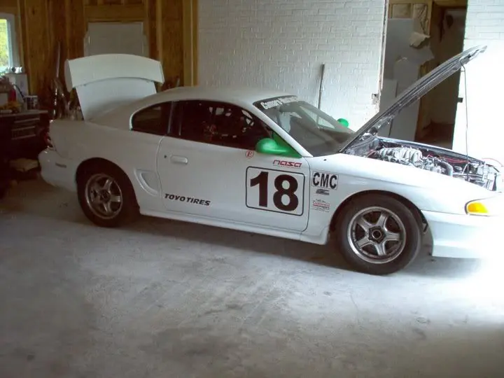

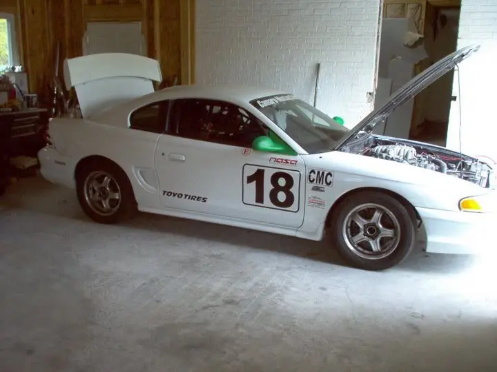

Haha....Well at the moment I'm a 'poser'. I have purchased a 1995 Mustang GTS racecar that is a Camaro Mustang Challenge car. I haven't even driven it yet, nor do I have my comp license. I'm not in a hurry to get it, but I will probably attempt to have it by next spring, depending on this season.

Well, as for the CMC car, I've seen NUMEROUS of these cars for sale in the $7-10k range READY TO RACE in the last 3 months. I won't say what I paid for mine [it's in that range] but Steve Poe gave me a fabulously awesomely smokin deal!!! These cars can easily cost 15-20 grand to BUILD if you're not savvy with the dollars, but USED they go down in price depending on the market.
DAILY/TRACK CAR
RACE CAR

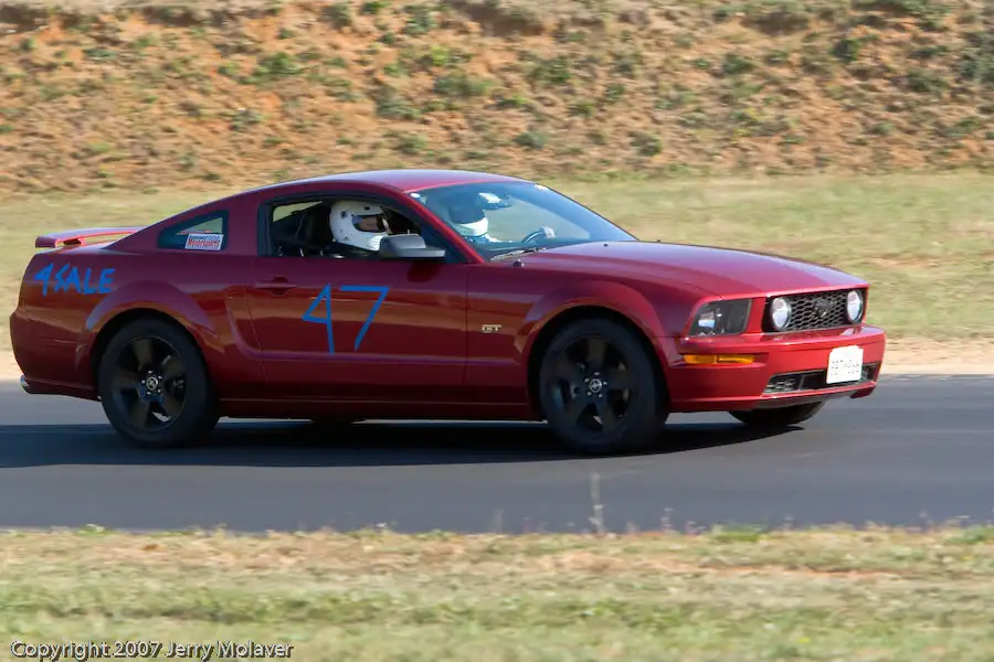

[for those of you that know Summit Point, this is going into turn one...I'm WAY OFF line now that I look at the picture and realize what I was doing...Oops.]
