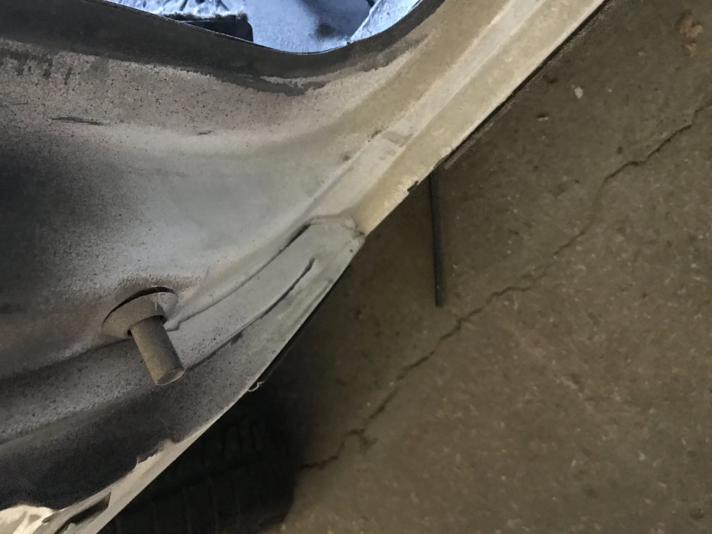

I got to the back but can't figure it out.

If you are talking about the plunger in the door jam area, the ring kinda pops off and you twist the plunger 1/4 turn (90°?) Then push it in
You have to take the upper and lower back seat out and the side panel off.
The cable system is connected to belt tensioner.
