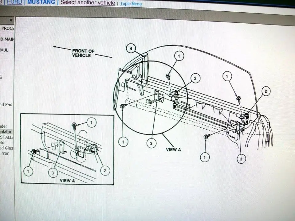

Door and wiring is all apart. Regulator/motor is out. Sliding and rails mechanism+gear thing are unbolted but still attached to glass and I can't figure out how to dislocate the window glass from the slides its on, cuz there's a stopper.

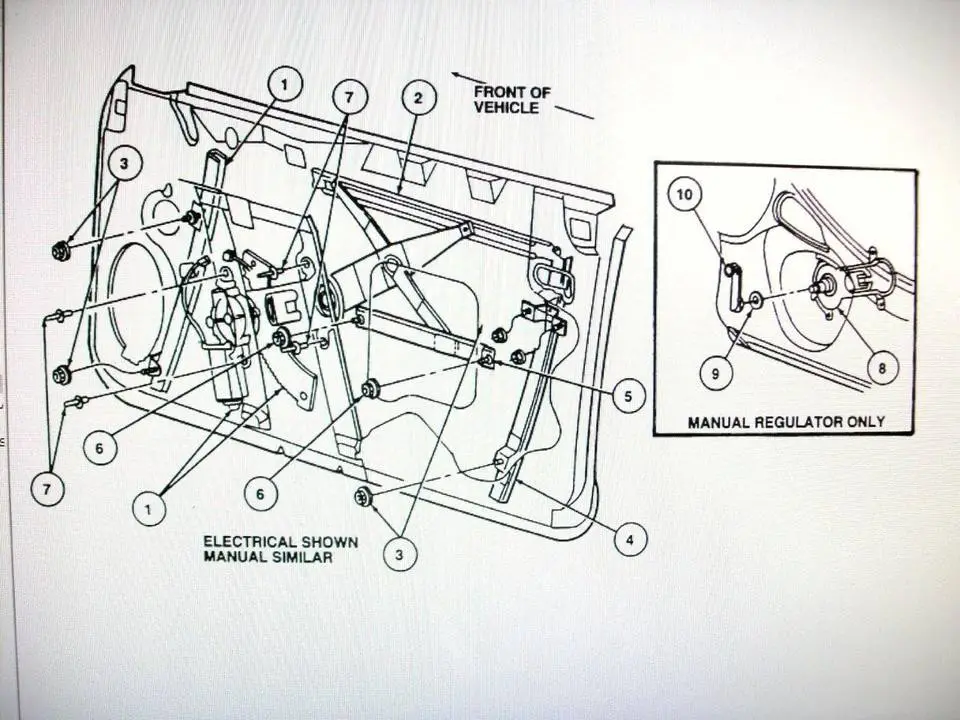

Also when i unbolted the gear drive part it shot back cuz its spring loaded, is there a trick to reinstall that part?

I could not find any diagrams for the driver side door, however, I did find 3 diagrams for the passenger side door. These diagrams are for a 98 GT Mustang, so it should be of some help. The removal and installation instructions are posted below the diagrams. Click on the bar above each diagram to make them larger. Good luck, Tommy.

Caution: If the regulator counterbalance spring must be removed or replaced for any reason, ensure that the regulator arms are in a fixed position prior to removal, to prevent possible injury during C-spring unwinding.

the black round peice is a at the back of the rail is a rivet, youll need to drill it out and dislocate the rail from the tab on the glass (leaving the tab on the glass). im an autoglass tech for over 14yrs now so trust me it sucks. youll need to get replacement rivots and the really big rivot gun to install them. the older CVs went through the glass and plastic isolator. when that thing pops it scares the hell out of ya, it makes you think the glass broke. but good luck.
also the parts store will have them, napa or carquest is the best place for the rivots. a body shop will usually have the rivot gun. as they are quite expensive, maybe one will be polite enough for you to use.
