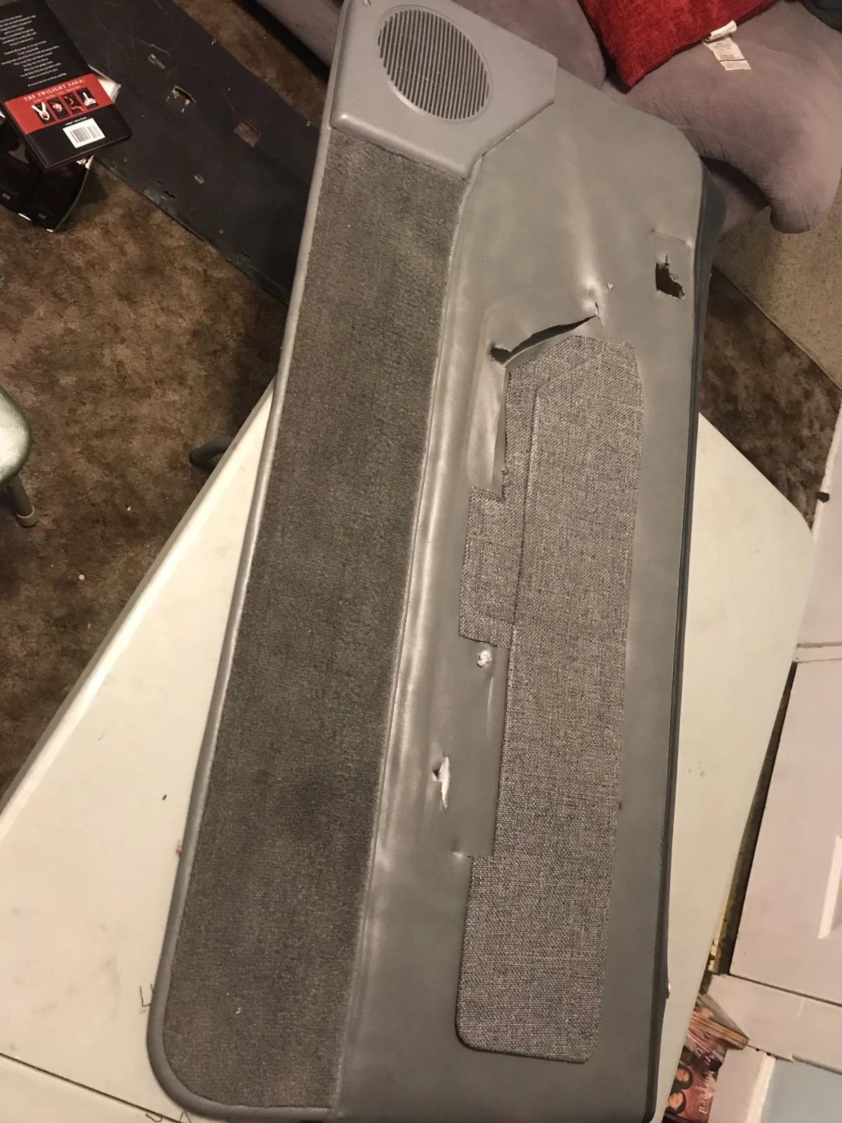

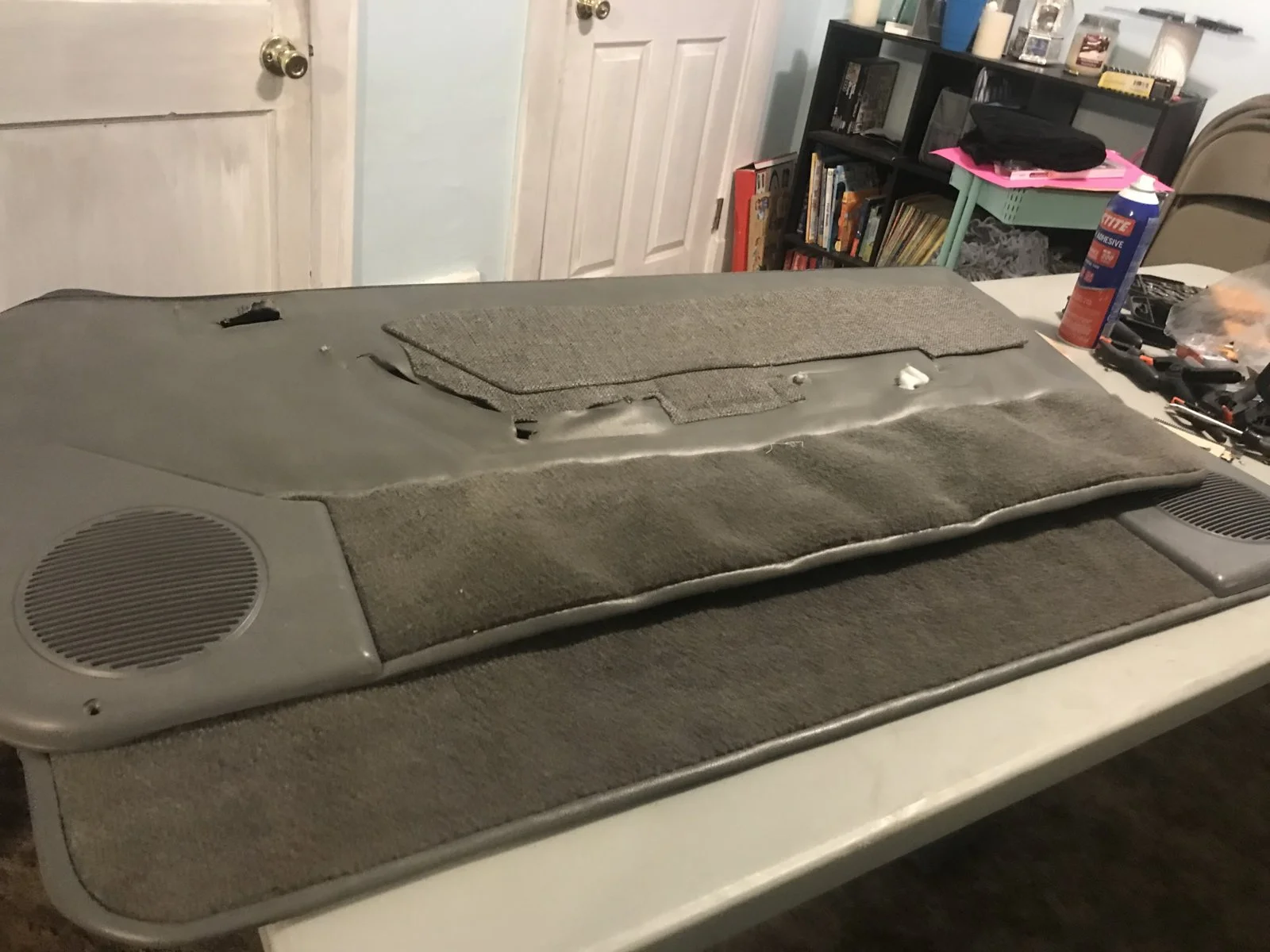

If you are like me and the board is warped and carpet has detached , this is a easy but time consuming fix.
Tools needed.
A pry tool to remove screws
Drill and 1/8 drill bit

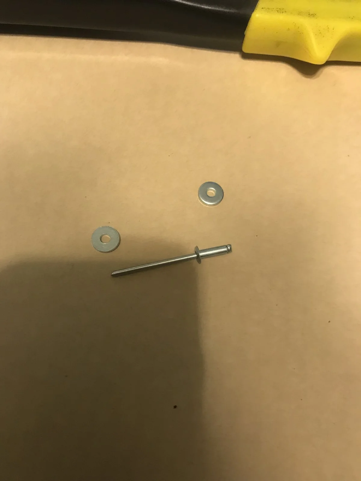

1/8x1/4 rivets with washers
Spray adhesive
Hemostats
Staple gun with 1/4 or smaller staples

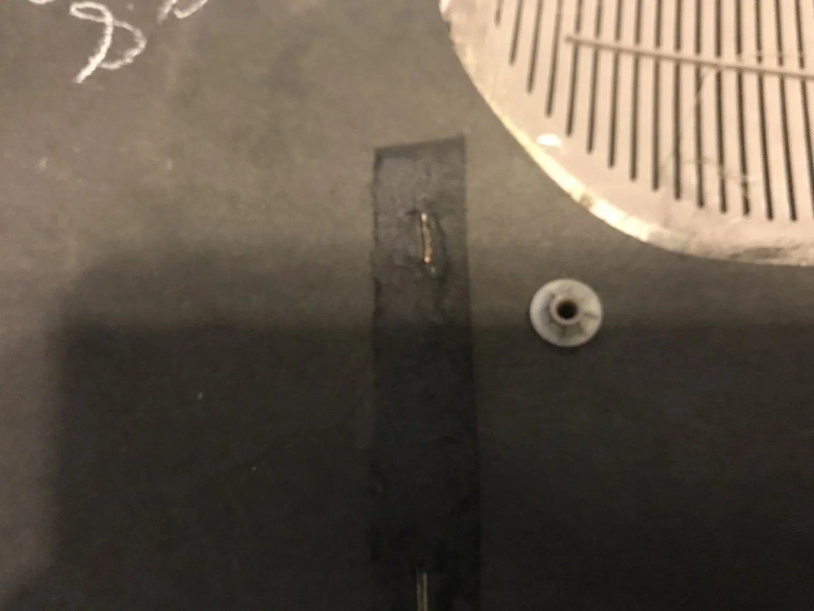

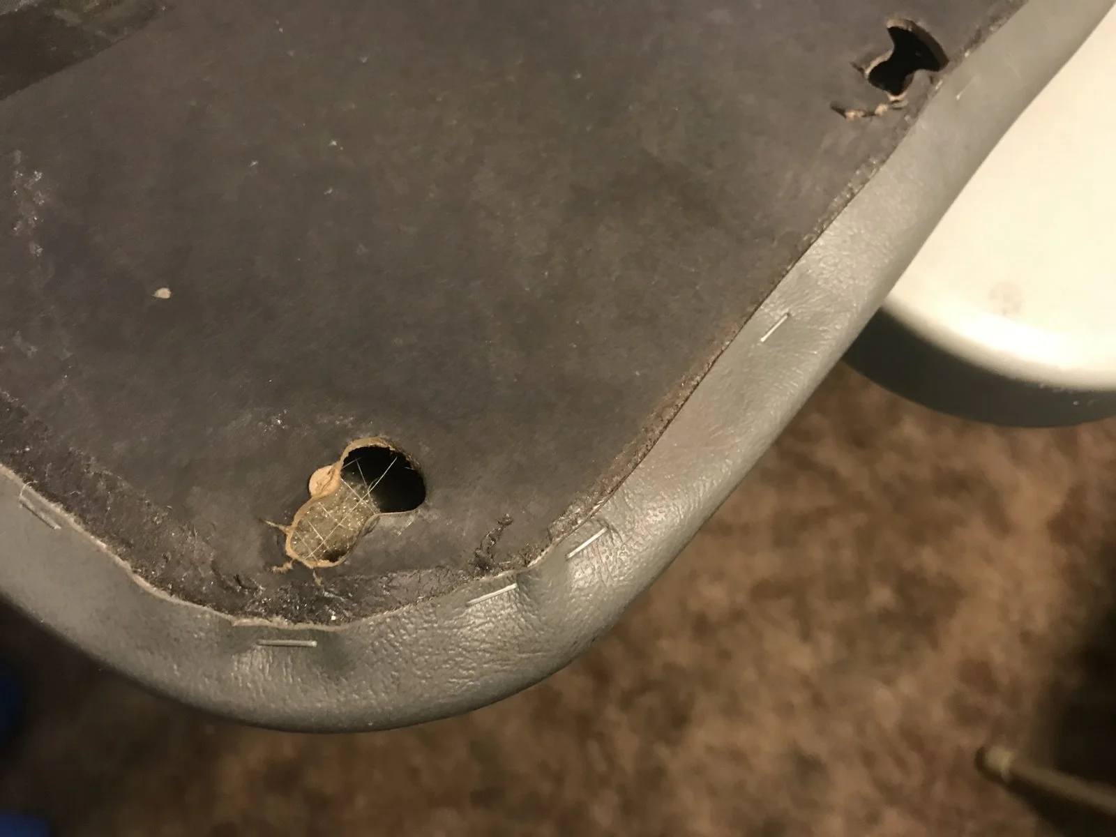

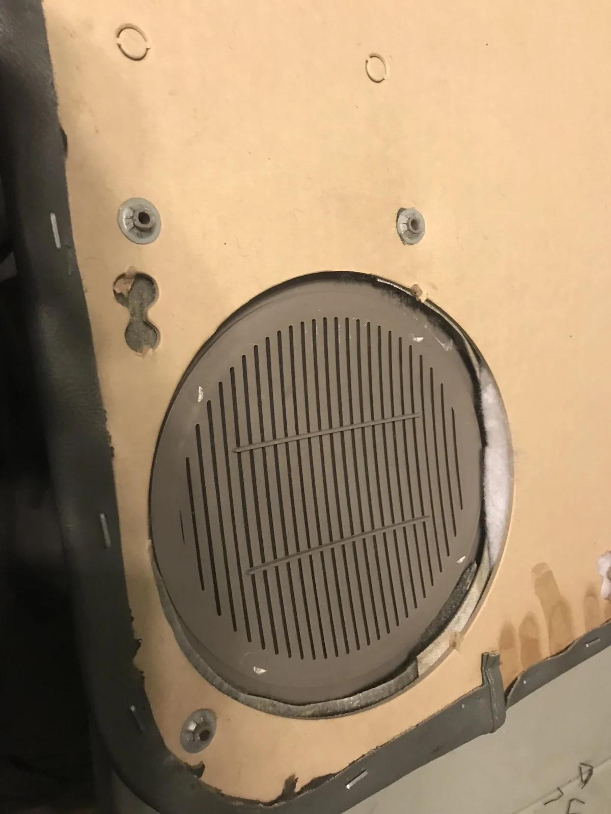

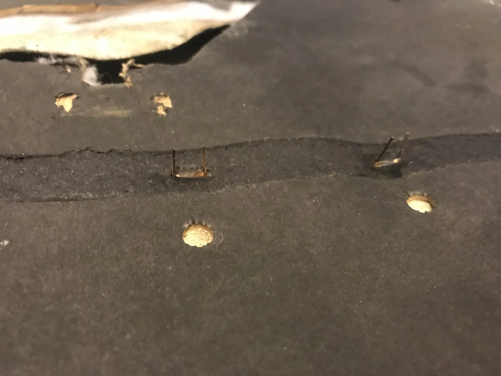

Start by removing all of the lower staples. I removed them up to one past the board, including the ones holding the insert. In the center is some tape covering several long staples. Also remove the nuts holding the speaker cover on, be careful not to snap the tabs.

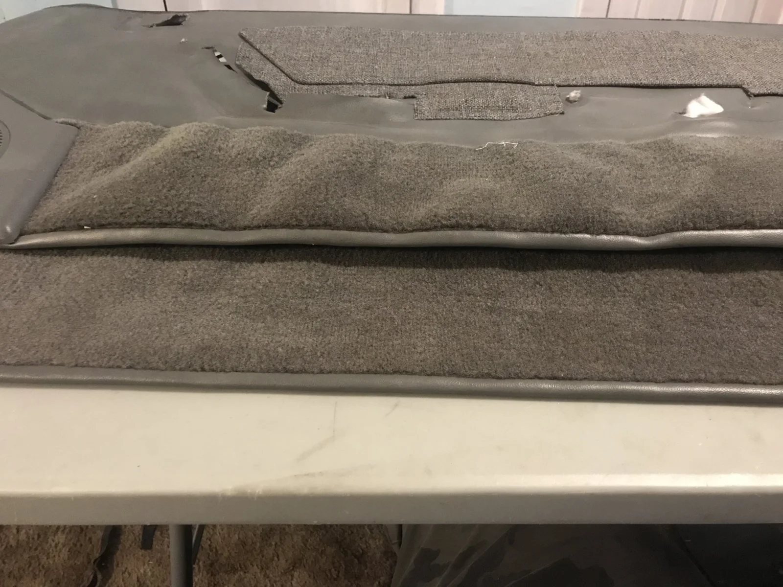

Then you can carefully peel up the edges. Go slow, you likely missed at least one staple.

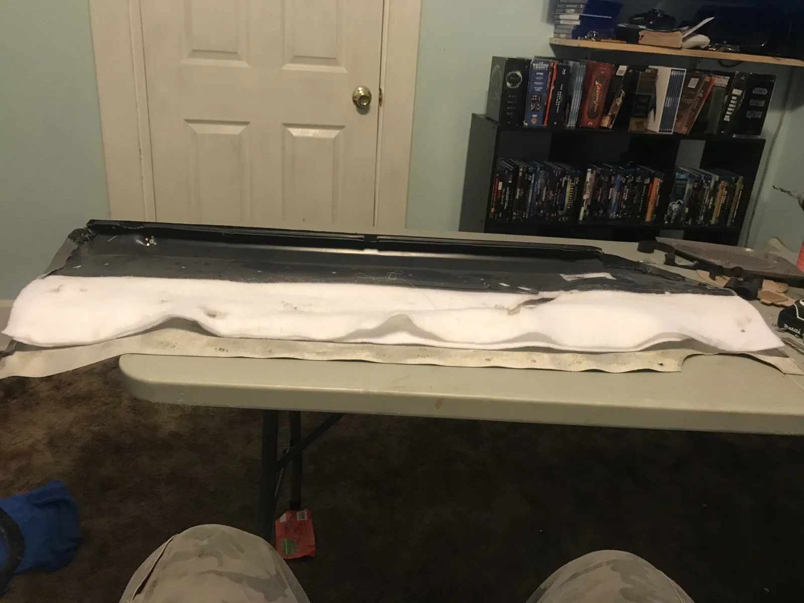

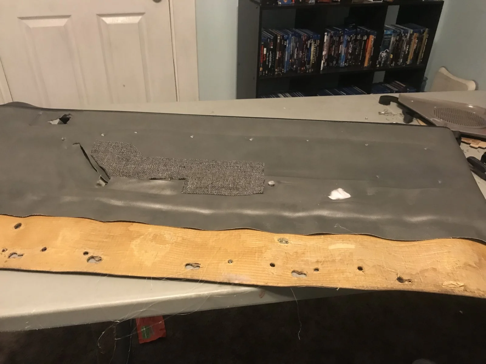

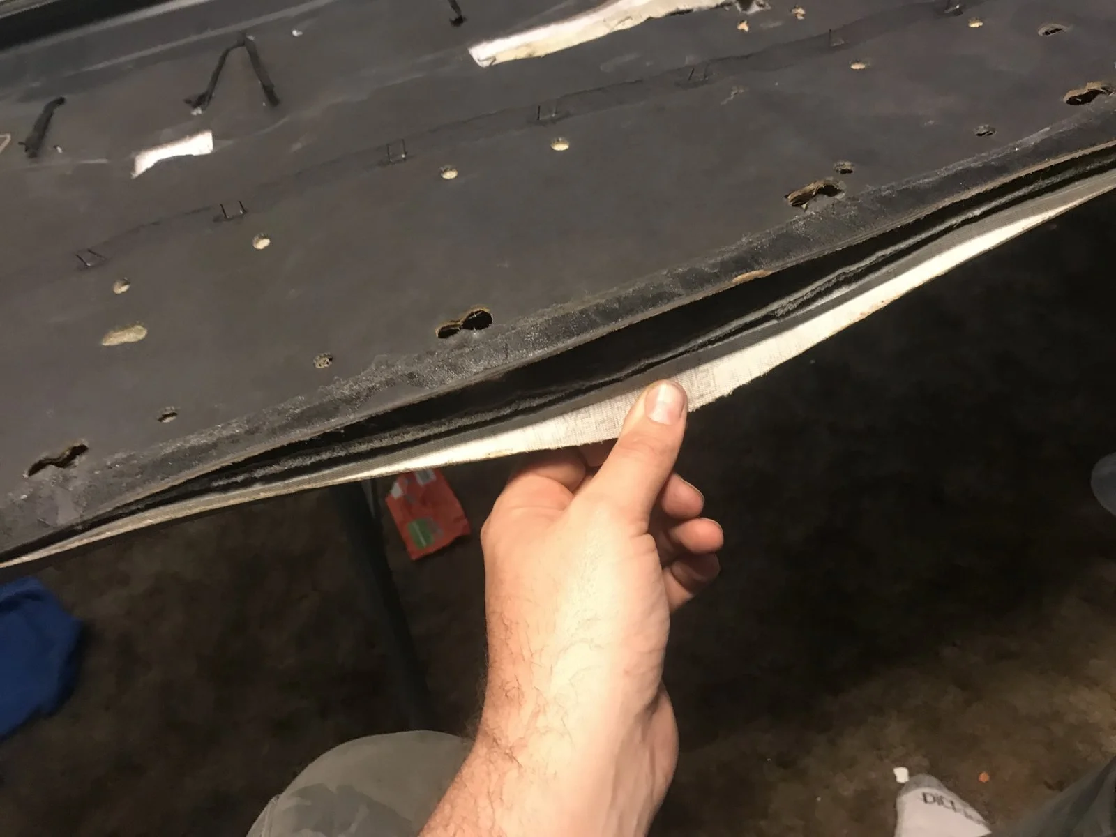

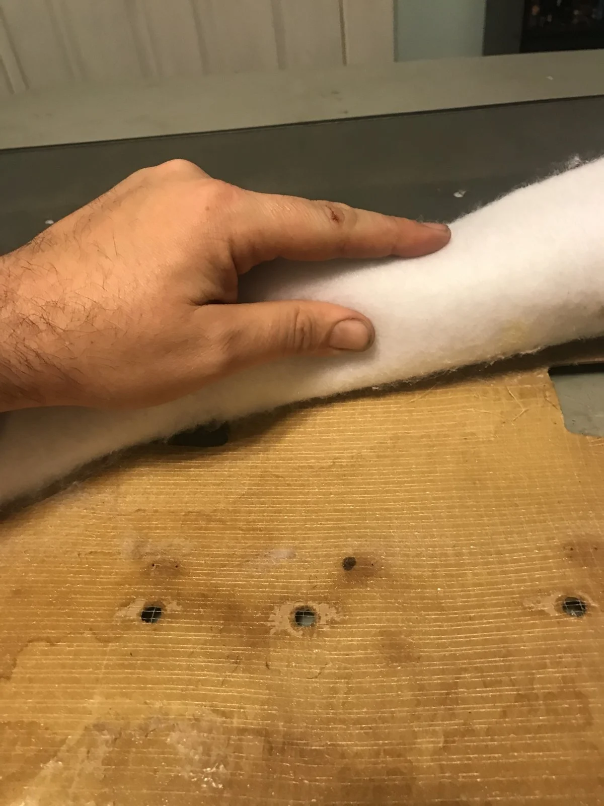

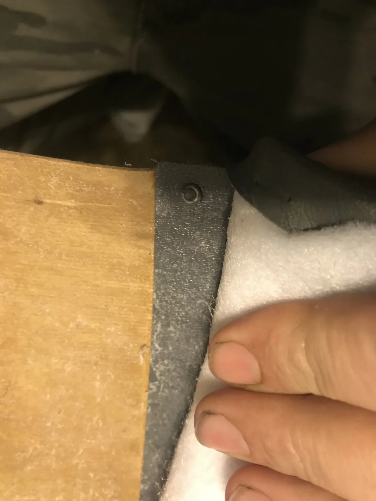

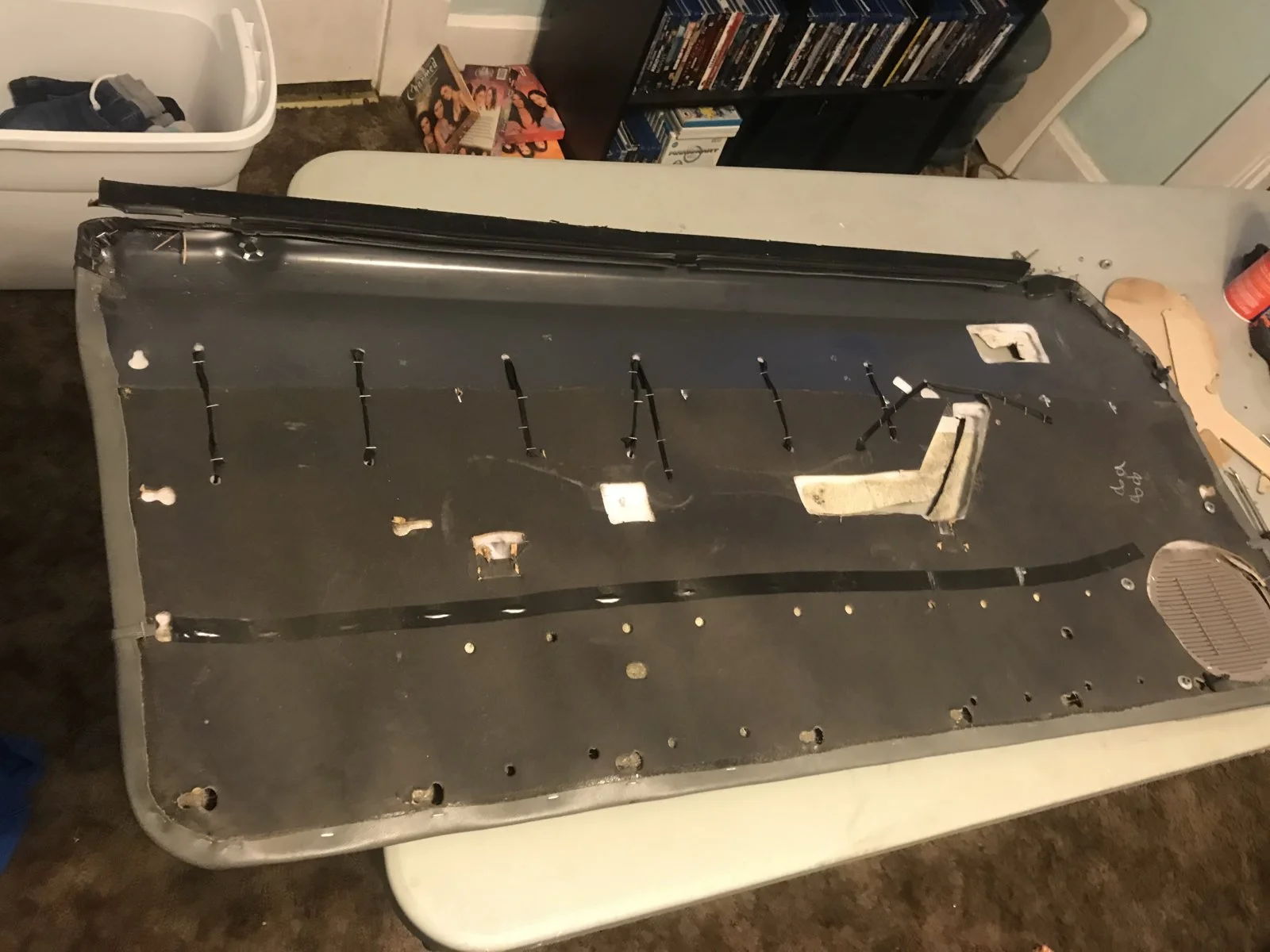

Then flip it over and slowly start separating the panel from the board. You can separate the lower section I’d you wish by removing the staple, or you can fold them over to keep it connected .
You should remove the insert st this time as well. Your goal is to get to where the board and upper panel connect.
A factory panel with have metal tabs that pressed through, mine had rivets.

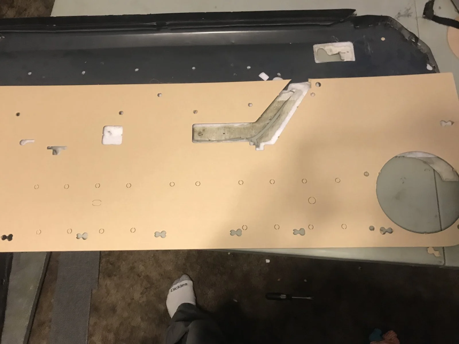

Remove the tabs or rivets as good as you can.
The panel will line up pretty easy, just make sure you center it as good as you can.
I used rivets with washers on both sides. Drill and pop away. I did one on each side then make my way across . I wish I had added more.
Oh! And pop out the cut outs now, doing it after is a pain.

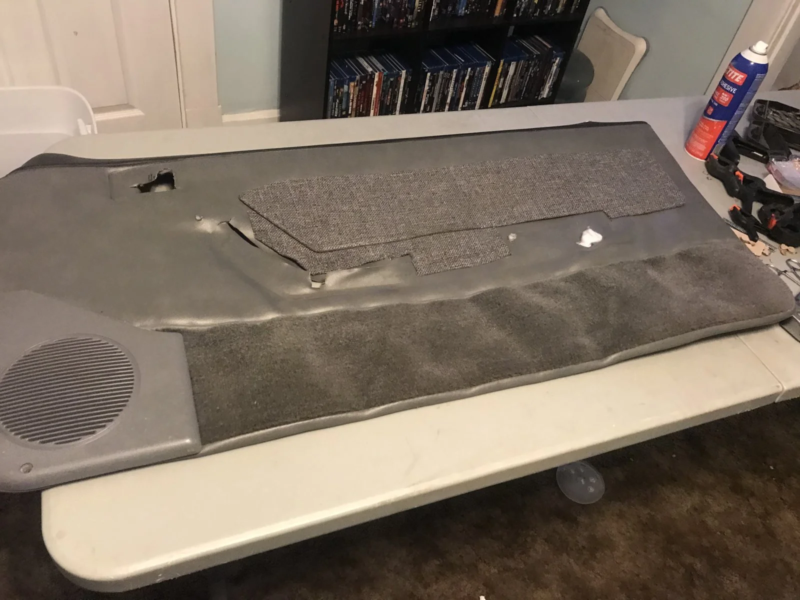

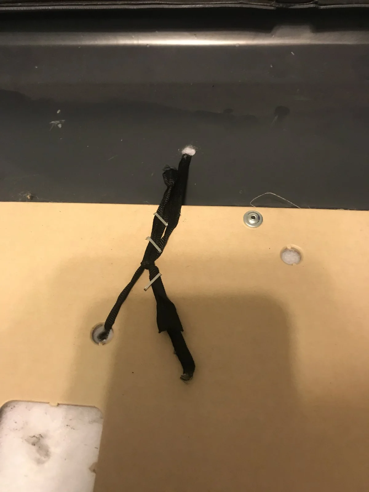

I pulled the edges up and over and used a little glue and then a few staple.

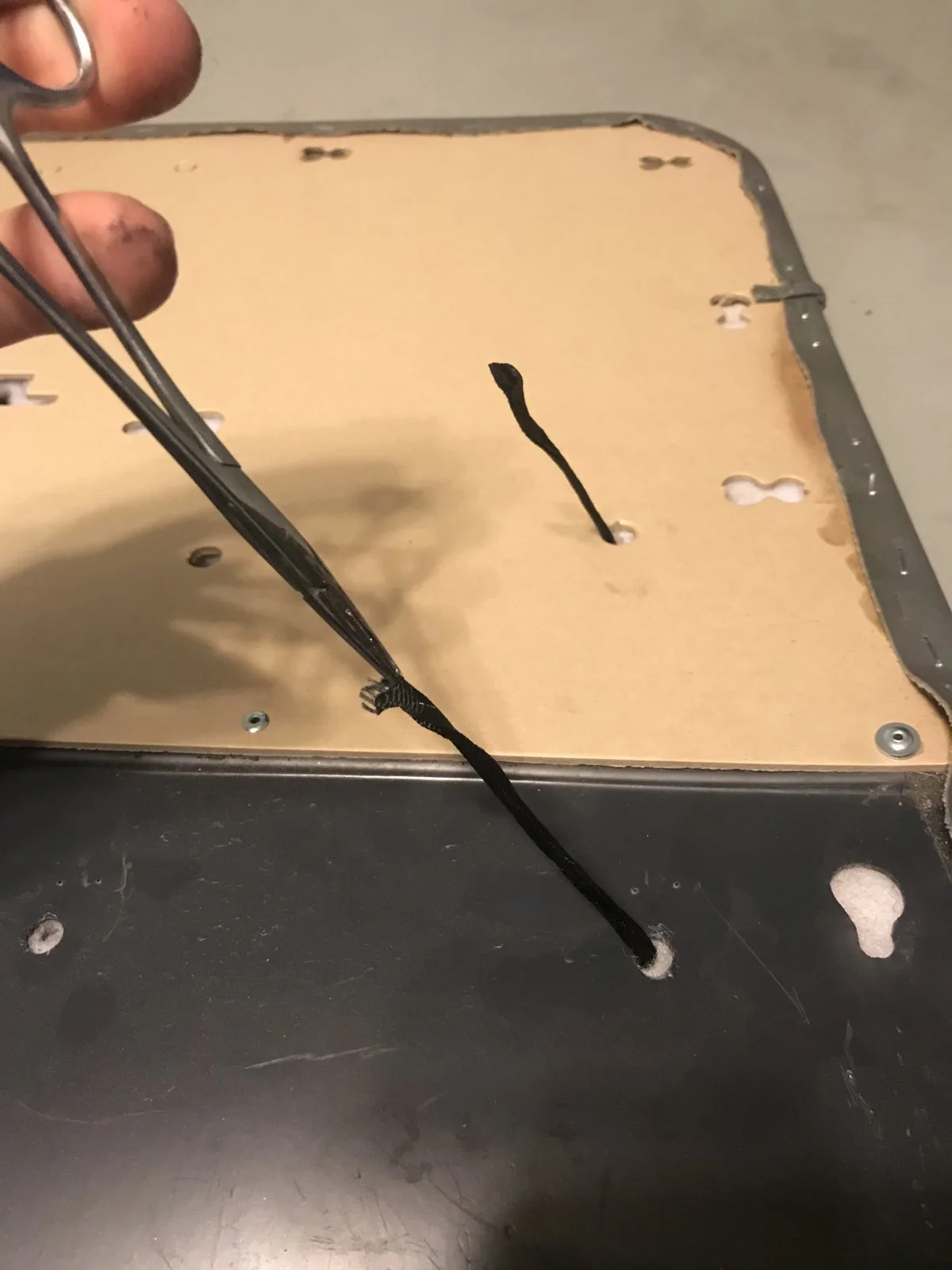

Using the hemostats , pull the ribbons through the holes. I pulled them around each other and then stapeled them down.

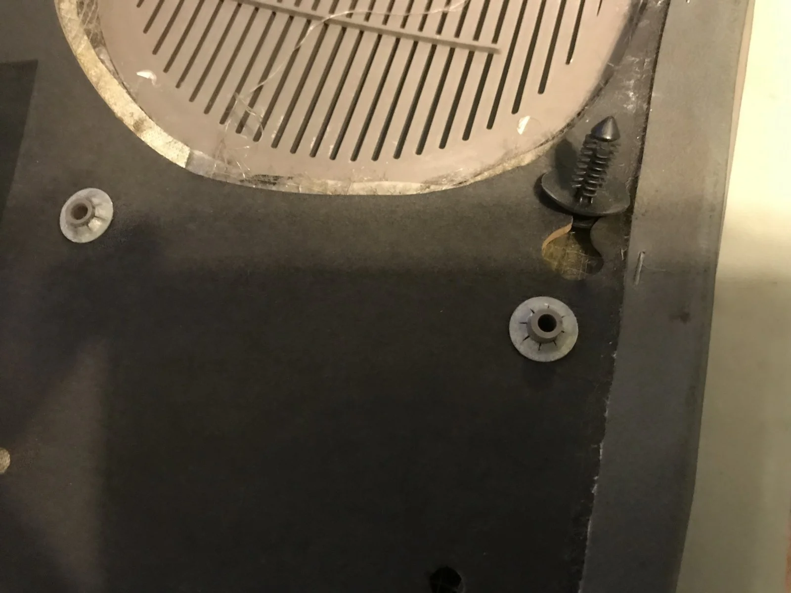

Last but not least, I put the speaker cover back on. Getting the holes perfect was fun. Maybe do this before you glue the rest of the bottom..
Anyway, flip it over and enjoy your good work.
