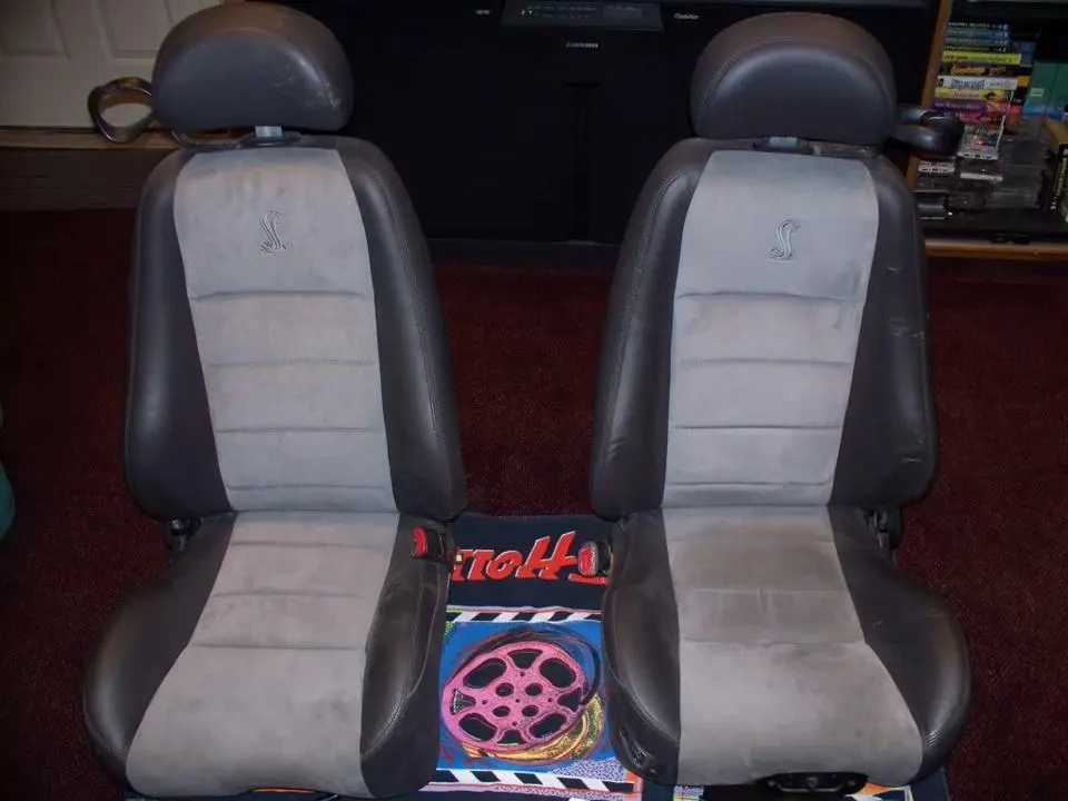

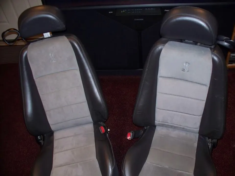

Dirty, dry and dusty seats the way i got them (this guy didn't take good care of his interior :()

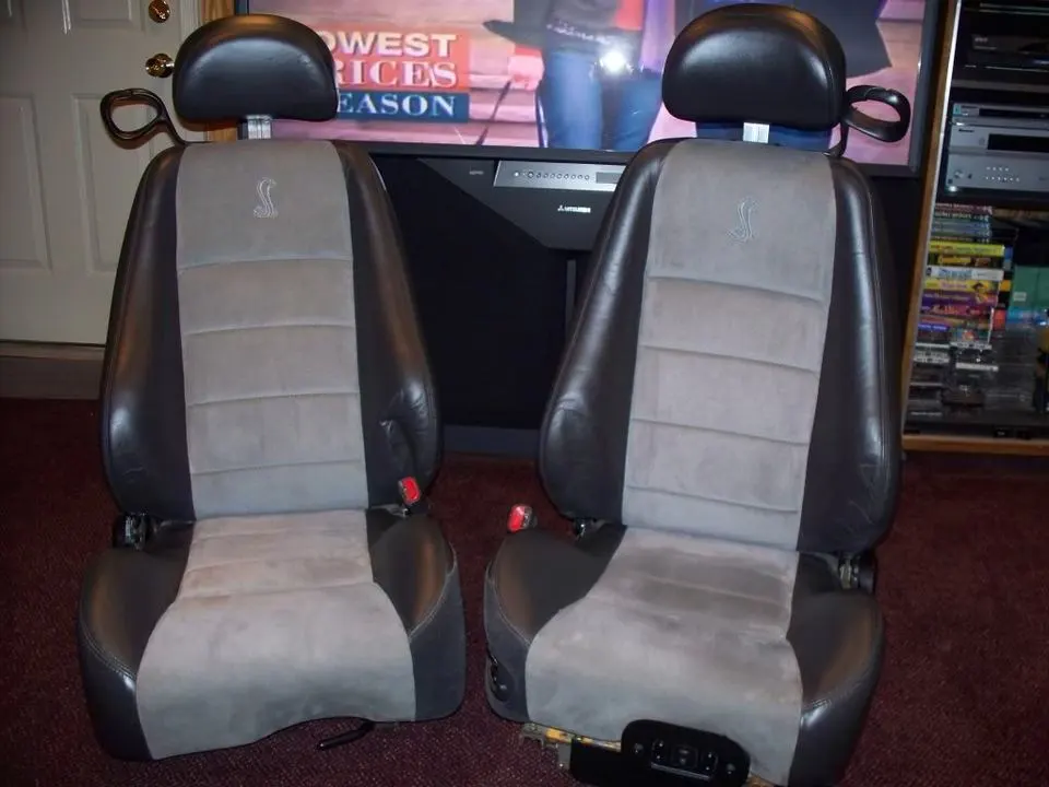

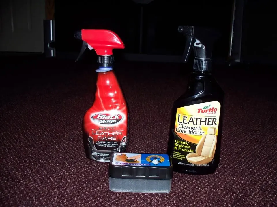

After a 2 hour complete cleaning, suede brushing and conditioning, and leather conditioning, they look much better :D
Here's what i used to clean them, the suede brush was bought from a local shoe store

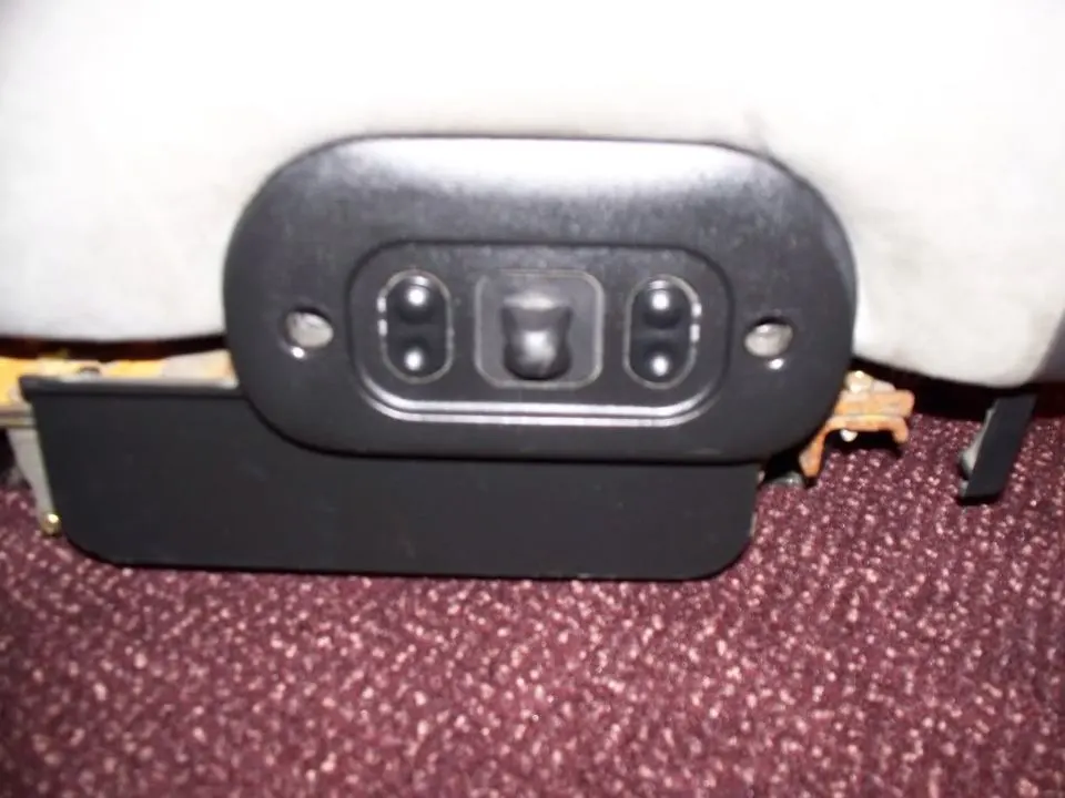

Full power

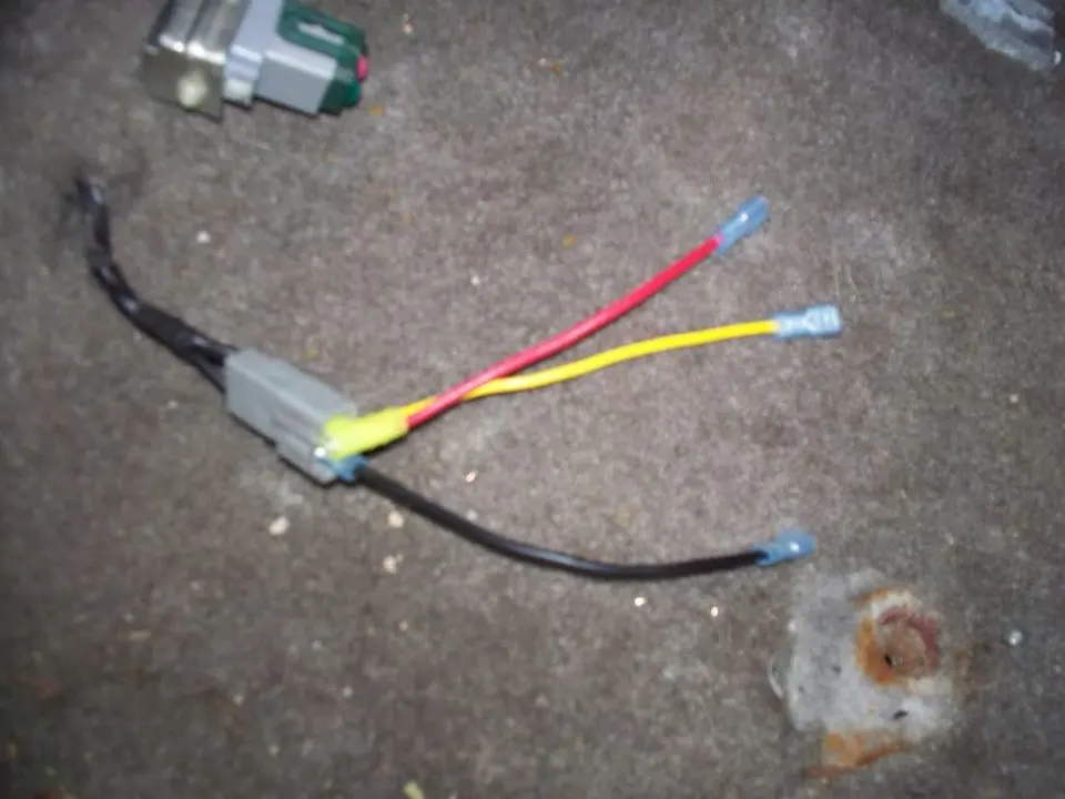

New wiring to power the seats, basically put a splitter wire on the 12v power source on the stock fox plug (see Mustang5L5s progress thread for pics)

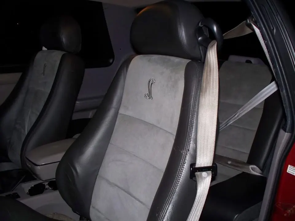

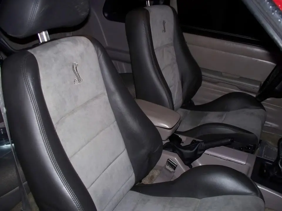

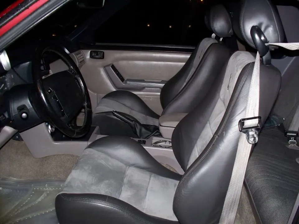

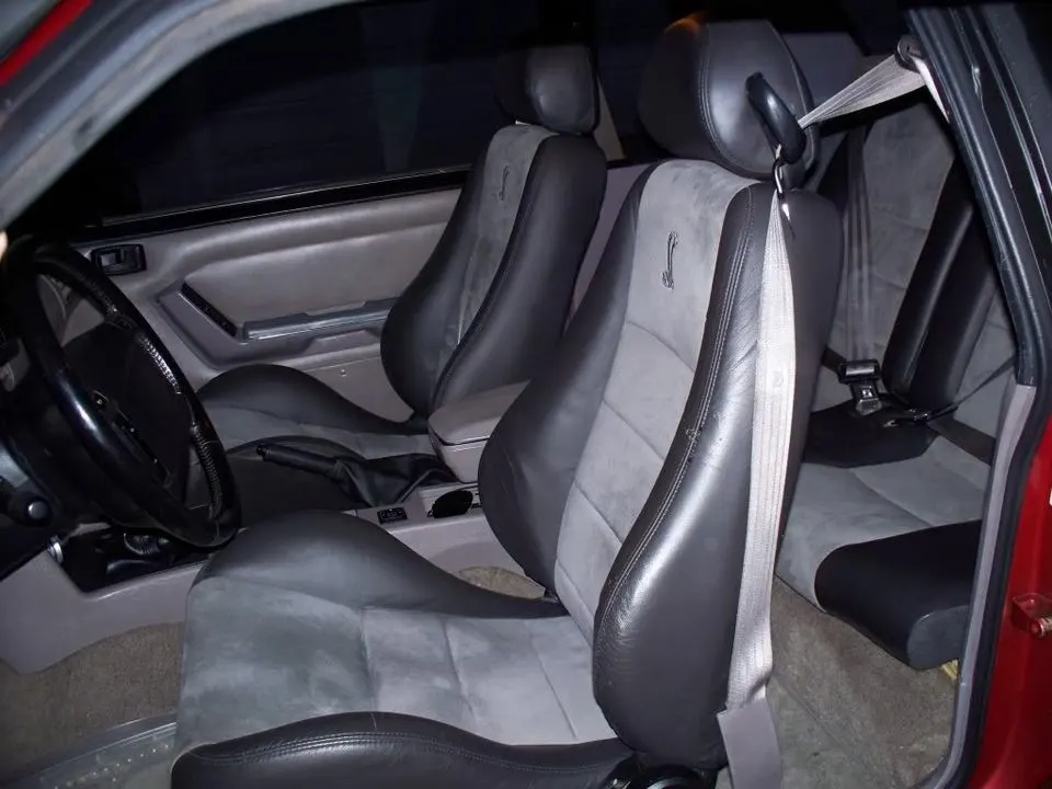

Installed! the fronts bolt right in

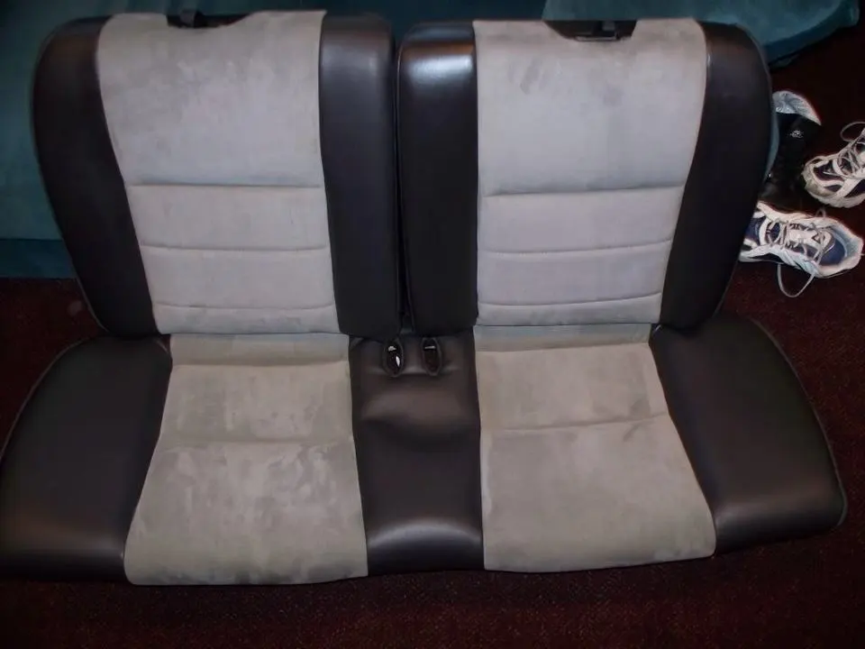

rear seats cleaned up and conditioned just like the fronts

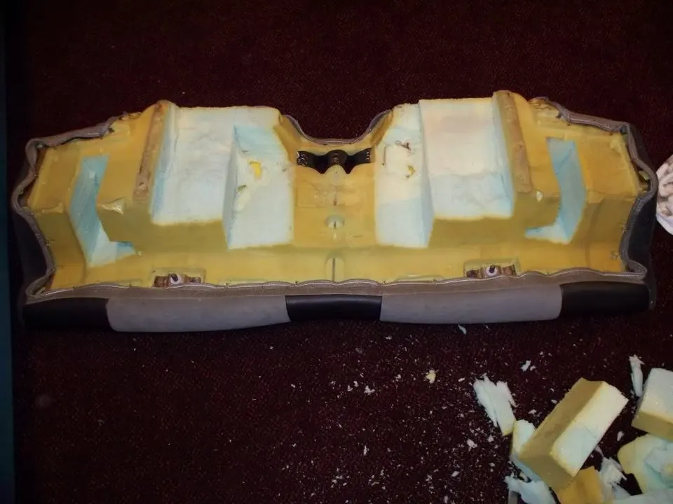

here's a shot of the foam cut out from the seat bottom, pretty self explanatory, just see where it hits the floor and cut it out, this part was a lot of trial and error

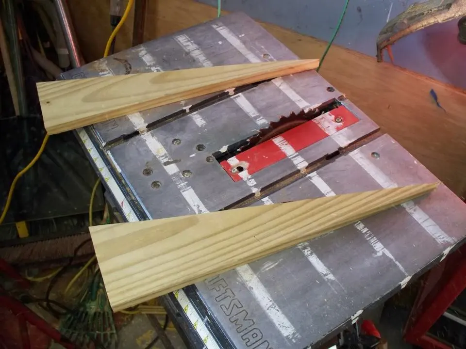

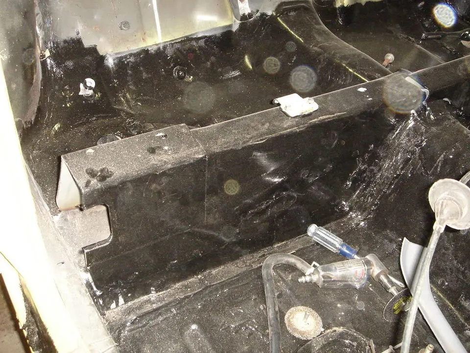

here are the wooden triangles i secured with 90 degree L brackets to the floor pan, the dimensions are 5" tall x 20" long, i'm not sure how one would secure these without drilling into the floor pans, feel free to chime in with a way if you can think of anything, i know some people might be weary of drilling into their fox's floors... and luckily all my fingers survived using the table saw :rolleyes: disclaimer: i suggest goggles for this part or calling someone who is comfortable with power tools if you've never used a machine like this before /endLegalBS:flag:

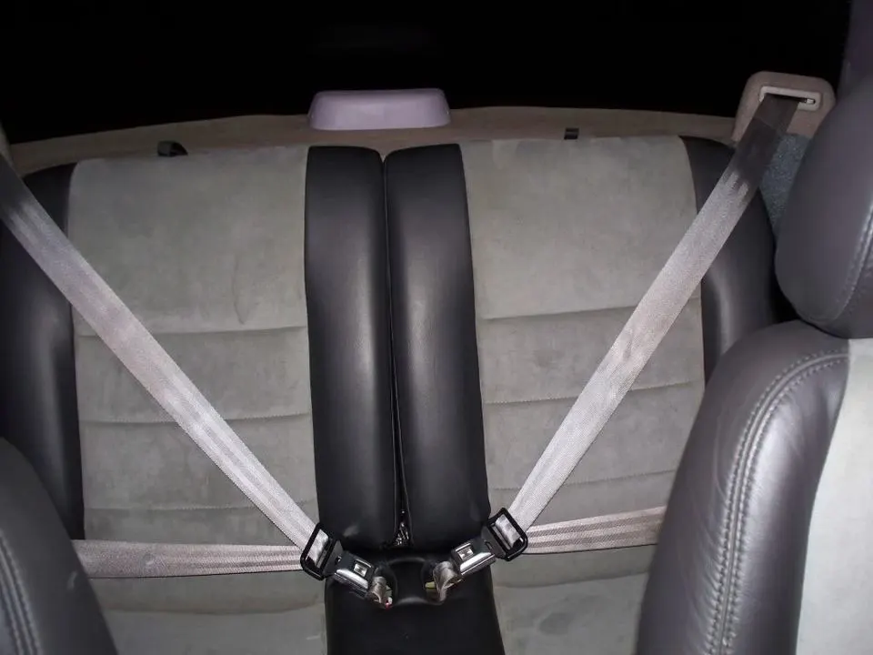

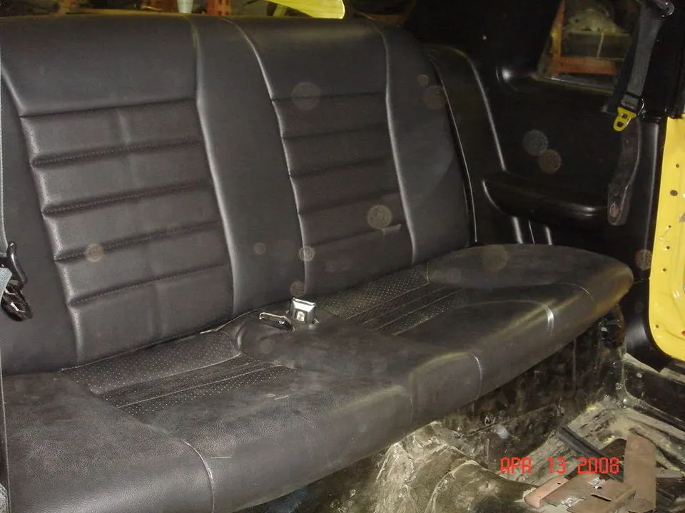

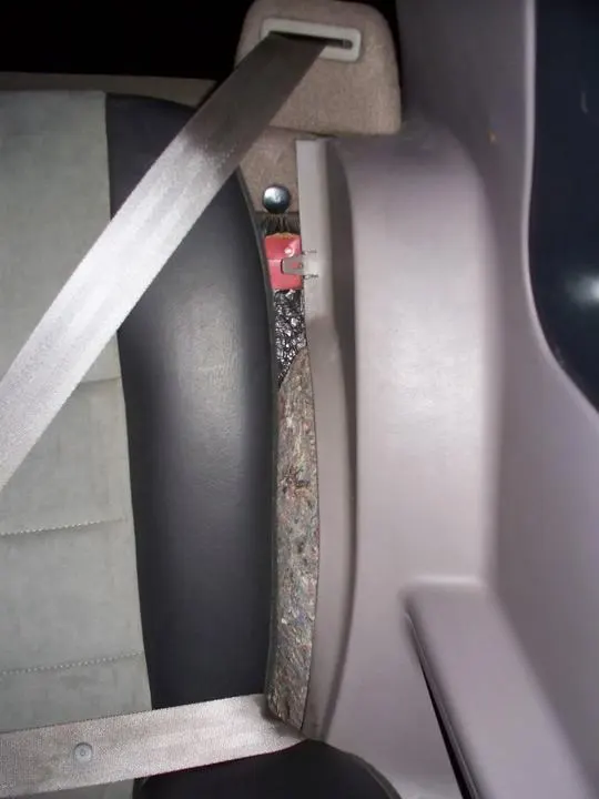

i secured the seat backs with cable ties through the trunk area, and here's a shot of the gap left on the sides, THIS is the problem unique to doing this kind of thing in a coupe

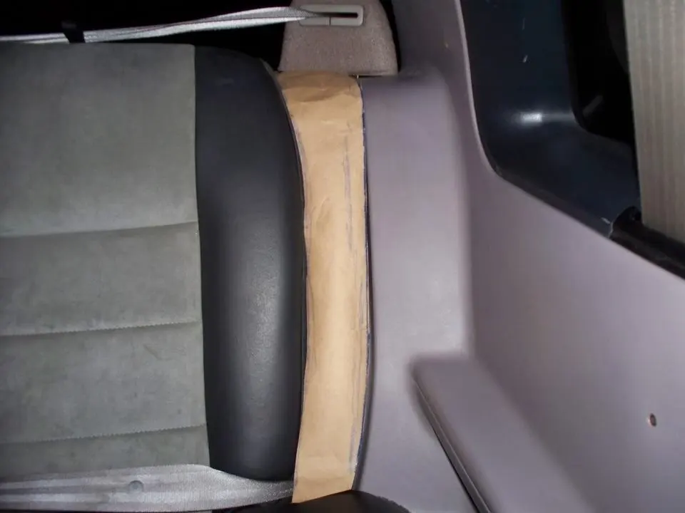

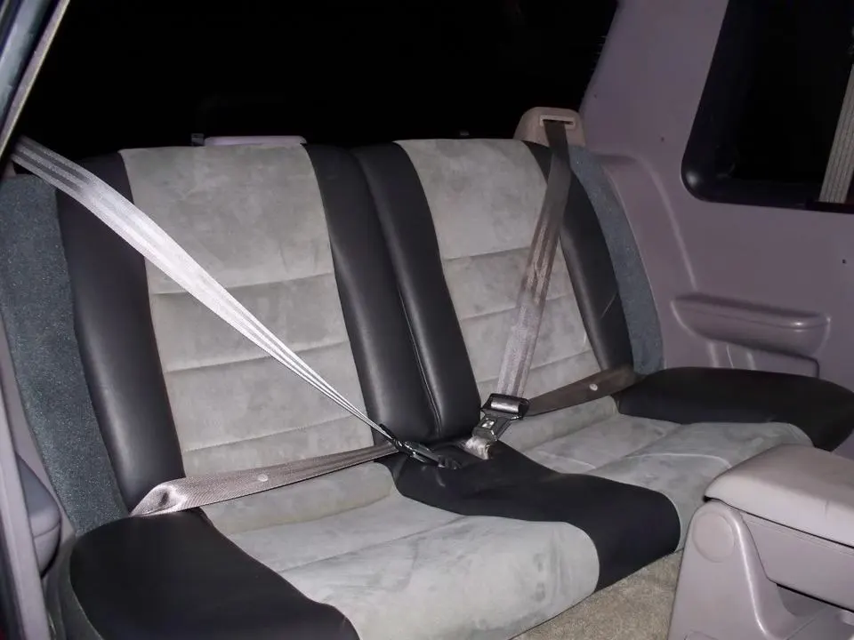

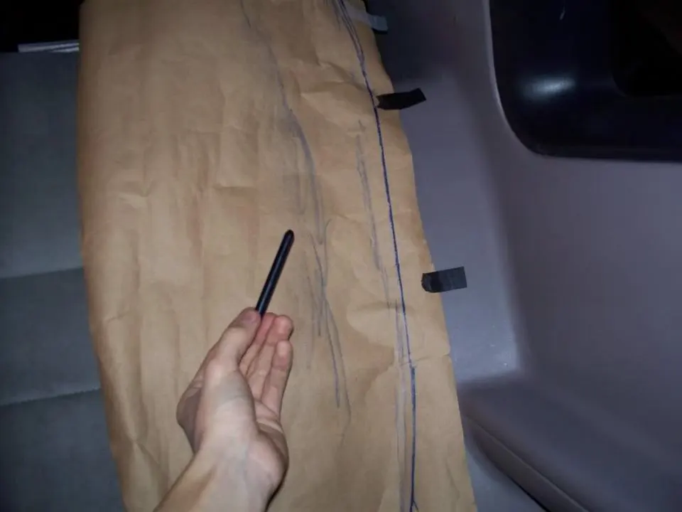

to fill the gaps i made a template of the space out of paper, and used a crayon to make a rubbing of the boundaries
finished template

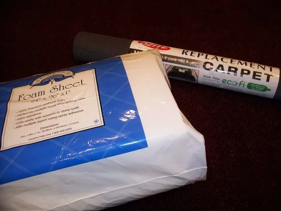

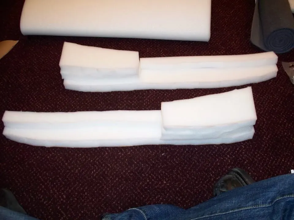

here are the materials i found at a local wal-mart, $8.50 for the gray carpeting and $14.99 for the foam

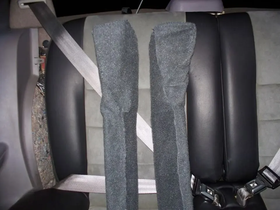

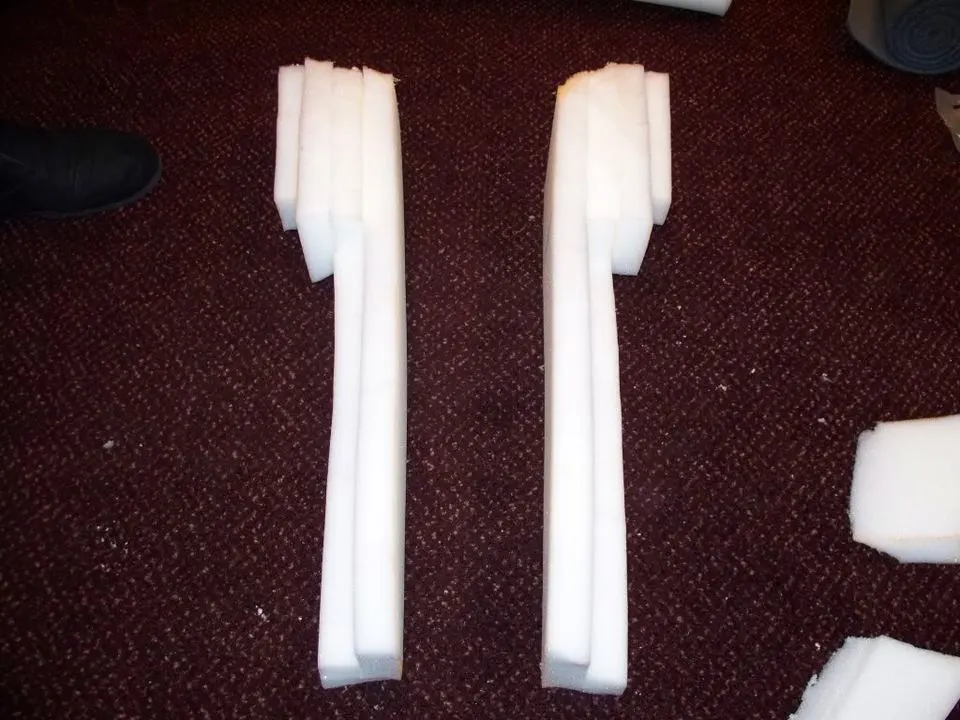

i traced the shape of the template and built up the foam in three dimensions to fill the gap, and then reversed it for the opposite side (just trace the pieces for the first side in reverse before gluing them)

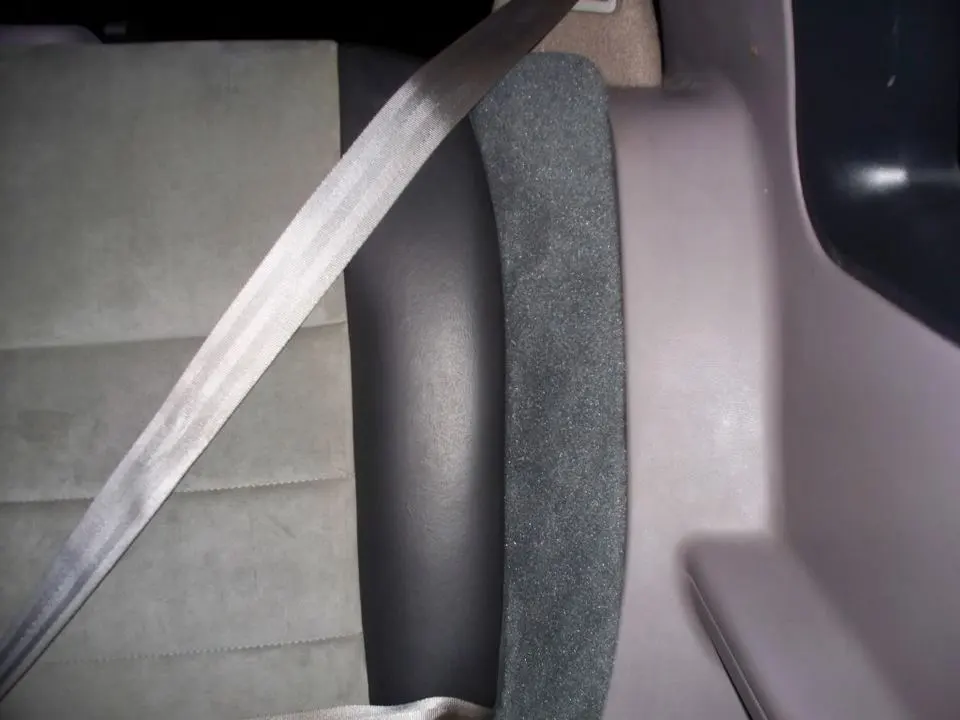

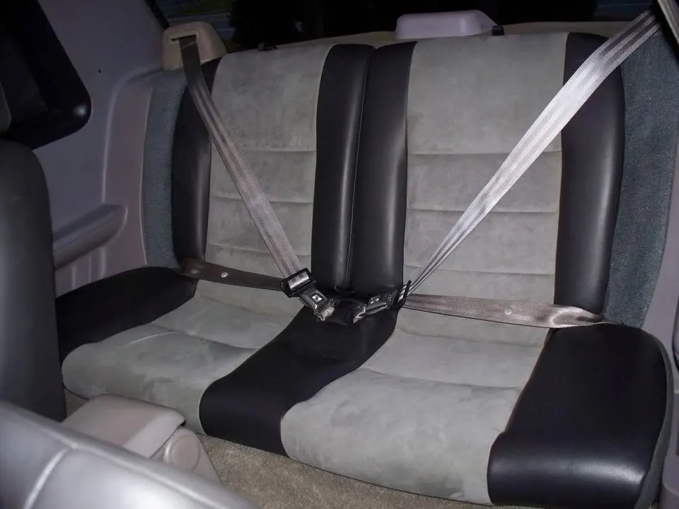

i'm a lot of things, but a seamstress isn't one of them, so sewing these damn things took me a long time, but they came out pretty good all wrapped in carpeting

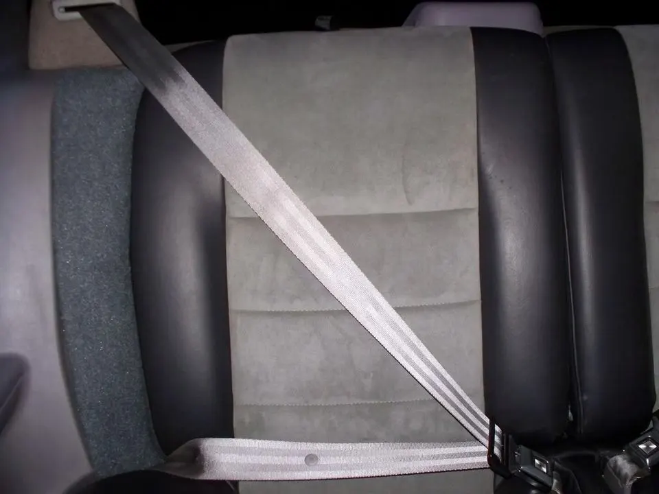

passenger side fit and finished
driver side fit and finished
FINALLY THE WHOLE REAR SEAT IS DONE! you can barely tell there was ever a gap there with these in place

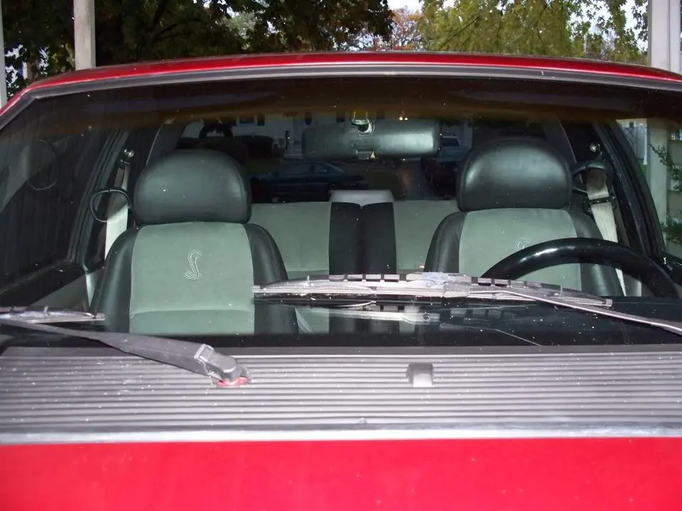

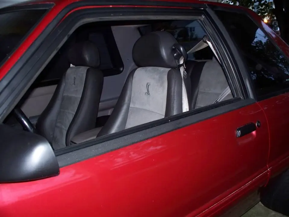

and here are pics of the finished product! i plan on switching to a black carpet and even tossing around the idea of keeping the gray floor mats on top of the black carpet, to keep the black and gray theme going... we'll see, enjoy!
I hope this thread is useful to anyone trying to do this kind of thing in their own coupe, feel free to PM me or post replies with questions or comments

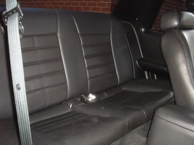

When I put the SN95 bottom seat in my notchback, I welded the 94-04 rear seat cross brace in the fox so the SN95 seat clips in just like the factory seat. I had the notchback seat recovered to match. It sits up higher and is more work, but you don't have to shave foam from the SN95 seat. You need the use 94-04 carpet with this method as well. I should say it's more work to get the brace out of the SN95 than it is to weld into the fox.

thanks for the kind words SVT, your method is the REAL way i would have liked to do it, unfortunately the junkyards around me were wiped clean of sn95s and that whole area of the donor car i got the seats from was tweaked from the crash (i couldn't even order those white seat clips from my local Ford dealer [wtf?])
i kinda feel like my way was the "quick and dirty" way of getting it done, but it was mostly improvised and i'm satisfied with the results for now, who knows if it will need revamping in the months and years to come, but for now it's doing its' job :nice:

There is nothing wrong with they way you did it. I actually skipped out on using the 2001 back seat because I didn't think I'd be able to make those side fillers you made.....Give yourself a pat on the back. :D
That brace was a NIGHTMARE to drill and chisel out of my 2001 donor car. I worked up that thing for a good hard hour. It doesn't sound like much, but just imagine using a drill and a Snap-On air hammer with all your might, then pounding with a 3 pound sludge. :notnice: I don't plan on doing that anytime soon, but if anybody does....cut the middle of it to make it two seperate peices. It comes out much faster and easier after you do that. Unfortunately I didn't figure that out until I yelled every cus word in the book at the thing...:rlaugh:

That I am....:rlaugh: Honestly, the worst part was the corners. That brace is just what it is a brace. It is reinforced so much at each quarter panel. Double and tripp metal with multiple spot welds. That thing has got to stiffen all 94-04 Mustangs. Now of course if I had to do it again I would have done it different. I didn't weld mine in like it was in the SN95. It isn't reinforcing or bracing anything in Hack Job...it's just there to make the seat work. If I did it again, I'd weld it in like a brace, end to end, everything touching. I would then have notched "cut-outs" in the quarter trim panels (like the SN95 cars are) instead of slipping them inbetween the brace and the quarter panel. Just would have strengthened the car I think, plus the carpet would have fit better.
