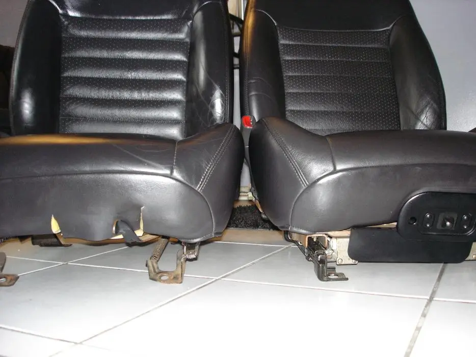

Here's a direct comparison
Driver's seats from My Fox (on Fox tracks) on the left sides and my stock '03 GTs tracks on the power rails on the right side. The power tracks are tilted slightly back, but if i set it level and low....it would not be comfortable to sit.

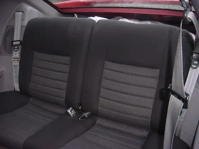

Didn't read the whole thread...I did it another way,lol. I just had the stock seats reskinned by a local shop to match the SN rears. No filler material on the sides are needed. Although with those cobras with the suede inserts it would probably be way to expensive going this route.
I also removed the power seat track and used a manual on the drivers seat. The manual track actually sits a tad lower....which these 99+ sit much higher than stock.
NoSlo those seats look good, that's exactly what Matt (SVT32VDOHC) did with his rear seat back, he just had the stock one recovered i believe... in order for me to have my stock seats recovered to match the grey suede/charcoal Cobra seats would have been INSANELY expensive haha, my method was easy enough and works like a charm :nice:

I have 04 seats in my fox front and rear no fillers beside the seats and no gaps and they fit like factory. I have noticed that most that do this have a gap in the upper rear seats and the lower sticks out to far. Check out mine and I used the 04 seats just a few tricks and about 1 hour of thinking
Ok, I want to do the newer seat upgrade also, but I have notiche that svt302vdohc has a one piece rear and some others have a two piece, whats the differance in the swaps, I personally like the single piece backs. I have a hatch.
His seat is custom. I beleive it was the Sn95 seat bottom and the original 1981 seat back recovered to match the seat bottom.
79-82 is the 1 peices, 1983 and later were all split fold. I could be wrong on the years. Someone will correct me
Also, his car is a coupe, and they all had one piece seat backs. Most every one else has installed them in hatch cars that have the split seats originally. On coupes, the most "factory" looking way is to recover the coupe seat back to match the rest of the seats.
