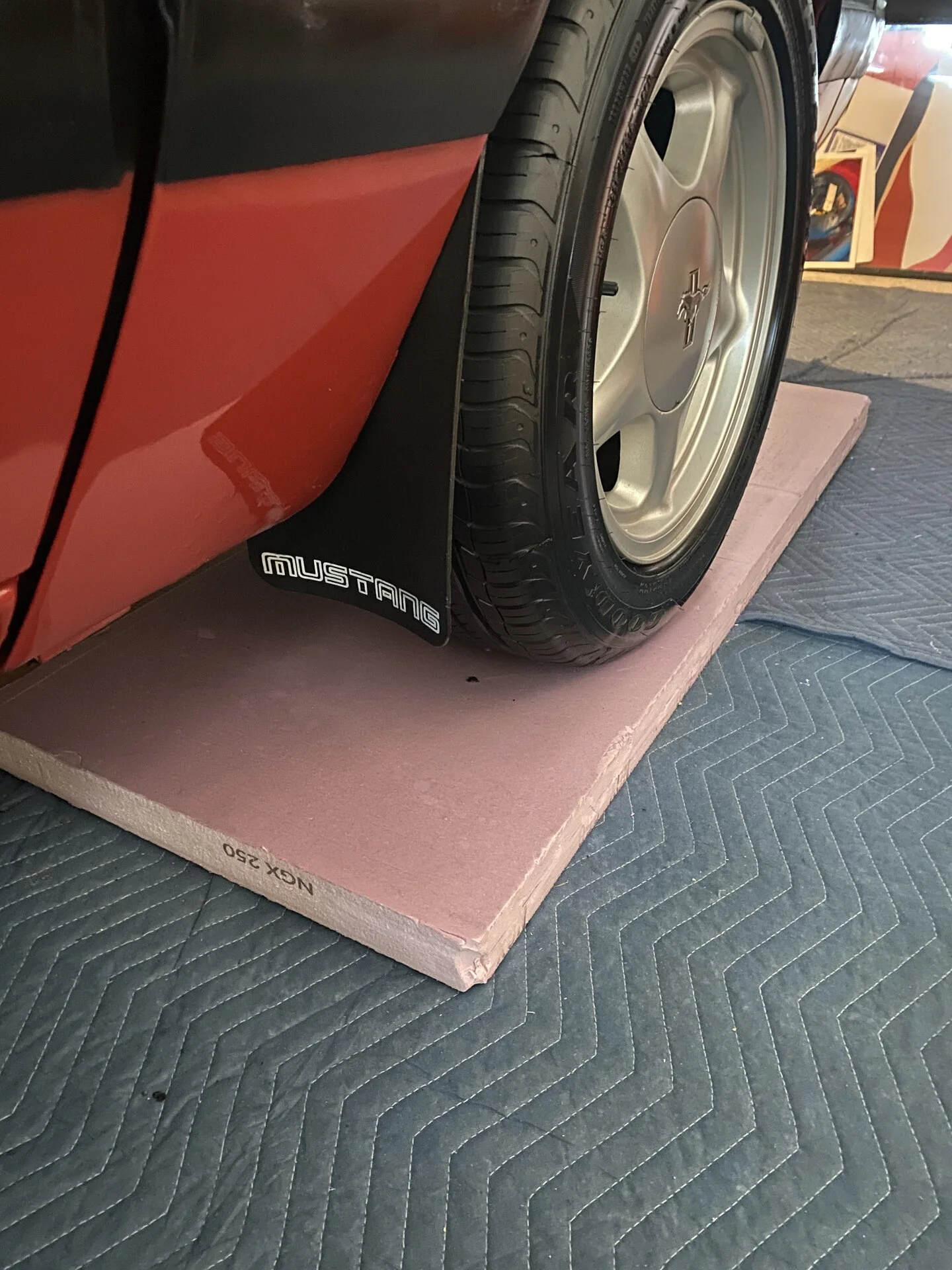

I do everything 5L5 stated and for my tires to prevent flat spots I put the car up on 2” thick foam insulation blocks. I buy a sheet at Home Depot and cut to size.

Awesome, thanks! I'll look into the foam for sure. Wasn't sure if foam or rubber mats helped. I've read about people jacking their cars up to prevent the flat spots but wasn't sure if that was necessary.
