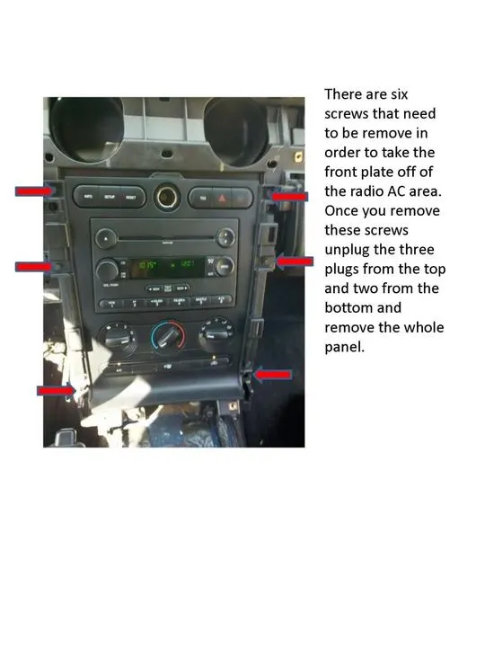

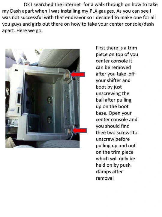

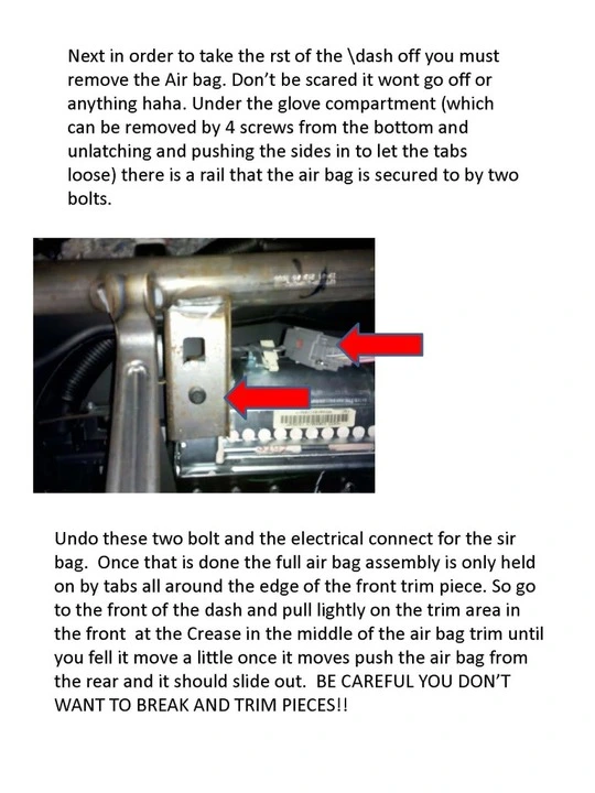

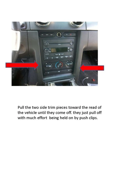

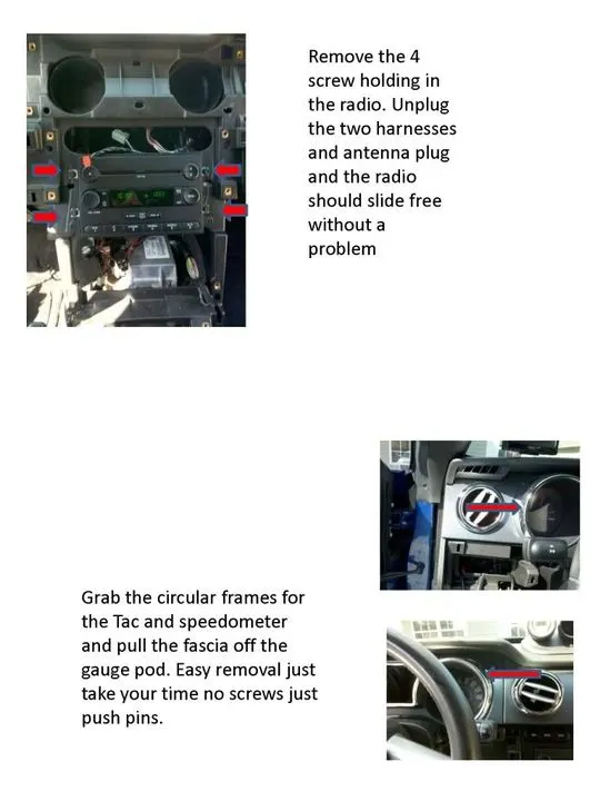

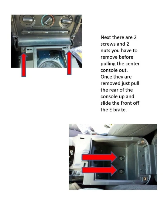

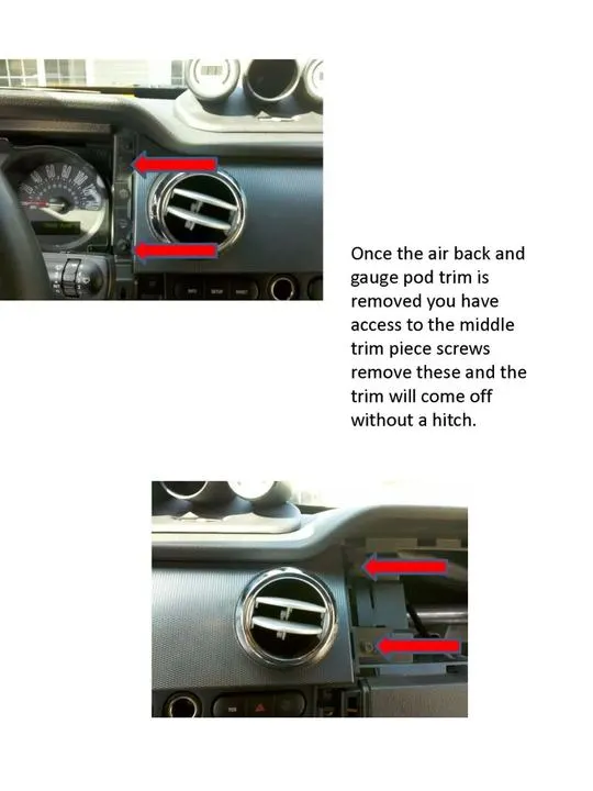

This is my first write up and i would love some tips on how to mkae it better thanx.[/quote]

Ill have more pics soon on the PLX guage install along with running the wires with a No drill setup gauge pod on top of dash. i figured i couldnt find these so i would help other peeps who liek to do there own work out a little.

helpful write up.
