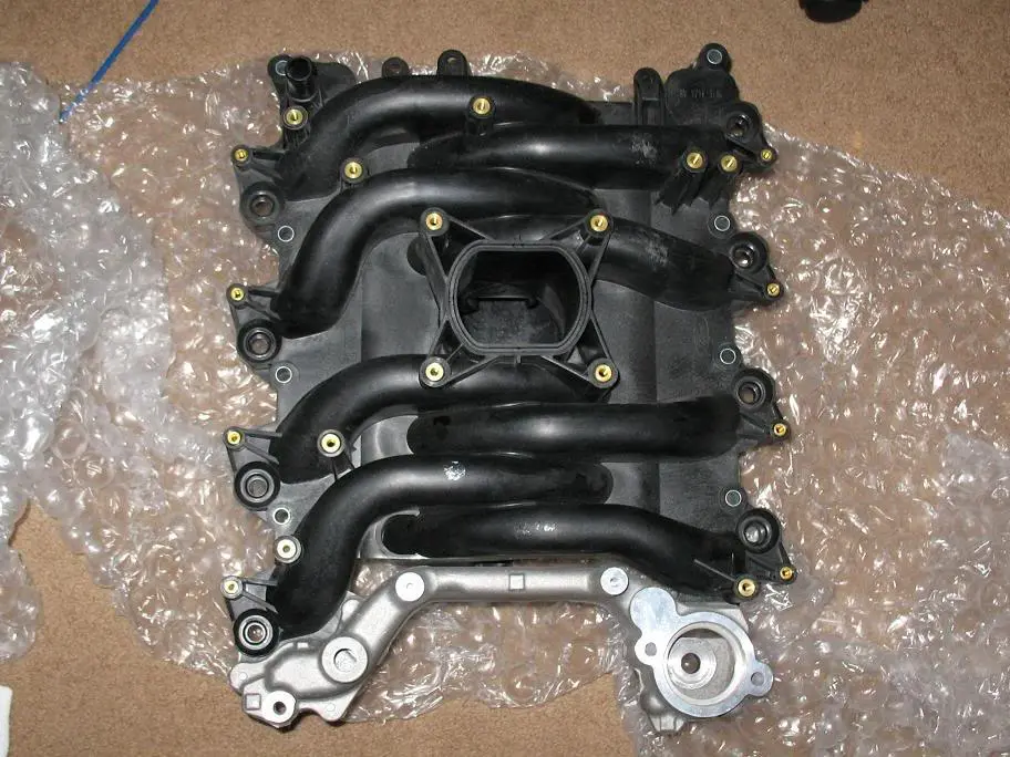

Likelyhood of it being windsor is less, if it's romeo you wont be able to tell unless you snake around to the cast numbers. Look at the intake, if it's still NPI then the heads are still NPI. On PI intakes the first crossover comes from the right like this:
on NPI it comes from the left

Forgot about that. That is an easy way to find out. Good job!
If it has a NPI intake, you can bet it has NPI heads. If it has a PI intake, don't count on it having PI heads, there is a lot of PI intake swapped cars out there now. It would be a safe bet though that if it has a PI intake it has PI heads. The best way to really determine which head it has is the casting number. Hell, if you looked at my NPI heads without looking at the casting number, 99% of the people would swear they were PI's...

right, that's a given. I'm just banking on it having NPI intake therefore an easy tell that's the heads are NPI.
Could just have PI cams though. But if you go that far, you might as well change the head as well.

OK I got some time today and looked at the motor. I checked the intake manifold and it is npi so I guess the motor is just really healthy, cause I dont see how I was hangin with my brothers 08 gt.:shrug: Thanks for the help guys. Im soon doing my auto to 5 speed swap. I'll post some pictures when I put it in. I bought a TKO 600 from promotion. I had them polish the lugs and put upgraded shift forks. I'm hoping it will be a good tranny. :nice:
