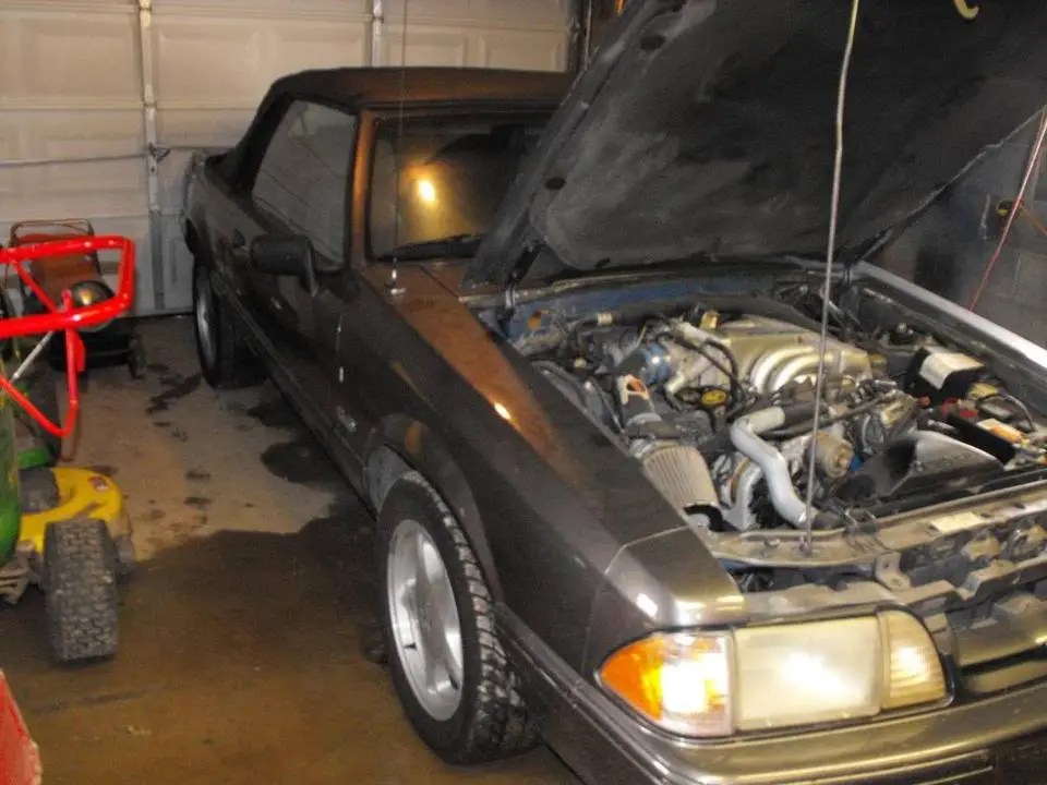

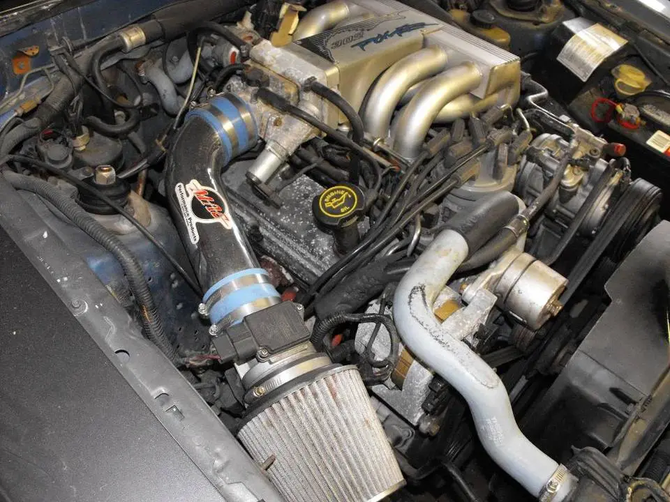

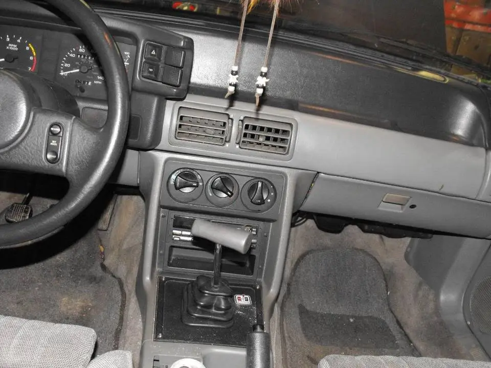

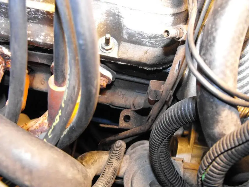

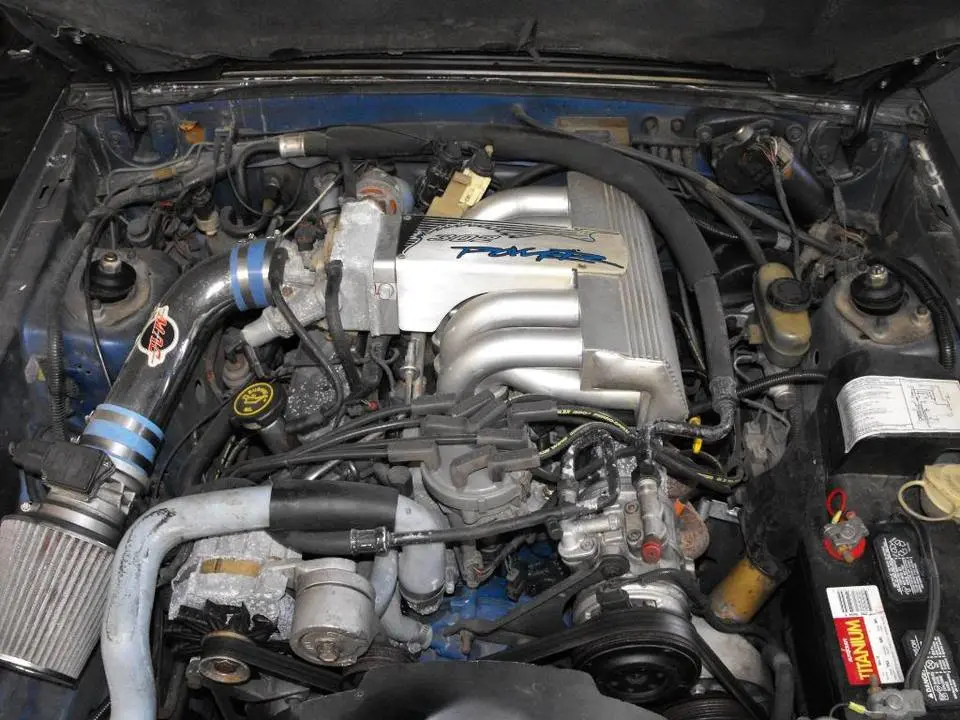

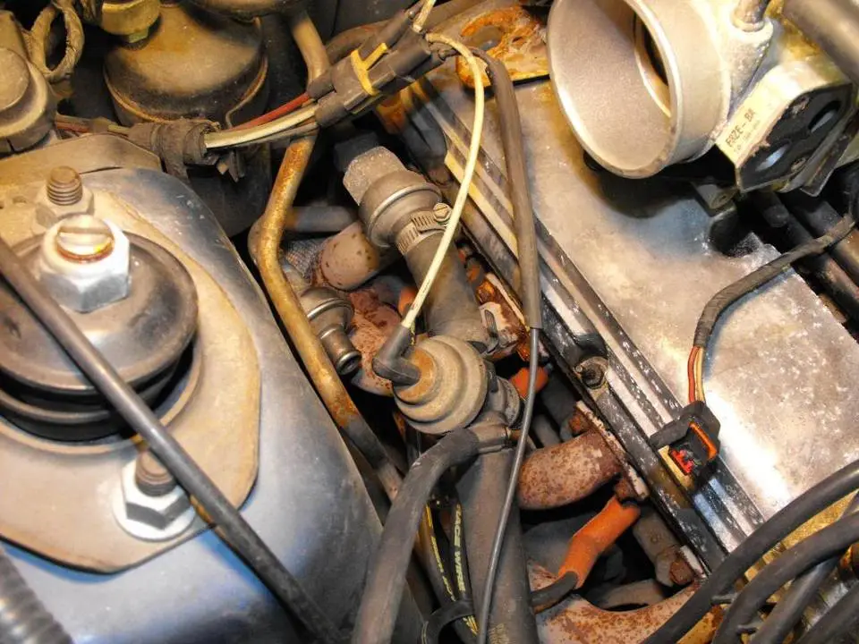

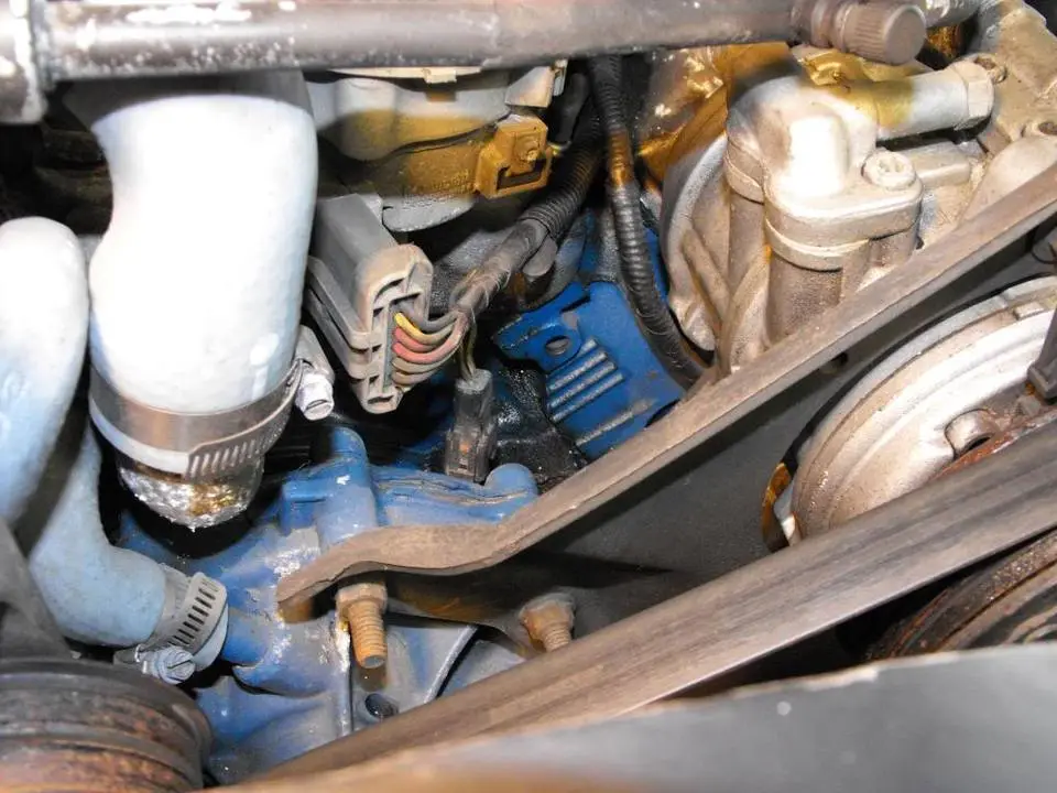

here are the pics
Well it has a GT-40 intake, but from the looks of thing those are iron heads. So i don't think it's a crate motor, but it could still be GT-40/Gt-40P heads. We need pics of the heads to be sure.
