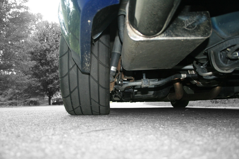

I run the 265/40-18 on the fanblades. You can run a 275 on either the 17x8 or 18x8.5 OEM wheel at the track, but I wouldn't run a 275 on the 8" wheel on the street.
