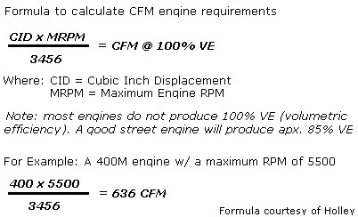

Looks like you are right in the Ballpark for the Carb and the intake combo.
(CID * MRPM) / 3456 = CFM @ 100%VE
347 * 6500 / 3456 = 653 CFM at 100% volumetric efficiency.
