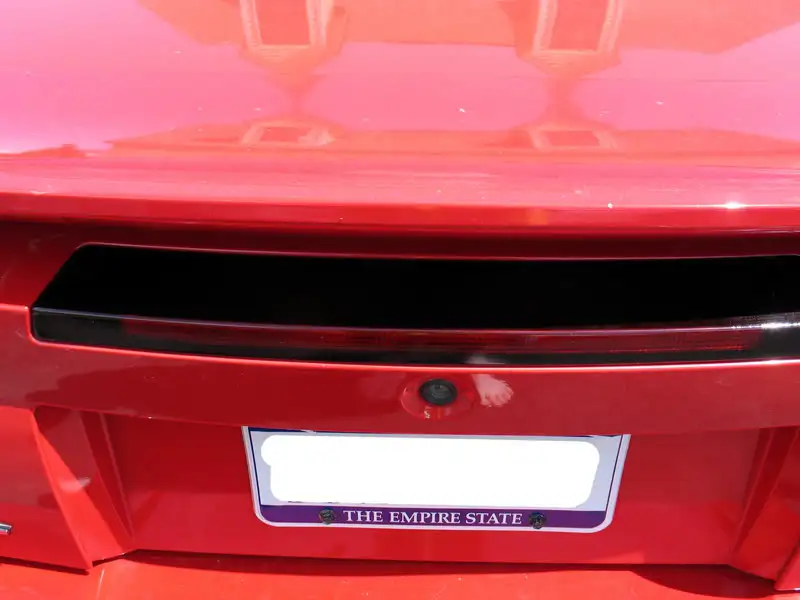

how would these look on my car??

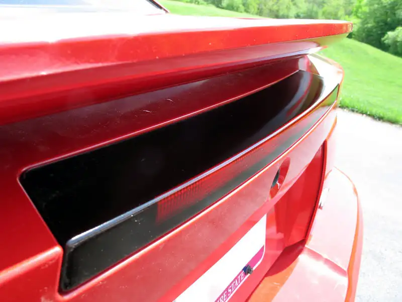

yeah i had looked at quite a few places, just couldn't seem to find what to use around here... i've cleaned them up quite a bit just with some acetone... not sure that spelling is even close lol

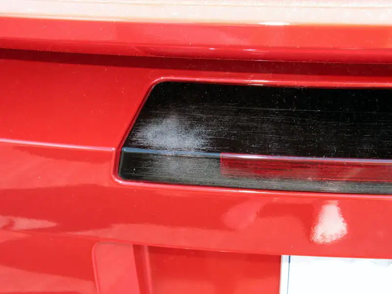

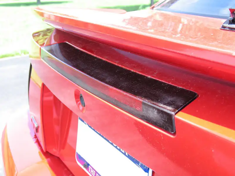

wetsanding. 400 grit, 800 grit, 1000 grit, 1500 grit, 2000 grit, 3000 grit, then use plastX (meguiers) on the new surface and theyre good as new
before:
after:
