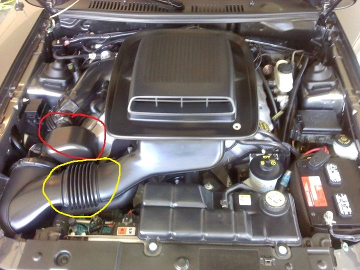

Is the square helmholtz resonator still in place between the air intake and the IAC?

Are you meaning the circled item in pic?
If so yes it has it but as I said above,doesnt matter if the duct work is on or not,still makes noise.
BTW, that pic isnt my car,I just grabbed it off google images

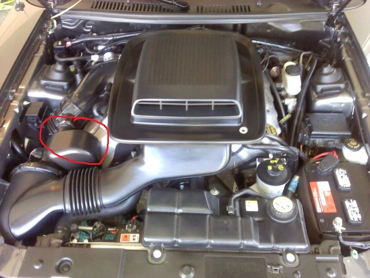

I removed the silencer( the snorkel of the air box into the fender) then I also removed the milk jug ( red circled item in above pic) and capped it off with a #9 rubber hole plug and a hose clamp. so far almost 2 weeks moan free. Crossing fingers it stays that way. Im just going to order a CAI soon since the main air duct is dry and small cracks, dont think its sucking air from what I could tell with a spray bottle of water and a few drops of Dawn.
