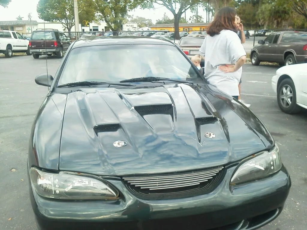

A shot of what im working with, those hood pins I don't like, comes with buying a used car I guess.
