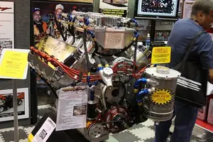

Well this mountain motor is 1005 ci and can make over 2000+ w forced induction I want that hell yeah!!! but it's roughly around 115,000 for the motor :(
