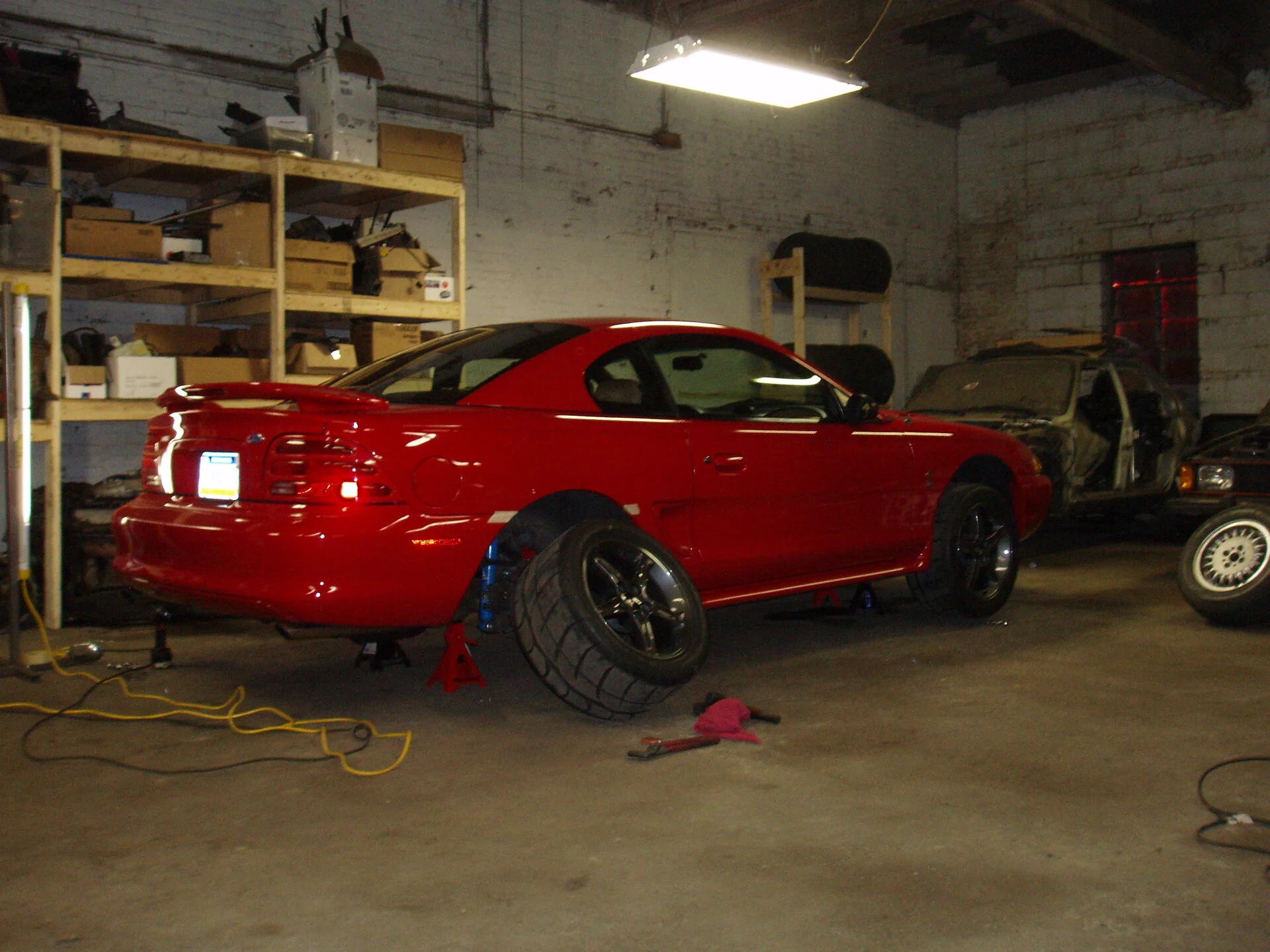

I don't have the car that's pictured above anymore, unfortunately. Before I sold that car in 2014 it was setup for AI with a full Griggs suspension/ect. I think all I had done to the suspension on the car in 2007/2008 was a set of Tokico HP shocks and springs, griggs racing caster camber plates, and bump steer kit. I had a ton of other mods to the engine and chassis by that point. The car ran really well with that setup, but you are correct, it had a tendency to oversteer with the staggered setup and primarily stock suspension. I was able to partially correct that issue with a rear sway bar change, but it really took a fully built suspension tuned for a staggered setup to get the car where I wanted it. The car still did well though, I got first place in SCCA SM class for my region in 2008 and didn't have any trouble keeping up with most of the pack at NJMP, Summit, and Watkins that year.
I had to hammer the hell out of my wheel well and roll my fenders to fit the 315 NT01's fyi and I had to run a 1/4 spacer. They would rub a lot during hard cornering before I did all that. You also don't want to lower your car too much on the stock suspension as you'll affect the handling characterizes of the suspension.

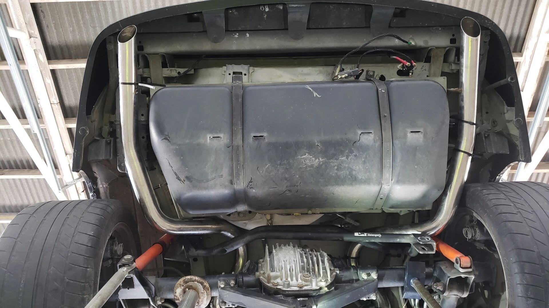

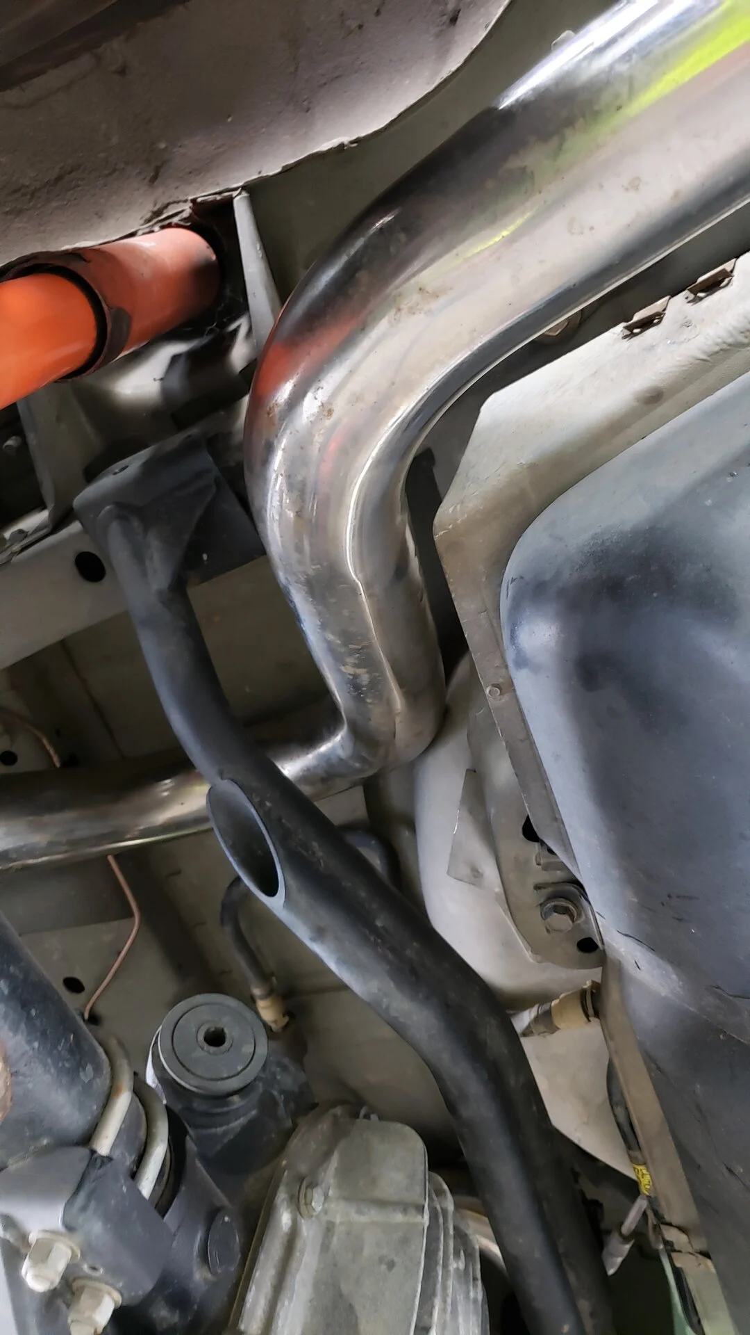

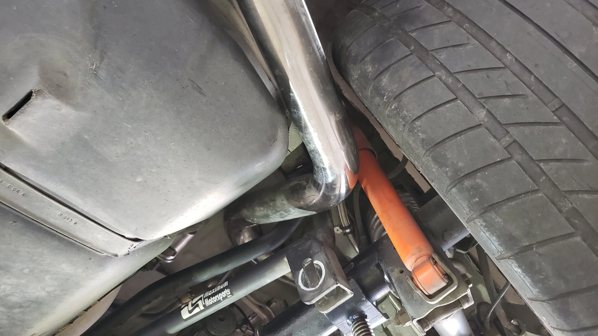

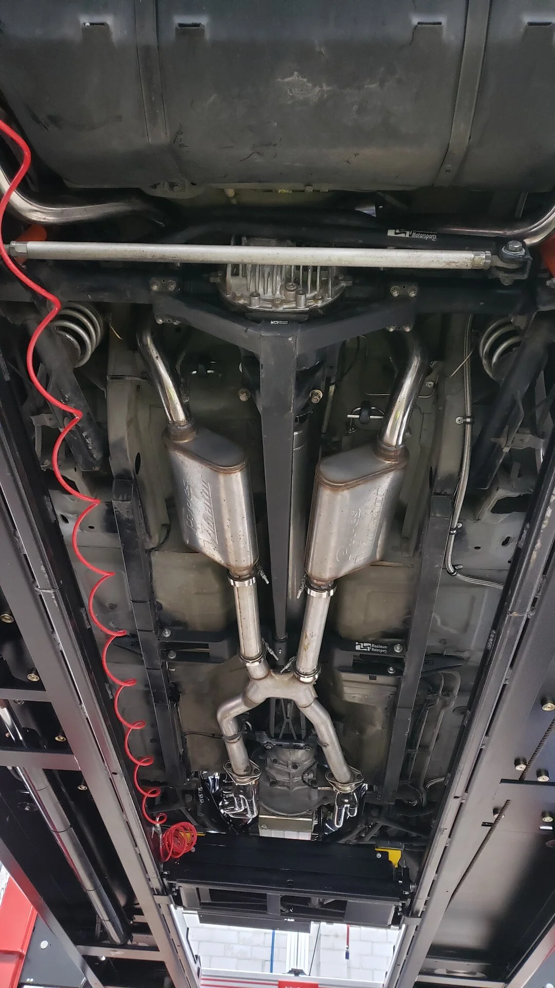

Some clearance pics around the PHB.
Passenger side tire looks tighter than reality, have maybe 1" -1¼ between pipe and tire.
Edit: oh and these are the larger than stock Flowmaster tips from my old Fox, so if your going from a newer model it will probably be diff...i just remembered that
