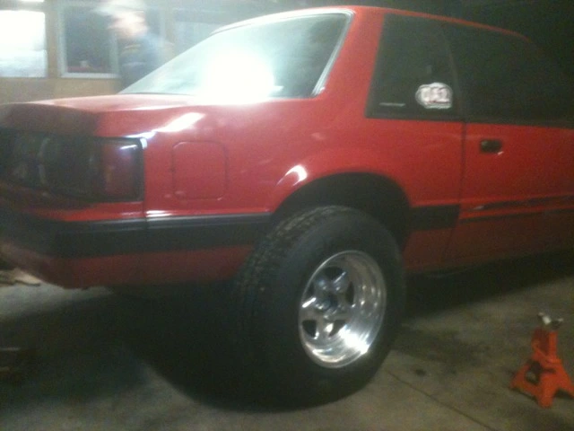

Huge Rake?
Holey cow!:rlaugh:
That is tremendous rake.
(They used to call it 'stink-bug')
There is something going on there besides just the usual springs and shocks.
Something has been modded in an unconventional way for it to look like that.
I'm 90% sure I will look tonight when I get home but when I installed the springs and control arms everything looked normal...when I had just the rear lowering springs in I put it on the ground and it was level to the stock ones up front
More pics to follow...
You know nothing about rake. That's the race car NOT on jack stands right now :nono:

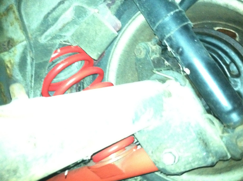

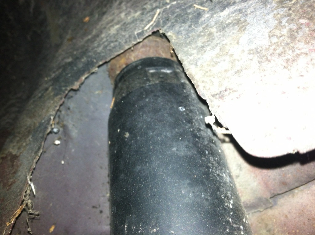

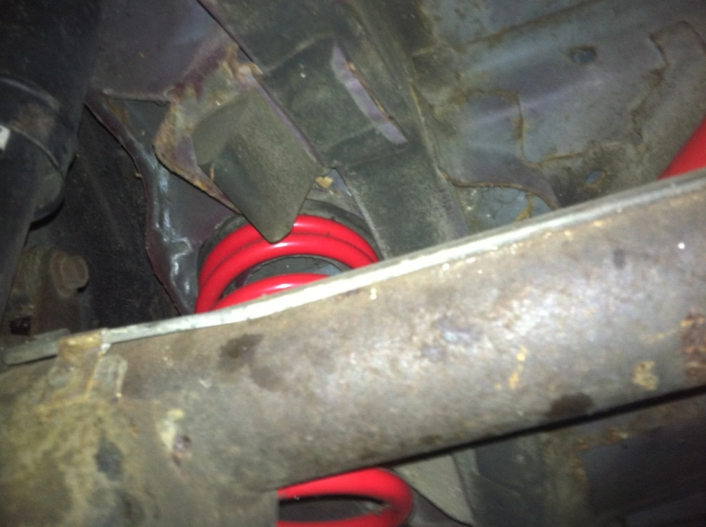

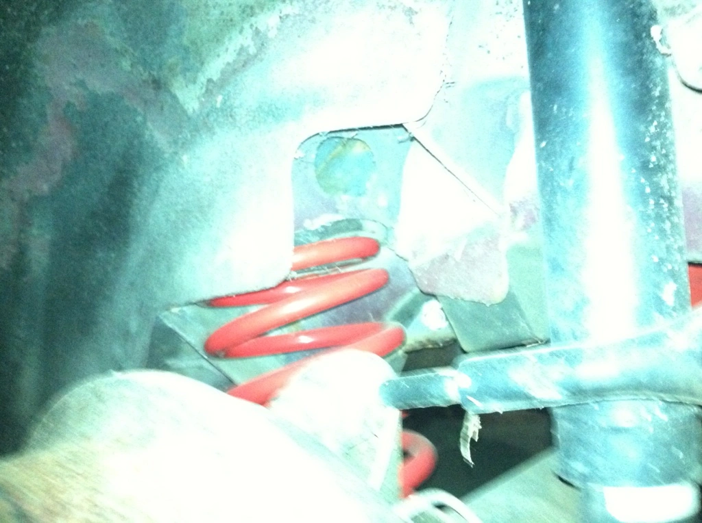

ok soo just went and checked it out again and nothing seems out of the ordinary except something that looks kind of like a spacer on top of the shocks...i dunno if its normal so you guys tell me...heres some pictures (:poo:ty ones sorry)

Well, the pics are a bit close. The thing on top of the shock is the stock washer below the bushing. All is good there. They appear to be factory Ford shocks. Now with that said the pic is too close to tell but they could be factory Ford shocks from something else, and appear to be really long to me. BUT if it is on the ground and you can bounce it up and down, the shock is NOT holding it up in the rear. It would bottom out on the shock if it was.
You posted a better pic now. The shocks are ok. It looks as though there are rubber insulators on top of the spring that could get you a little lower if removed and the spring could be indexed wrong. I can't see if the end of the spring is in the groove in the perch. I'd check the part number on the spring to make sure it is right for the application. If it is, its chop the spring time.
