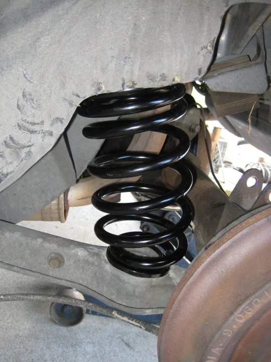

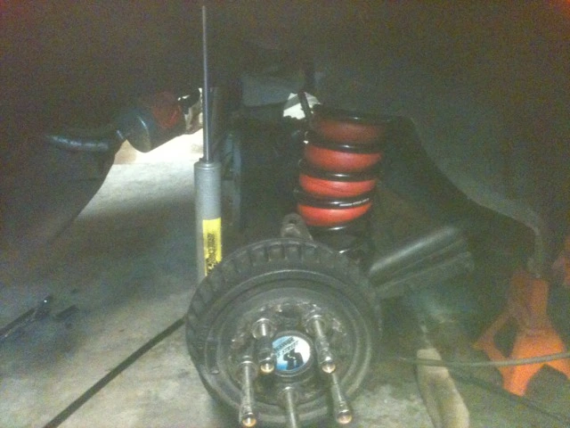

yea sorry the pics suck...but i cant figure out what it is. Im starting to think its the front end its very very stiff and very low to the ground i cant get any fingers between the fender and tire but it doesnt rub?
Ok....taking bets. Who thinks the front springs were installed on the back and the back on the front?Those kinda look like front springs to me.
Or perhaps wrong year of car? Out of an SN95 or S197 perhaps?The last or bottom coil looks small though. And fat the rest of the way up. Fronts are so much smaller around, and the same size the whole way. Not fronts in rear. I think made for the wrong car, wrong package or wrong part number.
Agreed. I asked him this already. Check the box, invoice, listing, etc.Or perhaps wrong year of car? Out of an SN95 or S197 perhaps?
OP...have you got the part number handy?
Unless the previous owner had his in wrong and you just followed suit when you replaced them?ok they are the correct springs and the rear springs are on the rear and fronts are on the front... that still would not explain why it had the rake when it was stock.
