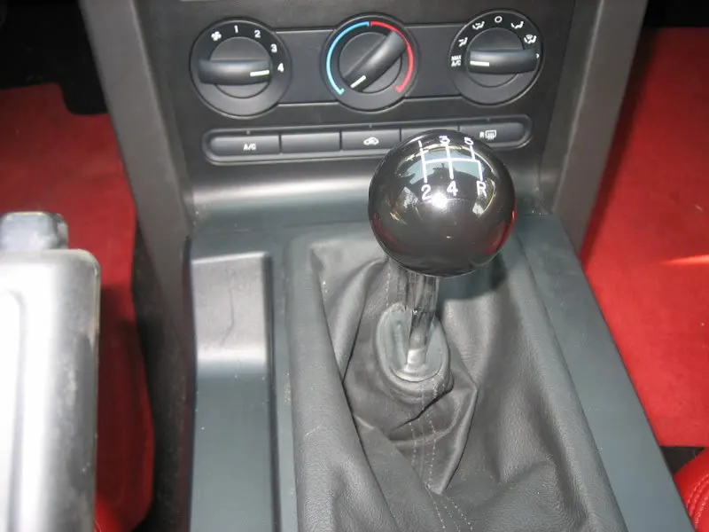

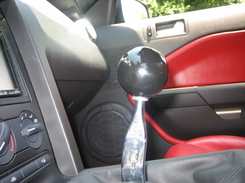

Jul 3, 2008
  • Jul 3, 2008
Pics Up

Nice pictures of the Hurst. I have the white ball on mine and I really like the way it shifts.
