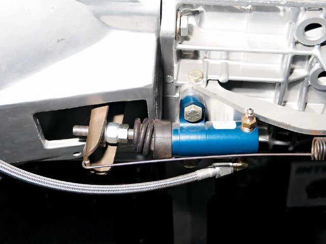

JMC motorsports makes a kit for classic Mustangs with the T-5. It may work ont he fox with some tweaking. I beleive the TC pedal assembly and MC is the correct size so you may be able to use it + The JMC slave cylinder
http://www.mustangmonthly.com/howto/mump_0702_ford_mustang_clutches/hydraulic_brakes.html
