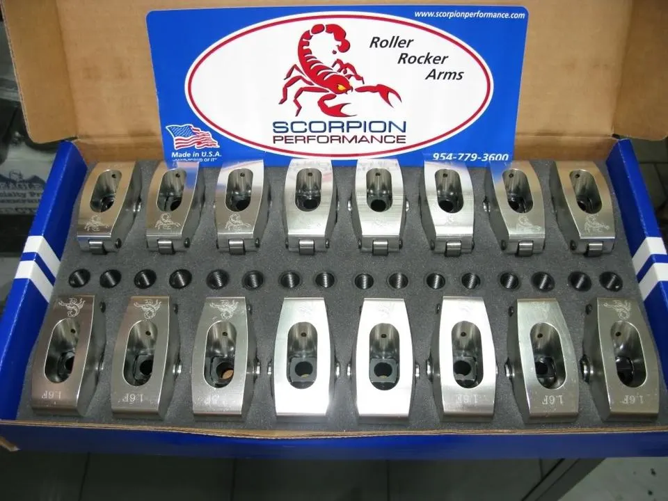

the Crane lifters should come in this week. the shop is taking their sweet time. they are also getting a custom grind cam not higher than 274. i told him about the 303, but seems too much for street. also, Scorpion roller rocker arms are being used (made in the USA - scorpionperformance.com). what's the news on Scorpion products - good/bad?? any feedback is appreciated...
I've heard good and bad about scorpion, but those rockers look pretty sweet. Looks like they can package real nice. My trickflow ones arrived with the rockers and locks in random places in the box.
