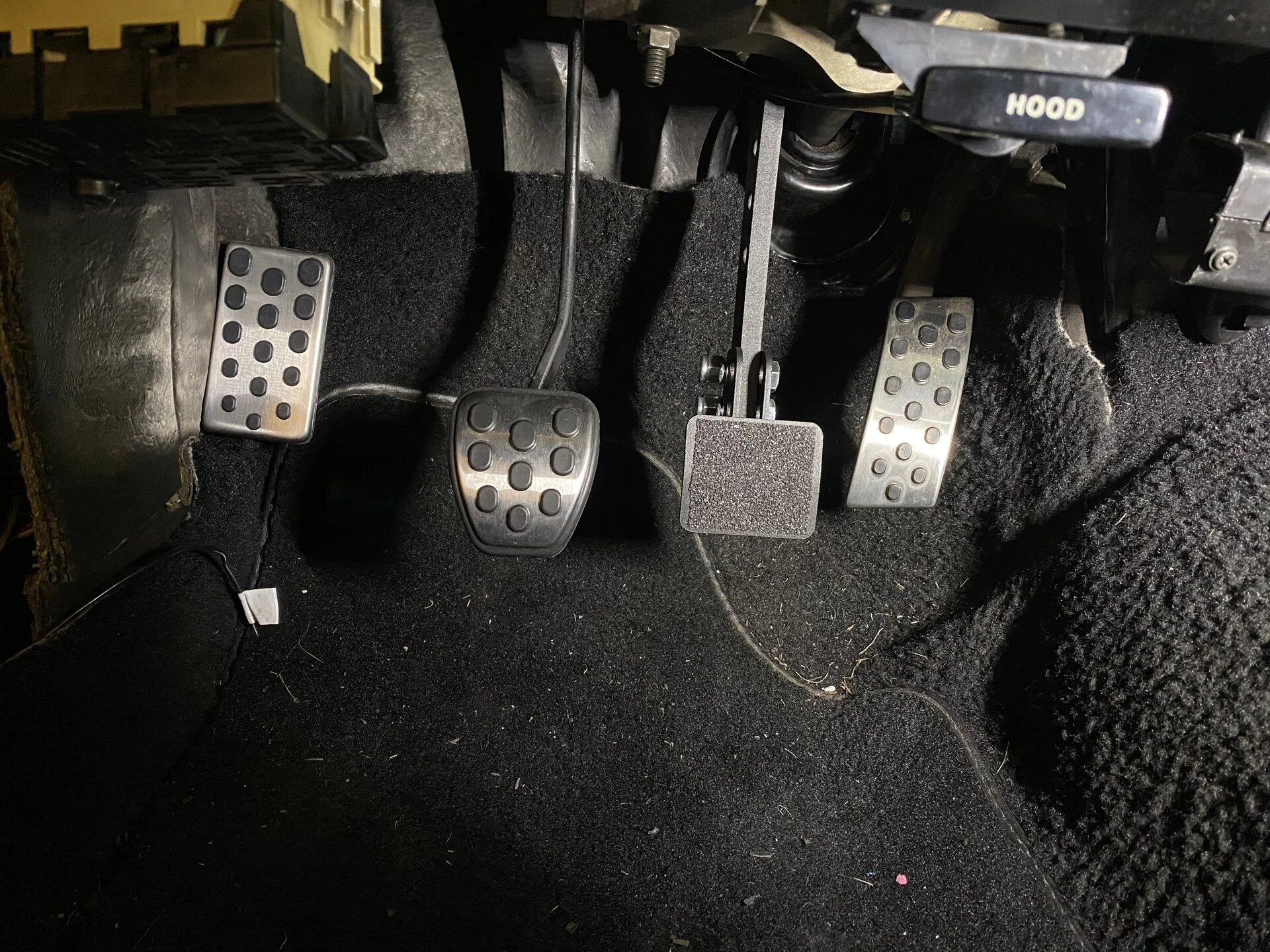

I plan to go with a manual. Right now I'm working on getting the body and suspension done. Saving the engine/ trans for the end. When i get ready to purchase ill keep you in mind if you have them still. Right now im going to buy this 96gt and strip whatever I can use
I'd have a full plan in place before buying an entire car. The hydroboost from the new edge is a little more desirable and easier to obtain should the donor cars one leak, the front calipers on a gt aren't the most attractive and the spindles stick out further (94/95 is most sought after) . The rear is wider eliminating quite a few wheel choices.
You may find that buying and stripping down a 96 may be more money and effort than it's worth.

"Hydroboost from the new edge" years and models please? I'm trying to figure out a parts list. Spindles, hydroboost front and rear calipers. Power steering rack and a rear end. Any thoughts on which years and models I should be looking for to find parts listed above?
New edge is 99-04. It’s the more preferred hydroboost unit for feel and parts availability. The spindkes are the same, front brakes are a little bit better, but the rear axle housing is my really desirable. You want an 86-98 8.8 axle housing. You can swap the rear brakes from the new edge over but you’ll need new axle shafts and offset caliper brackets
I’m in the middle of putting a 99-04 hydroboost on my car

Any thoughts on power steering? Should I get a rack from the new edge also?
The rack won't change anything, it's the supply that's the problem, since all the Coyote cars are electric power steering. There are two options. You can get the power steering pump kit from Power by The Hour, or you can put an electric power steering pump out of a Volvo CX90 in it. Check out the facebook group "Coyote Swapped Foxbodies" for more options.

I would consider the electric power steering. But that all depends on what you are doing with your car. I ran my coyote swap with manual brakes and manual steering for the last year and a half. I hated the manual steering the brakes did not bother me. I am currently swapping to the volvo eps and seems to be pretty easy. You can use factory lines if desired and its only 3 wires to get it running. Key on power, power and ground. Once I get in to it I will update my build thread.
Reactions: General karthief
That's the group I've been getting all my hydroboost install info from.
The forums lack info because it is outdated. The maximum motorsports hydroboost kit is a relatively recent kit, but rather expensive. Prior to that, people were taking pedal boxes and making hybrid boxes by cutting and welding and combining the two to make a sort of Fox/SN95 hydroboost pedal assembly. Plenty of write-ups on how to do it, so it really comes down to a time vs money thing with regards to the MM pedal setup. The only think I don't like about the MM kit is the pedal itself. It's fugly. But, I have an idea on how to fix this later.
Ive actually had a conversation with the people from LMR about changing the high pressure hose over to fit the power steering pump from a F-350 that came equipped with hydroboost. Said pump will bolt up to my factory mounting bracket and adequately supply a hydroboost system. Only issue I have is I don't have a complete hose shop in my little garage/shed and I'm still about a year or so away from dropping the bug block in my car.. Gotta get it ready ya know... So it doesn't necessarily have to be electric or a PBJ system to work, there are other power steering pumps that work, it's just a matter of finding what fits..
