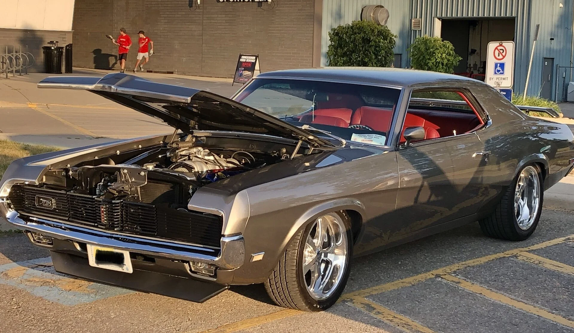

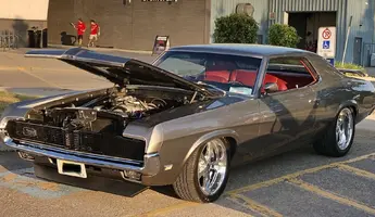

Hi friends, I’m new here, so bare with me. I have just completed building a pro touring 69 cougar with 4.6 DOHC out of a 98 LSC mark 8..
I put a hydroboost from an 01 mustang GT in as space is very limited. My issue is, when I apply the brakes, I get a woosh sound, and under light application of brakes, I also get a pulsation in the brake peddle?? When the car is slowing, I can feel the transmission down shifting. Once the car has come to a complete stop, I feel the peddle jump up and down, ah have the whoosh sound continue, but If I lift my foot to the point the brake peddle is barely applied, sound goes away.

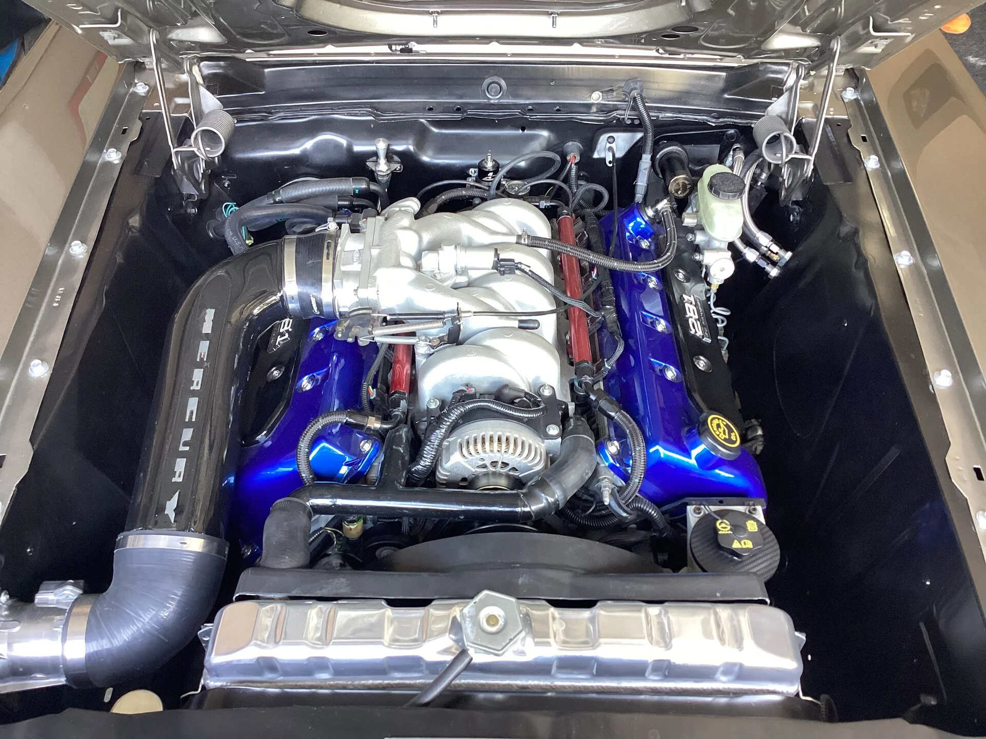

So, I have spent hours bleeding the system, (3 times now). I replaced power steering pump, cause had original LSC pump on motor, and figured I may need to replace with pump from hydroboost car, so replaced with rebuilt pump from 98 cobra. Everything else is new, rack, reservoirs, Lines, everything is dry, no leaks. Hydroboost is only thing not rebuilt or new. Do I need to rebuild, replace, or is it some other cause

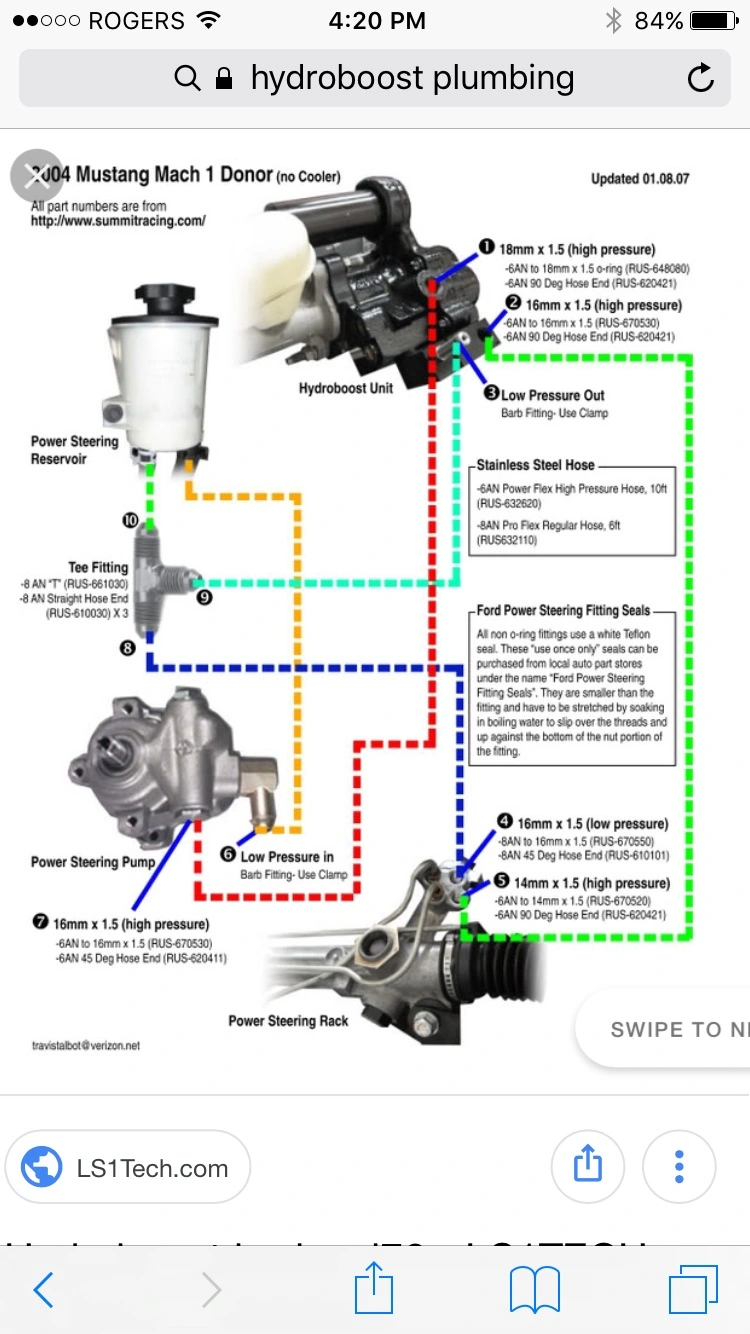

Are you running manual steering? If so how did you route the lines?
I have a power rack. Brand new piece.I will try to load a video in the next day or 2 to see if it can help. Included is how I ran my lines. I here the sound from initial application of applying brakes. Once at a complete stop, with light pressure applied to the pedal I would call a pulsating kick back,buy If I apply more pressure to pedal, the kick back stops, but the sound continues. It is a more distinct whoosh sound.

That sounds like the pump straining against restriction. Can you do the same and have somone press the pedal while you hold a screwdriver on the pump and see if you can feel a vibration in time with the noise. Given that you've replaced the pump, i would see if any of your fittings are undersized and presenting a flow restriction.
