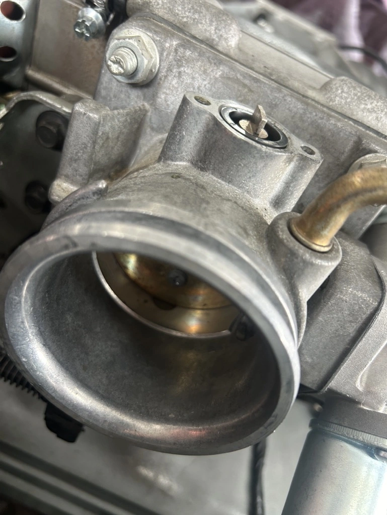

・IAC replaced ・TPS replaced ・MAF sensor replaced

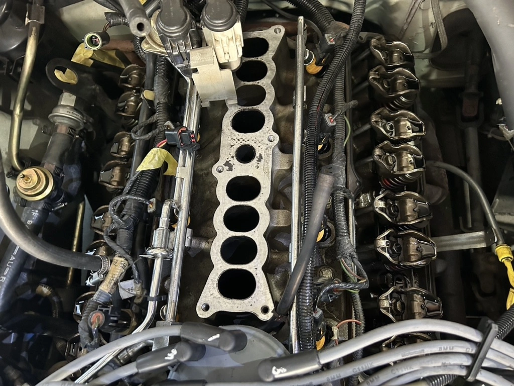

・Injector replaced ・I noticed that push rod number 7 was bent and replaced it, and also checked the movement of valves number 1 to 8.

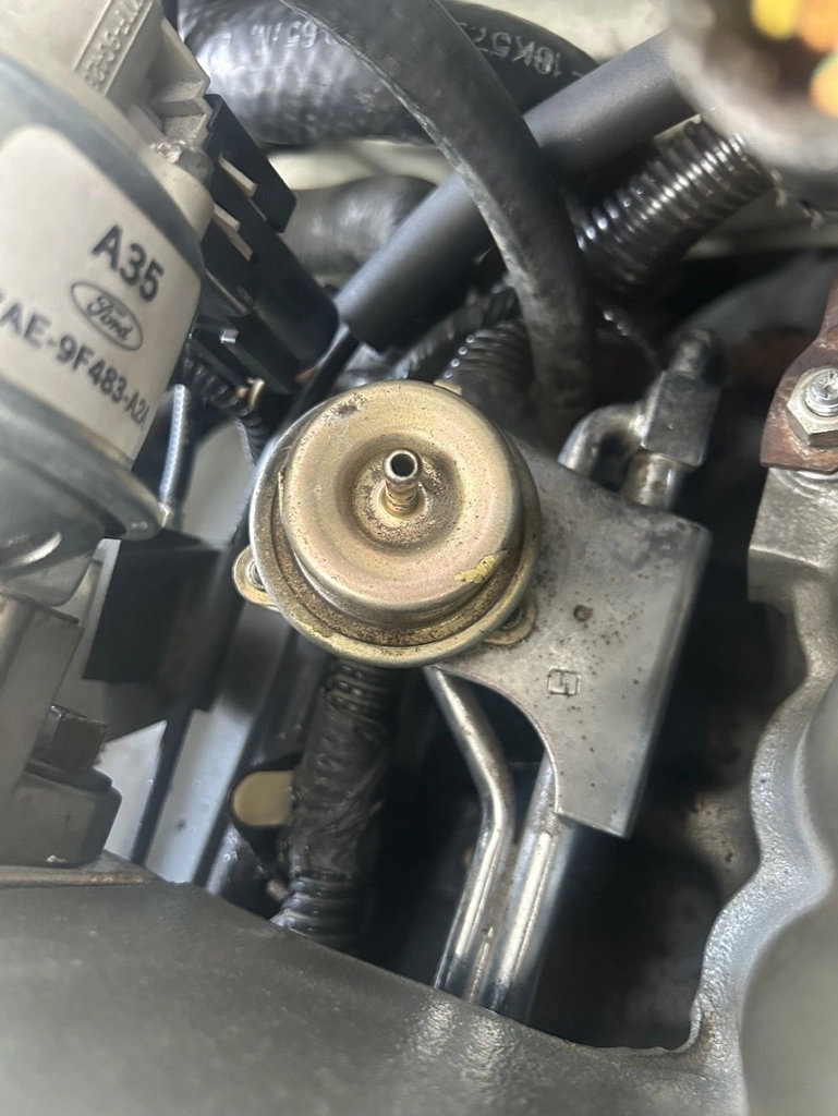

Fuel regulator pressure failure?
However, I don't have a device to measure fuel pressure.

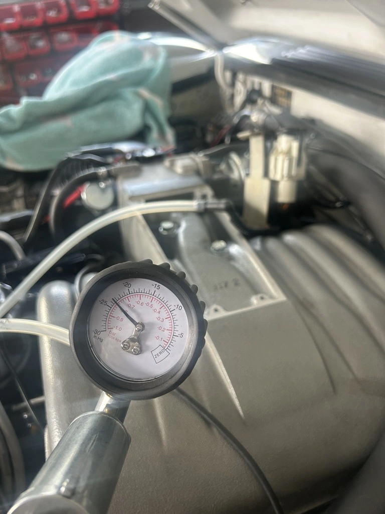

If you remove the brake booster vacuum hose with a tree, the rotation speed will increase. When I put in secondary air, the rotational speed increases, so I feel like I'm using a lot of gasoline. Please help me.

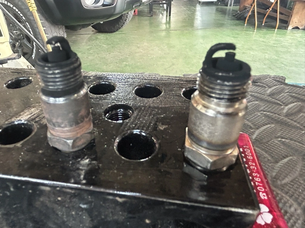

Every time I check the spark plugs, they are all black.
