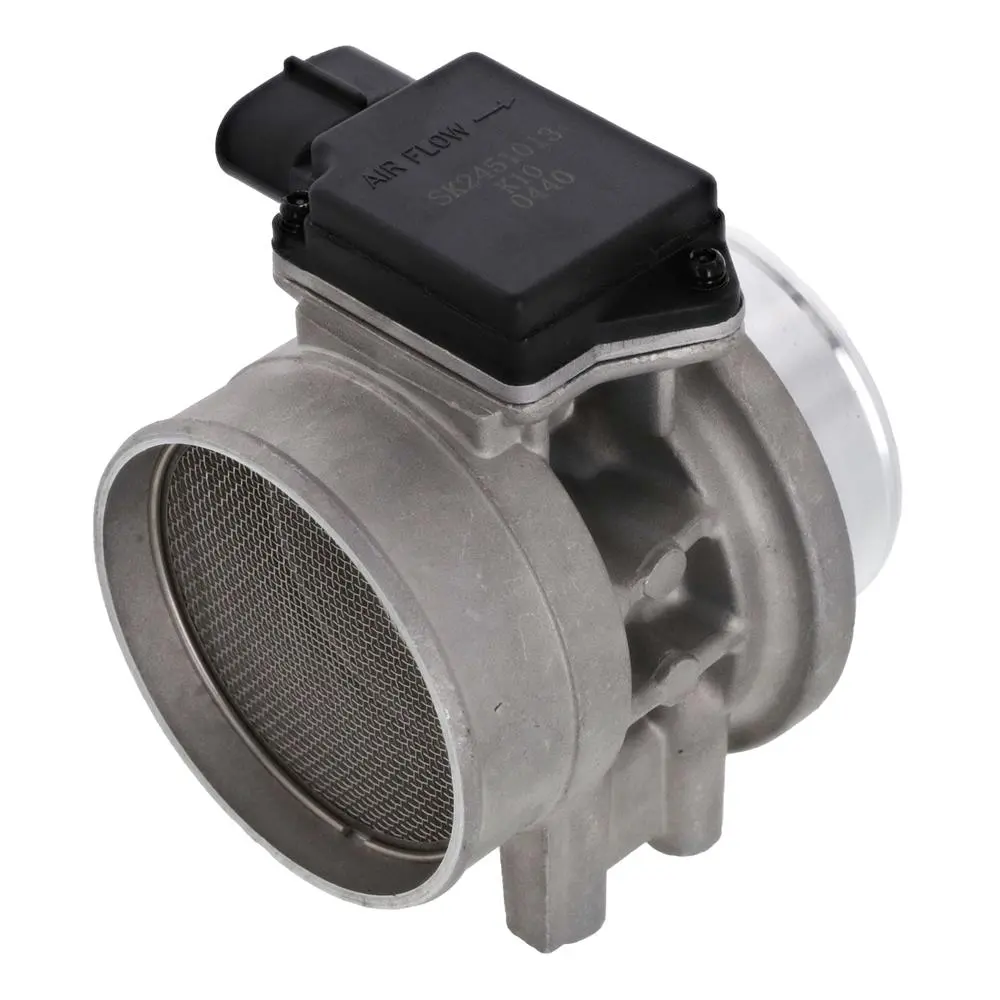

MAF sensor has been replaced. This is a BAP sensor vehicle.You can just see the MAF in the last video the OP posted. With that there should be no vacuum attached to the BAP sensor.
And just to be clear to the OP this is the BAP sensor
This is the MAF sensor
This is a mass air mustang...MAF sensor has been replaced. This is a BAP sensor vehicle.

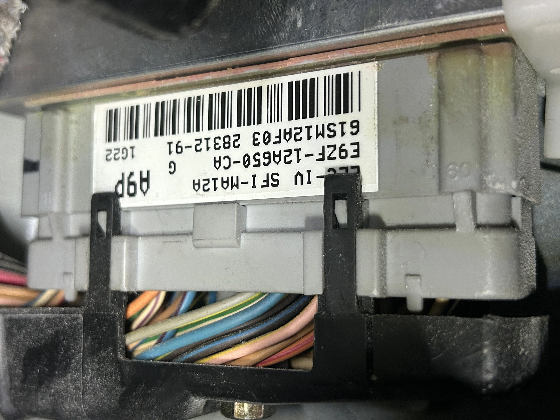

This is a 1991 kit car. Is the ECU tag the part number?Can you get a picture of the data tag on the ECU and post it?
