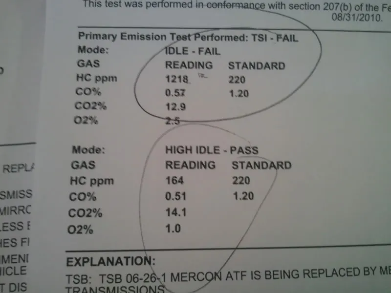

Today's emission test was an abysmal failure. If I run it too rich it failes the HC ppm. If I run it too lean it fails the CO%. I think I'll just have to richen it out, and find better cats.

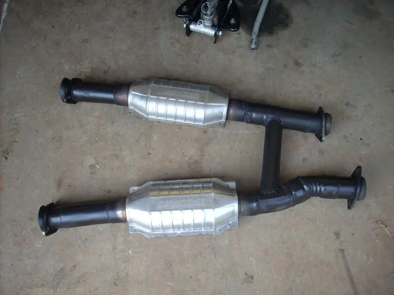

Well, I did a little test work on the engine this week, starting with a compression test. Guess what, one cylinder had 0 compression. I took the valve cover off and found an exhaust valve a hair out of adjustment. Just a stupid stupid mistake to make, especially since I've adjusted valves about 100 times. Re did the test and all cylinders are 150 to 165 psi. I finished up my cat pipe, which I'm pretty proud of, because I had to fab it from scratch without a tube bender or a tubing notcher. All I had was pre bent pieces from the autoparts store. And yes, that is a functional cross over. The cats get wicked hot even without a smog pump. All that 2000 degree black exhaust paint I put on to keep it from rusting flaked off past the cats.

Well, I did a little test work on the engine this week, starting with a compression test. Guess what, one cylinder had 0 compression. I took the valve cover off and found an exhaust valve a hair out of adjustment. Just a stupid stupid mistake to make, especially since I've adjusted valves about 100 times. Re did the test and all cylinders are 150 to 165 psi. I finished up my cat pipe, which I'm pretty proud of, because I had to fab it from scratch without a tube bender. All I had was pre bent pieces from the autoparts store. And yes, that is a functional cross over.

Wish i could pass with ease. Nice looking h pipe though...

I'm guessing they don't run it on the dyno in your state; that's why you're failing. If they ran it up a little on the dyno it would probably pass. Most cars don't run well at idle. What kind of cats are you using? High flows are generally a waste of money. The flow better than standard cats, but not as well as no cats, and yet they don't burn off enough to pass emissions.

Pypes high flow 3''
Im gonna play with the tune at idle and see if i can take care of it that way... Its the fact that im in a low load situation. Ill probably lean it out a bit and add some more spark. This way the exhaust is nice and hot and should warm those cats up.
I am running the Pype's catted X-pipe as well and had trouble passing idle HCs too.
I cranked up my idle to 1000rpm and it squeaked by getting just under the 220 HC reading.
I was also running 1 heat range colder spark plugs than stock at the time.
