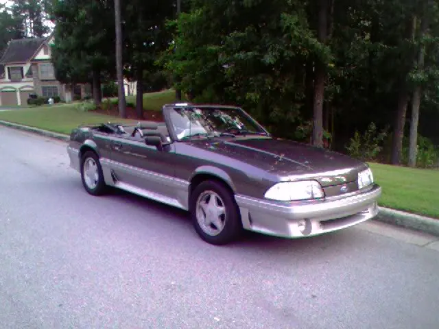

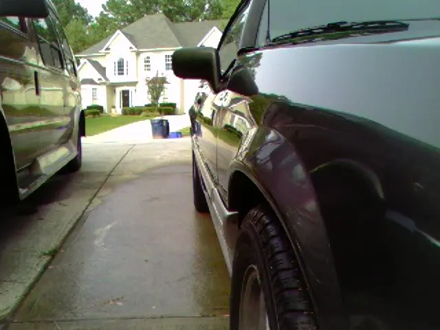

I was bored and its nice out, I went out and decided to go badgeless.
This is what I did.
1. pick up hairdryer
2. realized I had to pee while in the bathroom... so i peed
3. Poured a cup of soapy water
4. Plugged in hairdryer
5. blew for about 3 min and the fender started gettin a lil hot so I figured it was time.

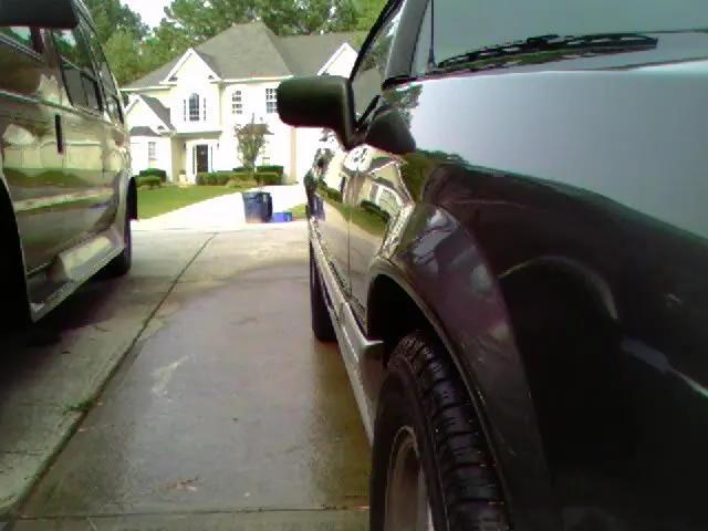

6. took the hand towel I had and just sort of pulled the emblem downwards alittle.
7. it came off quite easily, leaving the double sided tape pieces on the fender
8.peeled off pieces, quite easily
9. remaining glue, I doused with soapy water and just got all of the glue off the fender.
10. washed the car, and took pics.
Ok well all that took about 6 min.s lol.
I think it looks alot cleaner, and its clean!! See
More to come, I found my phone so these are just crappy phone pics.

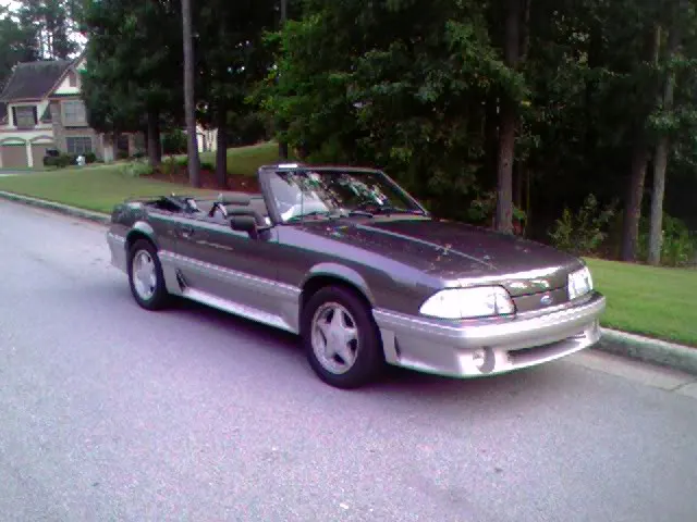

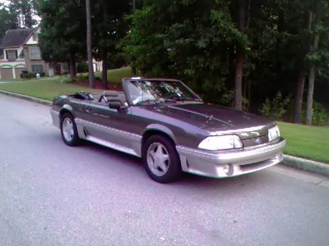

nope just either doublesided tape or glue and it comes off really easy, and it looks a lot cleaner, hangon just a min. the pics are sending. and yess my phone has been lost lol
I am missing one of my 5.0 badges, but i am THINKING about putting my single 5.0 badge on the hatch where my ford badge is missing, and then either leaving it debadged or putting '06 GT badges on the fenders but below the moulding instead...opinions?
ehh... like someone else said" if the person your'e talking to doesn't know its a 5.0 you shouldn't be talking to them. I did this b/c I didn't have one 5.0 badge. I had it but I was afraid to mess up puttin it on so I just took the other one off. If I could find my charger for my old digi cam I would post some pics.
It looks good, heck I pass a mint black vert everyday on the way to school, with no badges, and you can deff. tell its a 5.0, like they said if they dont know its a gt with the gt body panels on it, dont pay them any attention, "Hey is that one of them there 5OHS, Yes, then drive off"
