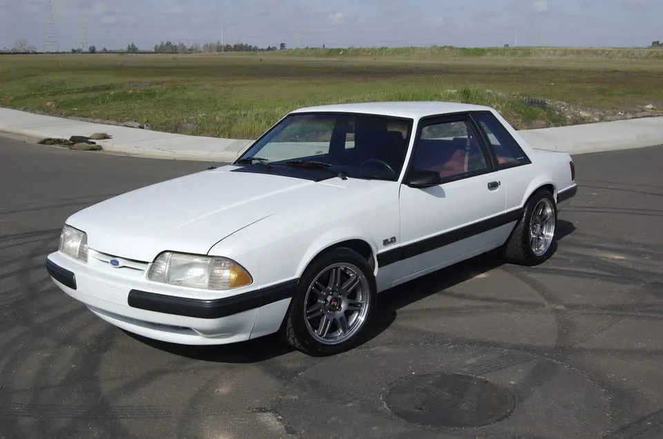

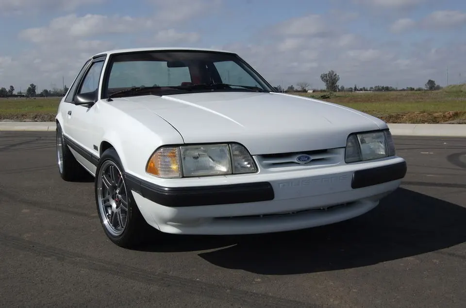

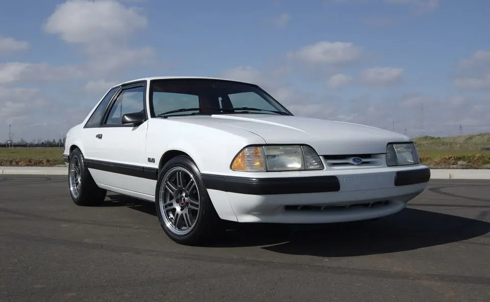

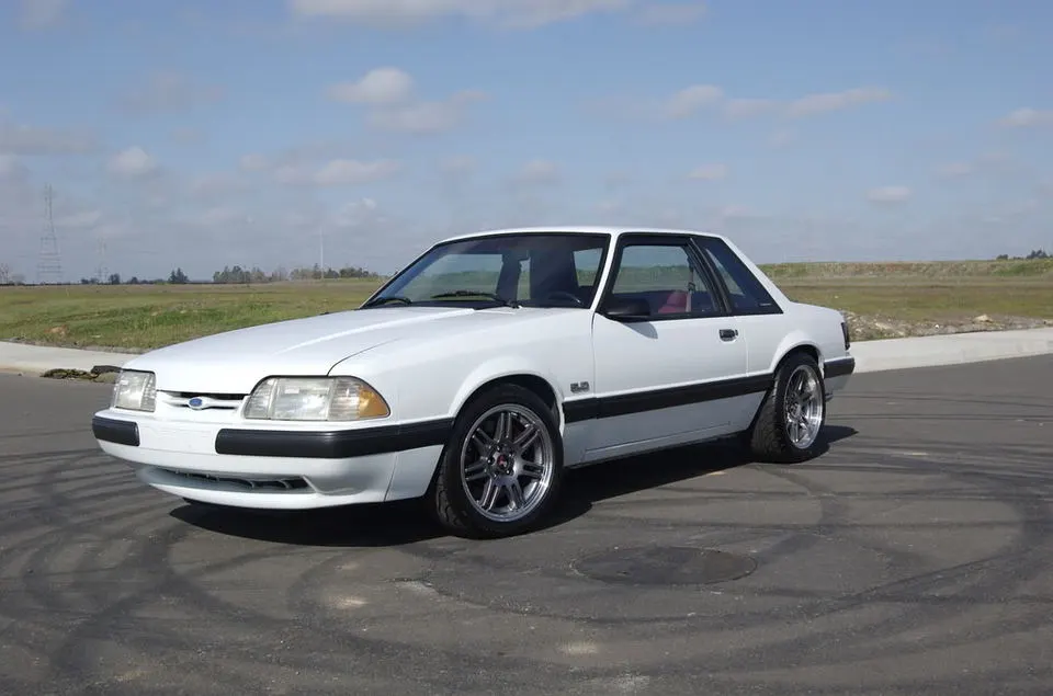

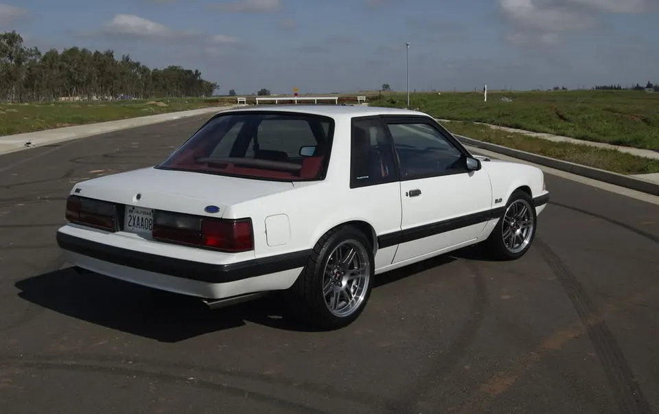

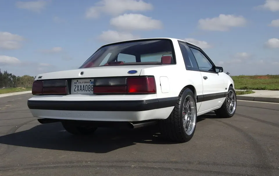

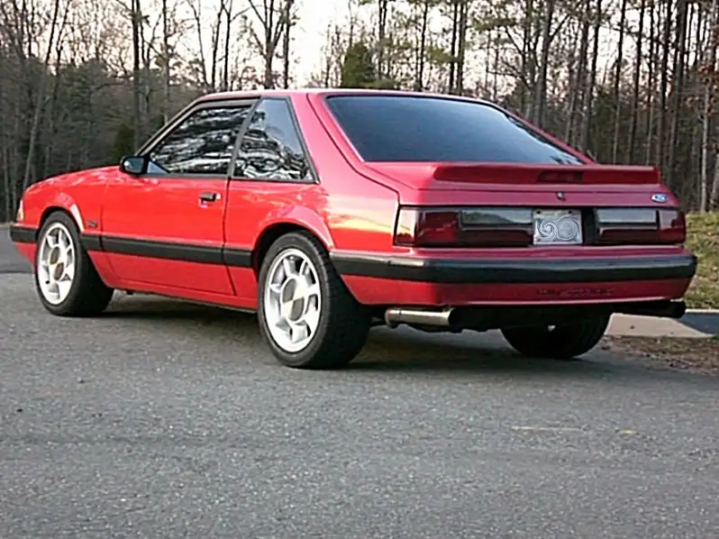

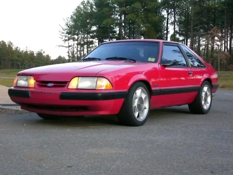

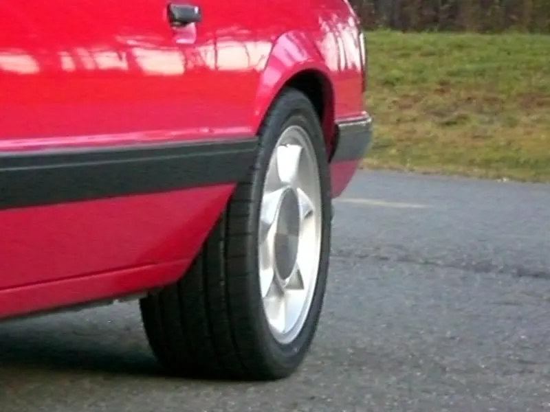

Here is my setup...5 lug 17X9 & 17X10 10th anni reps. The tires are 255/40/17, & 275/40/17. My fronts DO rub at full lock, but its actually the inner lip of the rim rubbing, not the tire... THe rear fenders had to be rolled & the inner fenders beat in a bit.... I am running 95 spindles up front, & ranger axles out back...

That looks really nice... and those are 8.5".
I'd think the same tire size will be just fine for the 8" Ford Racing 95 Cobra's.
