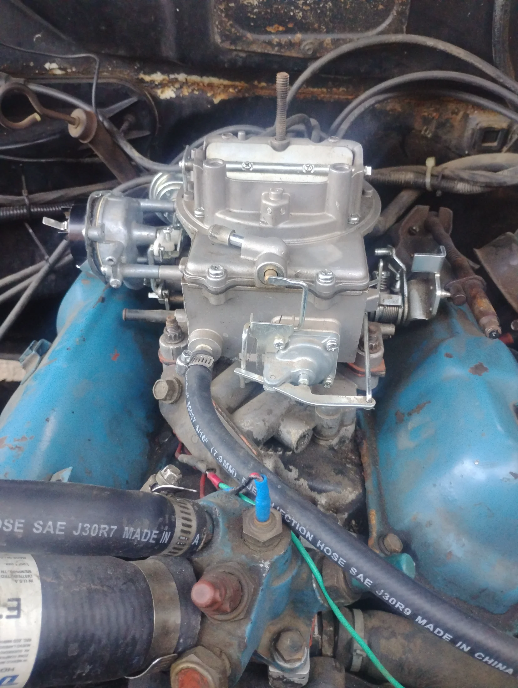

B bd101jc New Member Dec 9, 2025 1 0 1 San Bernardino CA Dec 9, 2025 #1 Dec 9, 2025 #1 How do I adjust my idle? Attachments 17653219372204753912344894930167.webp 317.9 KB · Views: 69

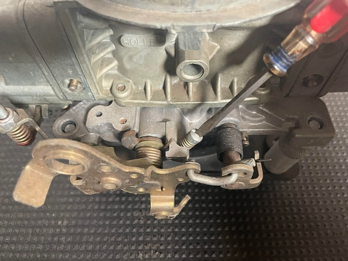

LILCBRA I wish I didn't have all of these balls in the air Mod Dude Dec 6, 2005 6,596 5,618 194 Corn County USA Dec 9, 2025 #3 Dec 9, 2025 #3 Idle is adjusted by a screw that contacts the throttle linkage. (This is a Holley, but they're all similar in this regard.) Be sure to thoroughly check for vacuum leaks as well. High idle is good indication that there is additional air entering the intake tract.
welder4956 20+ Year Stangneter Nov 28, 2003 263 128 53 Birmingham, AL Dec 10, 2025 #4 Dec 10, 2025 #4 Also, your photo shows an electric choke terminal with no wire connected to it. That could be preventing the high idle cam from disengaging. Reactions: LILCBRA

manicmechanic007 5 Year Member Sep 26, 2017 2,562 727 143 Roy, Utah Dec 10, 2025 #7 Dec 10, 2025 #7 There are 2 idle screws on your carb Main idle screw on the drivers side similar to the photo but that is a Holley and not your 2BBL Autolite carb 2nd screw is the fast idle screw under the choke cap on the passenger side of the carb
