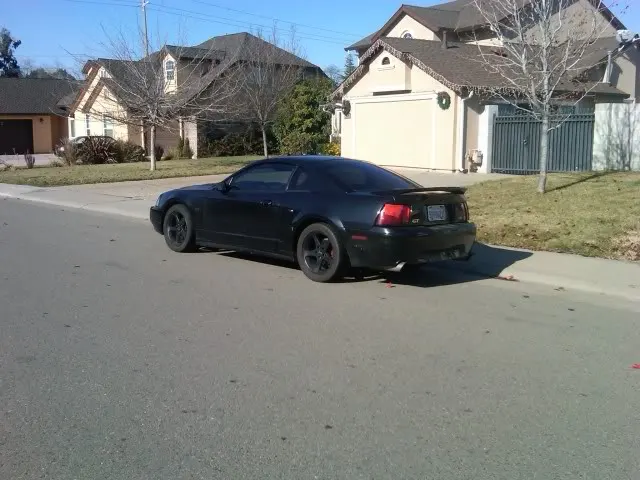

that could have been me then. on tuesday and thursday i leave work in auburn at 12 to go to seirra college in rocklin, then i go to my dads in roseville after school alot of those days so that defenitly could have been me. if it was this black car with a ****ty paint job then is was me haha. its geting sprayed kirker "Hot rod black" satin black sometime this month. so it will be dark and evil looking rather than the half shiny half flat its got goin for it right now.

Yup, that was you. :nice: Can't wait to see how it's gonna look with the new paint job!
