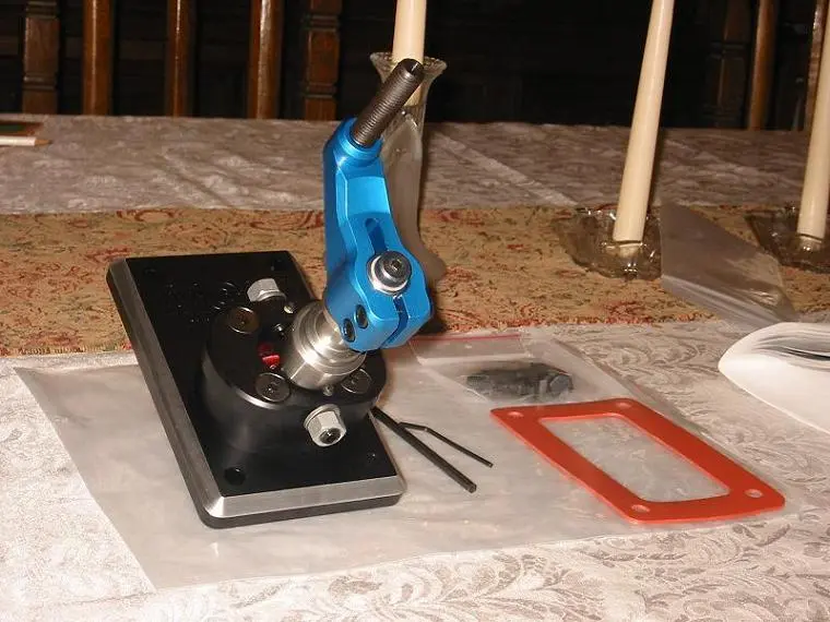

i recived my shifter today....lol that was the shortest two weeks ever ...only took em 3 days....the shifter was packed pretty good...took me 20 mins to open it ..lol i opened it up and went directly to the cool blue handle..... and i notice its different from what i saw in the picture.. there was no spanner nut or washer.....just two clamps ...like kind of clamps you find on freestyle bike seat post....i was a lil confused so i gave mgw a call....the nice lady who takes the orders put george on the phone in like 2 seconds....he explained to me that i have an upgraded version..that a few people had problems with the spanner nut and locking washer...nothing major...they just complained that it was taking too long to adjust the handle and to lock the nut to prevent it from moving ....i guess they were to axious to install the shifter :rlaugh: but anyway he also added a feature to prevent the shift stops from moving after you set the stops on the shifter you install a lock washer and a nut on the outside of the shifter base...which is also in the kit ......
check out the picture below

whoa, that's quite a bit different from the original model. Not only is the handle different, but the base is beveled to help out with fitment problems the 87+ guys were having, and the stops are different also. I think i woulda felt better about the spanner nut handle. I guess i'll find out when i get home and check mine out, hehehe. Congrats!!!

Looking at the pics - I'm not altogether certain the shorter handle (red or blue) actually shortens the throw. I believe it simply positions the handle in a different location. Shortening or lengthening the throw would require different ratios of length between the parts of the shifter above and below the pivot points - just like a rocker arm. I think.

Speeds - maybe George can pipe up and confirm, but throw is a function of the piece the red/blue parts bolt to. All the red/blue part does is give you some control over WHERE you place the shifter handle/knob - not how long the throw is. It will affect your REACH to the shifter, but it won't affect throw. Throw is the distance the shift knob travels between each gear - and that remains the same whether the red or blue handle is used. You just start and end each shift in a different location depending on which handle is used. Not to confuse the issue - I'm pretty certain the shifter design reduces throw compared to the stock shifter. But that's a function of bolting in the new shifter mechanism - not which handle you put on the new mechanism.

actually you both are right :D
the handles will change the "ARC" distance of the shifts because the higher up you go the larger the radius of the arc. imagine if the stick shift were say 10 feet long. even though the shifter linkage did not change the actual distance the knob up top goes could be as much as 4 feet :shock:
but what alot of people fail to realize is that just shortening the handle does not really change the actual shifter throw since that can only be changed by moving the pivot point. i have actually found that some aftermaket shifters are in fact only a hair shorter in actual throw but offer a super stubby handle to make it "FEEL" shorter than it is.
our shifter can stay up rather tall and still give a short throw becuase we dratically change the pivot point.
also about the red and blue handles. if the red handle were simply longer or farther back to the driver than yes it would have ZERO impact on shift throw. BUT it is also taller so that does change the "ARC" throw of the shifter by a little so the red handle does FEEL longer throw for this reason only.
hope this helps
george
