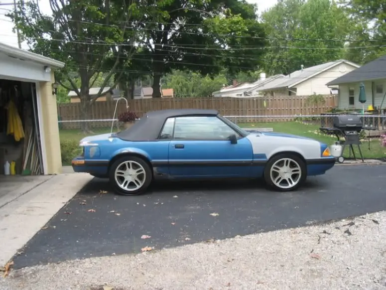

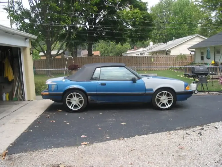

i did a quick chop...with bullets and split 5's...i realllllllly like the split 5's...
Is that my rim too? lol if you go with the exact scheme as me I swear I'll drive up there and spray paint them bitches yellow :rlaugh:
