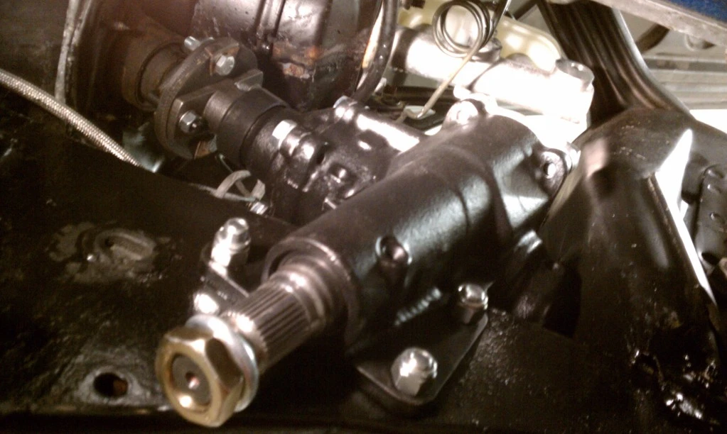

I just installed this system in my 68 last weekend. I used a larger hammer to shorten the collumn. I found that the column needs to be almost fully colopsed to get the Borgeson box to fit, which I am not to fond of. Anyway here is a picture of the collopsed column with the box installed. BTW what power steering pump are you using. I used the CII pump found on 80's-90's Fords, I had to have the pressure power steering hose modified to get a clean install. Let me know if you have any other questions.
