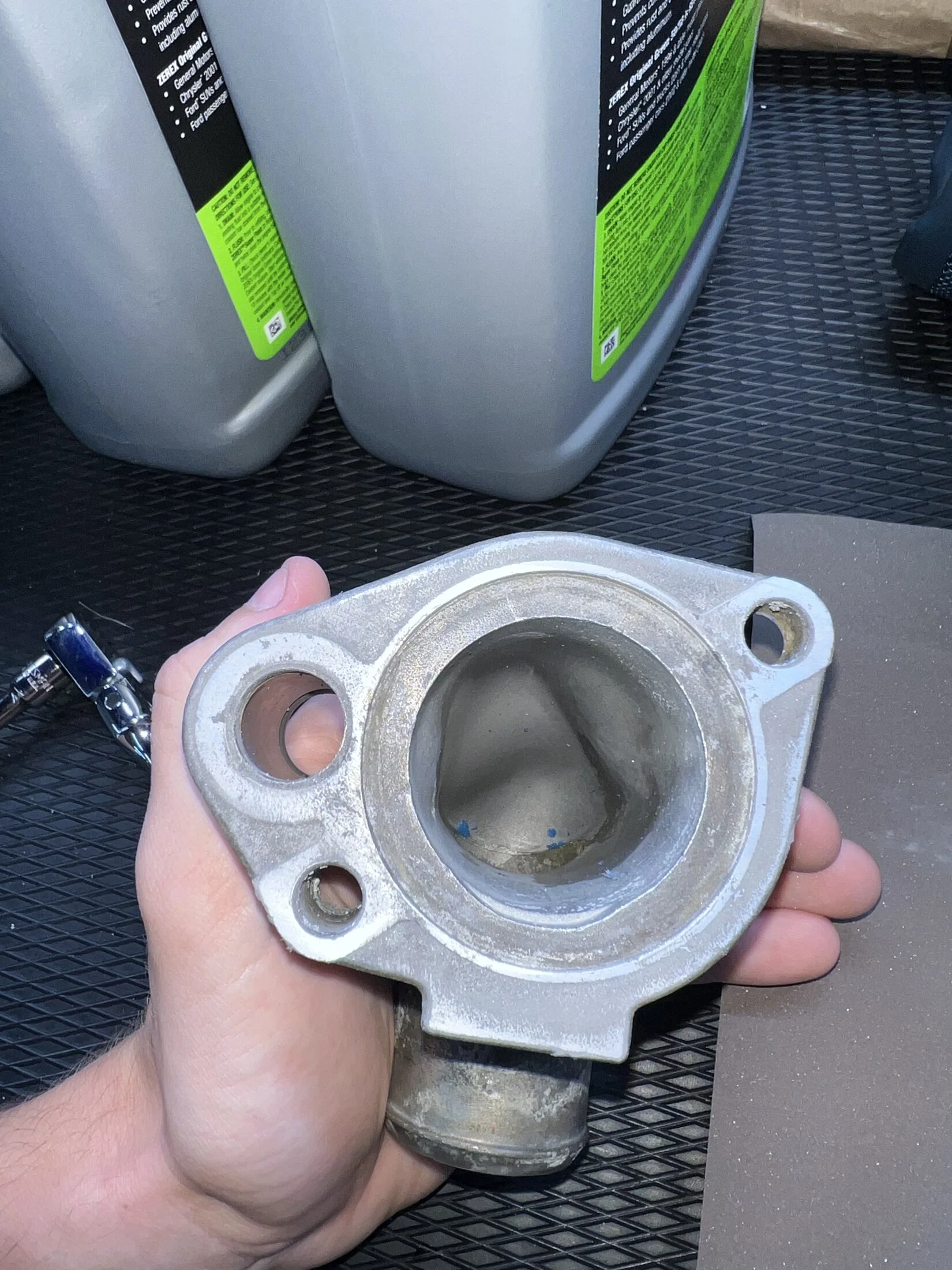

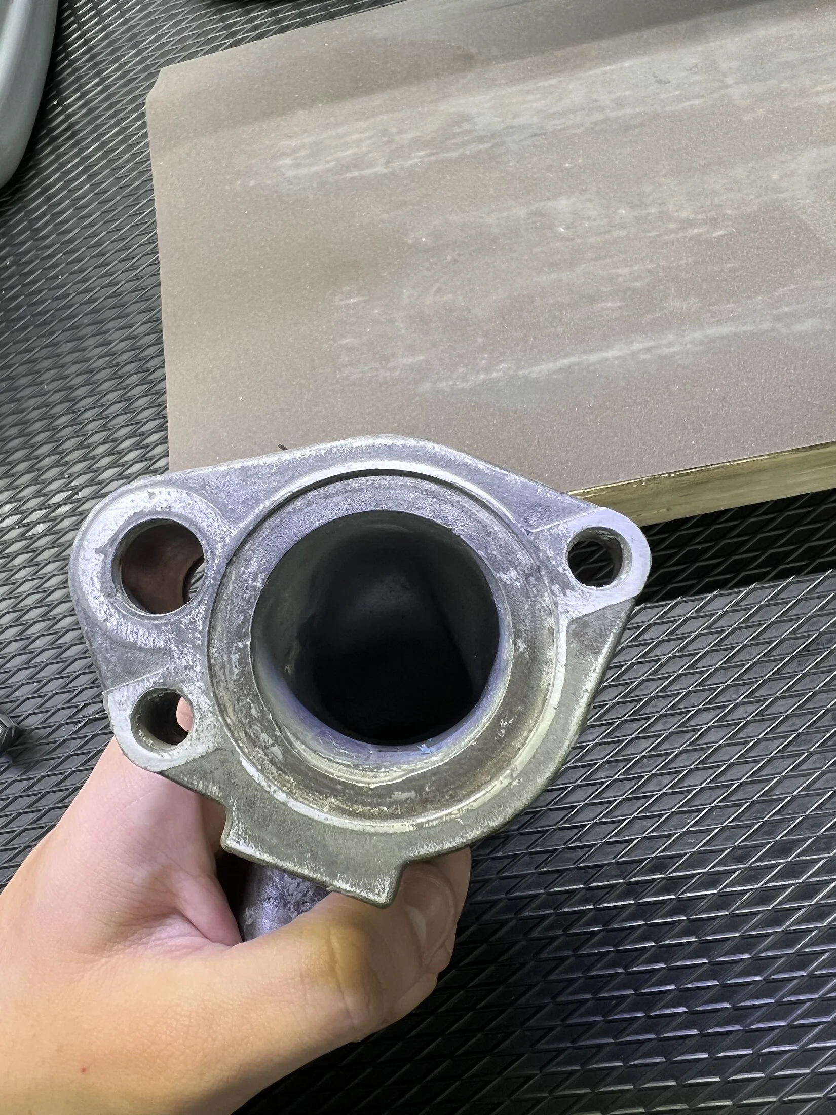

Just did the sandpaper test. The housing shined up on all the holes and slightly around the Tstat. See the pic below. Lmk if that needs replacing. I’d assume the whole thing should’ve shined?

This pitting here would worry me.
I've tried to repair manifolds and such with this sort of pitting with a little JB weld to fill the holes. Wait until it's almost hardened to sand it down to form it to shape, and then let it harden and finish it up. Have been successful.
When i doubt, replace it
