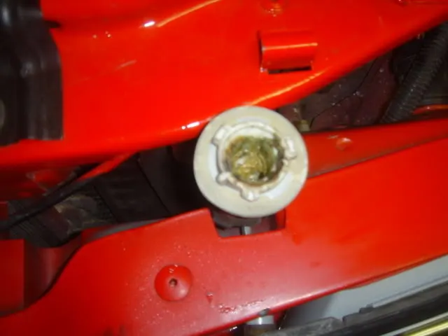

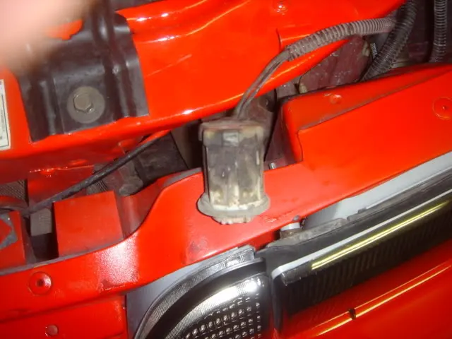

So since one of the uses for that fuse includes "turn signals", I began taking all of the bulbs out of the tail lights.. They all looked fine. After, I took the headlight and sidemarker bulbs out.. This is what I found:
There was grease all over the outside of both, and what looked like grease as well on the inside. I took the bulbs out and put in another fuse, thinking maybe it will work now with them out, but nope.. It just sparked in my face again, lol.. So looks like I have to replace these, and hopefully my problems will be solved.

Try cleaning out the grease with break or carb clean. Let it all dry and put the bulbs back in. Normally they use dielectric grease in sockets. I dont know if that is what your grease is. I would clean it out and see if the grease is causing the short.
