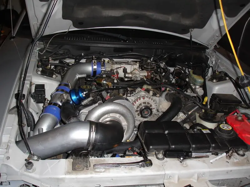

As far as popping pipes off...YES! What I did was buy pipes with flared ends, then on the pieces I had to cut to fit I used some pliers and rolled the end of the pipe out to a conical shape.

post up some pics of your couplers. they sell some really crappy ones with most IC piping kits. make sure you have some good couplers and get some beads welded on the ends of all the pipes. it should cost less than $50 for all the welding.

here is another picture of the setup. I think they are pretty good couplers, they are multilayer and you can see they fiber inbetween the layers....
