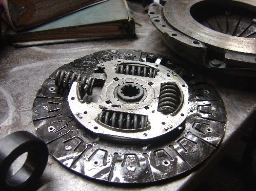

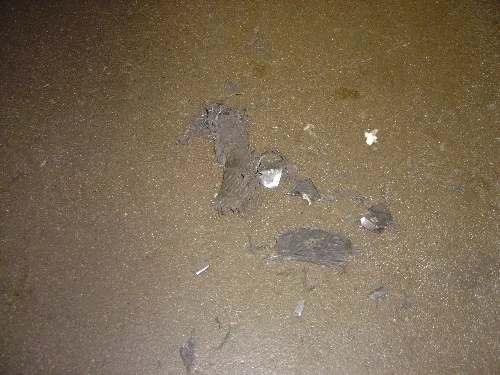

We jacked the car up to take took a look when I got to the shop. We discovered a hole in the bell housing where something left at a very high rate of speed. The guy that runs the shop (Jeff) said he believes the clutch exploded and blew something out that new hole I have in my bell housing. This wasn’t what I was expecting to find.

The Diagnosis:
The clutch did explode inside the bell housing just as I feared. The apparent cause of the failure was a spring that let loose and then proceeded to tear the clutch to pieces. It seems that the spring was starting to come undone when I was noticing the pedal stiffening up prior to it completely letting go. The Service tech I spoke with said the only part they needed to replace was the clutch so they ordered one today and he expects it to be in his hands (and hopefully in my car) in a few days. I asked if there was any other damage to the transmission. He said there didn’t appear to be any other damage.

Pictures of the carnage
Here are some pictures of the damage.
