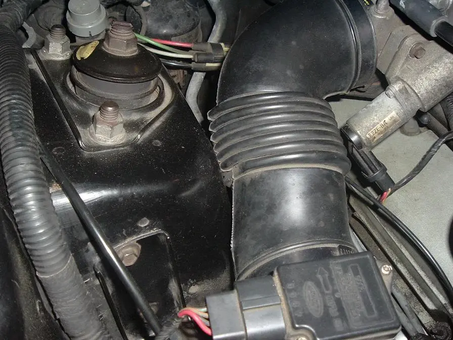

Hey guys I just realized tonight that my frame is most likely bent. I just installed a pro5.0 shifter when in 5th or reverse, it presses aganist the console. My intake also rubs aganist the right shock tower which I know it shouldnt.
I was in an accident about 2 years ago, I hit a telephone pole, and the front left tire took all the hit, I took it to a body shop and they said they had to replace the spindle, strut, lower control arm and engine cradle. I thought it was all fixed, but it seems now that its not.
How much does it cost to unbend a frame?, and am I right, is my frame bent? Heres a pic of my intake hitting the shock tower.
This was before the accident, I belive. Look closely at the intake tube.

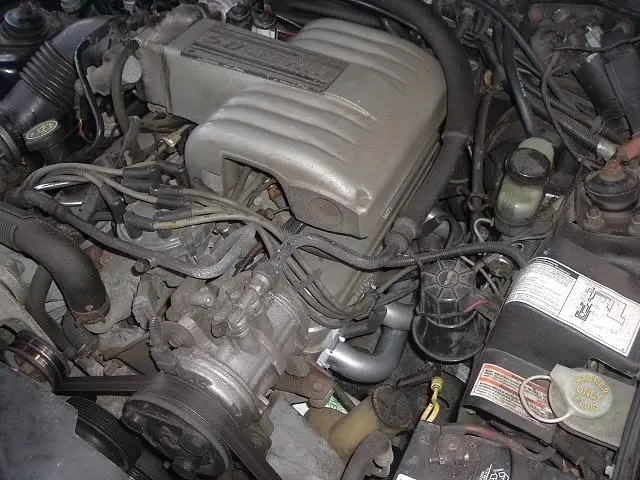

And this was just recently.

couldn't tell you about cost on frame straighten, but a buddy did have one done on a full frame pickup for a couple hundred. Did you check the motor mounts and make sure the k member was installed correctly?
Well the k member is what they called the engine cradle. Needs to be measured when put in to make sure everything is square. Think of it this way. Your k member is installed 1/4 inch out in the front. By the time it gets to where your shifter is in the tranny how far out will that be. If you get the car up on jackstands you can measure from equal points on the frame under the car and determine if it out of whack(so to speak) I would not doubt if possibly it is a frame issue but you may as well find out what you can for yourself before you pay THE MAN to do the same thing. Check all the mounts, making sure all bolts are secure and that your motor mount bushings are not squished out. Convertible mounts are a popular upgrade.
How is the alignment on the car? Wearing out tires?
You can tel its real dirty, a little wd-40 might fix that. As far as the frame being bent if it does not pull to the left or right when you launch i would not worry about it, Unless you plan to road race it. Take it to your local body shop and have them check it out they can tell you in a few minnutes, if it bent and how much.
First... Take your car to an alingment shop and have them check to see that all four of your wheels are still in line with each other. This should tell you if your frame is bent.
Second, my car has the elbow rubbing the shock tower so I don't think you need to worry too much about that.
my car is a salvaged car and it is exactly the same way, the guy that had it before put a cold air intake and bent the strut tower in to make the pipe fit and it still hits, i changed the engine mount and trany mounts but its the same. i bought a new xpipe i can install because it rubs because of this. i also need to get it sraightened. oh and my tires get worn out on the outside but that could be from it beign lowered
